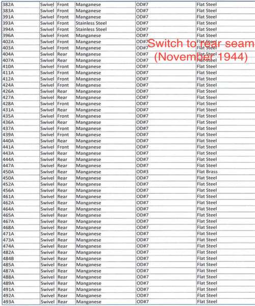

Grant G. Posted December 23, 2014 #1 Posted December 23, 2014 ADMIN NOTE: after discussing this with Grant, he has informed me that the chart is still a work in progress. I am pinning it as a reference but, all should be aware that it is not a perfect chart. Scott (Bugme) Schlueter produced 2,000,000 steel shells during WWII and I feel as though I have looked at every single one the past few days. Below, in the attached images, are my findings regarding Schlueter produced helmets, their lot numbers, loop variation, seam placement, rim construction, and chinstrap configuration. I have filled in with red text the common dates attributed to characteristic changes such as, the transition from front to rear seam, fixed loops to swivel loops, etc. As for lot 199A, this lot precedes December 1943 due to its participation in a metallurgical examination that took place at that time. This chart is by no means set in stone; it is definitely possible that their are helmets out there that would alter transition dates, however I can assure you that the helmets below were included with much scrutiny. If a configuration seemed suspect, I would not add it without seeing photos. If I was unable to tell whether the straps were OD#3 or just really faded OD#7 it didn't get included. I made no assumptions regarding lot numbers, if it was not perfectly clear it did not get added. That being said, if you have a helmet that meets the criteria and is not already on the chart, please by all means post your findings. To keep the thread clean please do not post duplicates. If anyone would like the chart in Microsoft Excel format feel free to email me at Circa1941@gmail.com and I will gladly send you over a file so you can update it as you wish. Thank you to everyone for your contributions in making this chart possible and happy holidays!

aef1917 Posted December 24, 2014 #7 Posted December 24, 2014 Nice job. Some quick arithmetic suggests that there were roughly 3,500 blanks per lot if your last recorded lot number is close to the end.
Grant G. Posted December 24, 2014 Author #8 Posted December 24, 2014 Nice job. Some quick arithmetic suggests that there were roughly 3,500 blanks per lot if your last recorded lot number is close to the end. Thank you, I do know Schlueter didn't really get into a rhythm until 1944 when they made 1,398,995 helmets out of their total 2 million. So it most likely wasn't an even distribution of helmets per lot; the 1944 lots were probably much larger.
aef1917 Posted December 24, 2014 #9 Posted December 24, 2014 I suspect the size of the lots of blanks from Sharon Steel remained fairly constant. Each Schlueter lot number corresponds to a single heat from Sharon Steel.

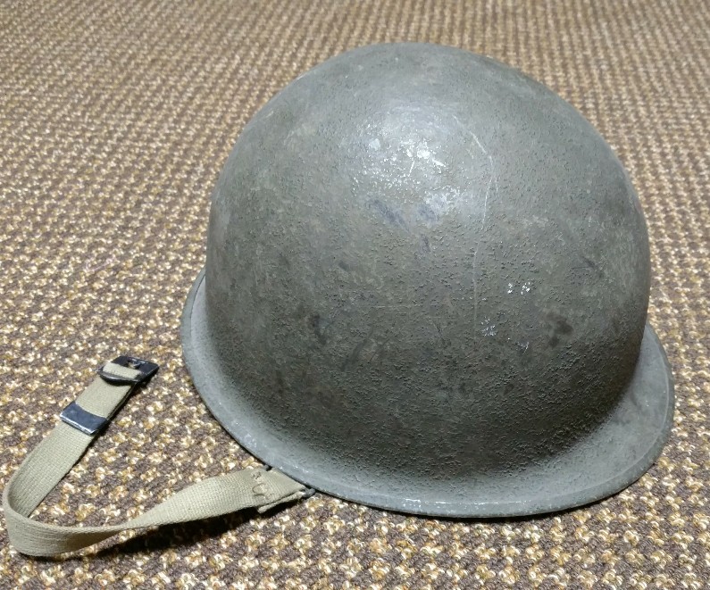

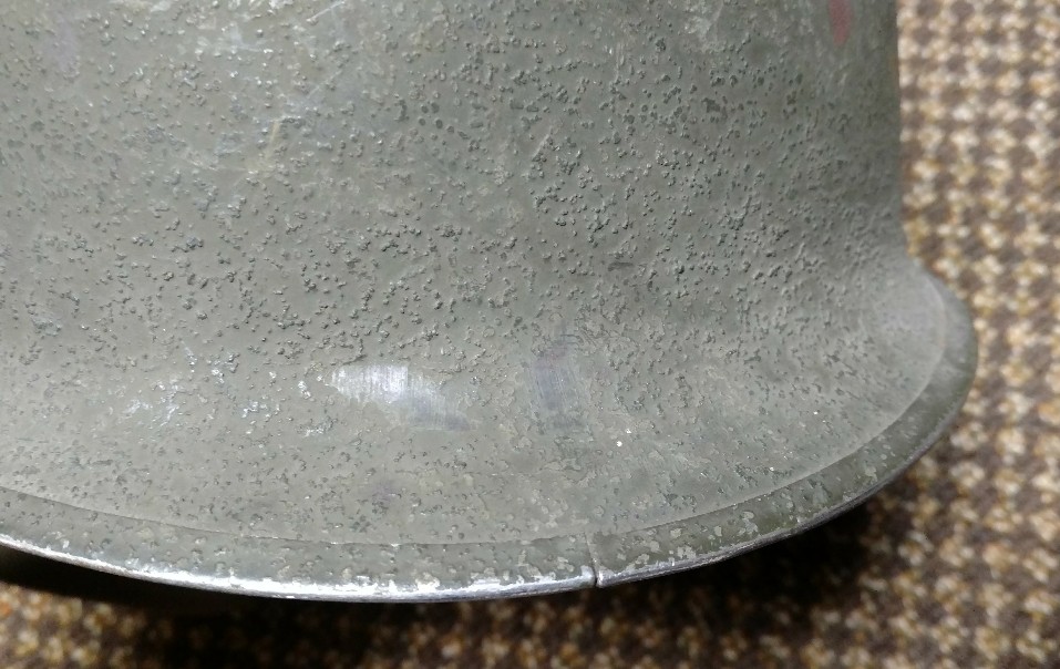

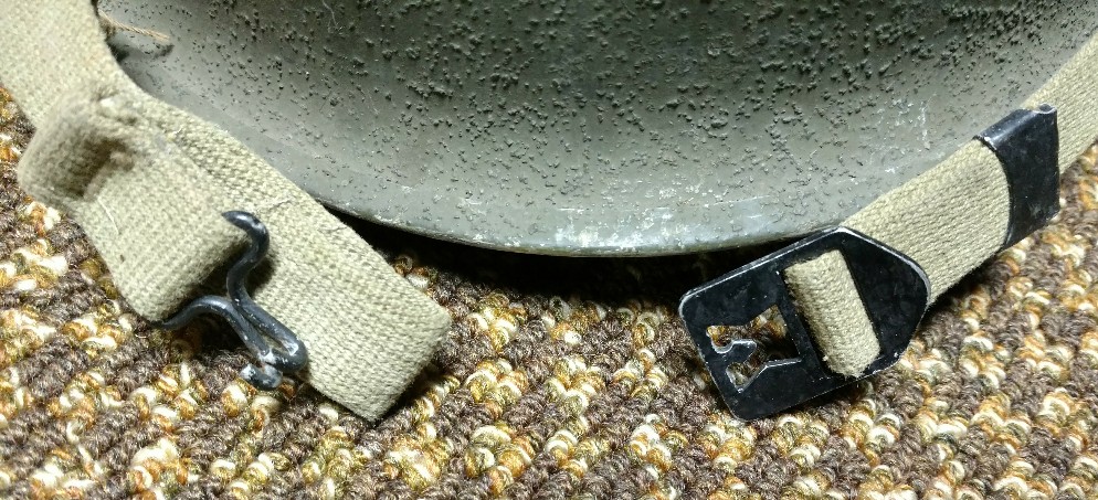

Adg105200 Posted May 11, 2018 #13 Posted May 11, 2018 Great reference! Out of the 4 Schlueter shells I have, only one has the straps. It is lot 323A, which has OD#3 straps, flat steel buckles, and LOOKS to be a stainless rim (is it possible to have different rims within a lot?). Anyone else have any variations from the above chart? Andrew
Grant G. Posted May 11, 2018 Author #14 Posted May 11, 2018 Great reference! Out of the 4 Schlueter shells I have, only one has the straps. It is lot 323A, which has OD#3 straps, flat steel buckles, and LOOKS to be a stainless rim (is it possible to have different rims within a lot?). Andrew, there are a couple other examples around the 320 mark in which both manganese and stainless steel was used as rim material within the same lot number. This was likely a transitional period for Schlueter, using up old stock while introducing the new. Thanks to Bugme for pinning this topic! For those who have examples not detailed on the chart, please send me photos!
Adg105200 Posted May 11, 2018 #15 Posted May 11, 2018 I will check my other shells and post a few pictures later tonight or tomorrow. Andrew
Adg105200 Posted May 12, 2018 #16 Posted May 12, 2018 Here are a few photos of my Schlueter 323A shell. Andrew
Adg105200 Posted May 12, 2018 #18 Posted May 12, 2018 Pic #3 If you also need a picture of the lot # I could try. It is a light strike and a bit difficult to see, especially with a camera. I also have other Schlueter shells, but none with straps. #s 408A: manganese rim, front seam, swivel bail. And # 387A: manganese rim, front seam, swivel bail. And a # 375A which matches the chart. I did however refinish at least one, and I believe the other has a Korean era dark OD with sand texture. Andrew

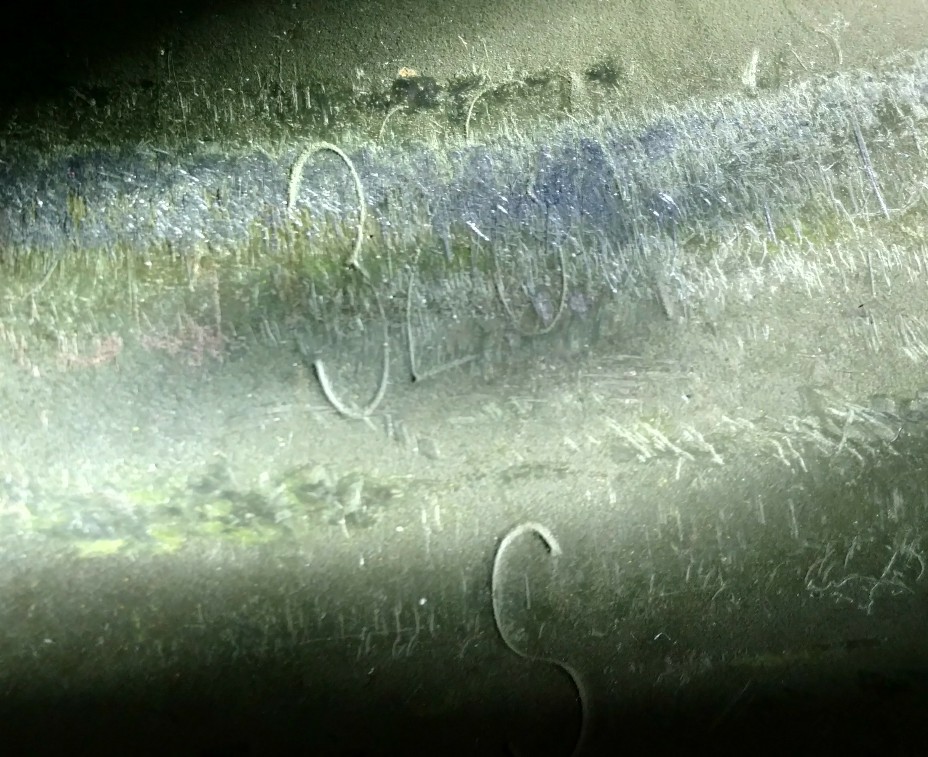

Bugme Posted May 15, 2018 #19 Posted May 15, 2018 Pic #3 IMG_20180512_133323-994x453.jpg If you also need a picture of the lot # I could try. It is a light strike and a bit difficult to see, especially with a camera. I also have other Schlueter shells, but none with straps. #s 408A: manganese rim, front seam, swivel bail. And # 387A: manganese rim, front seam, swivel bail. And a # 375A which matches the chart. I did however refinish at least one, and I believe the other has a Korean era dark OD with sand texture. Andrew Actually the Lot number is what is most needed and a photo offers proof. To everyone, post the Lot number and include the Schlueter "S" in your photo's. Thanks!
Adg105200 Posted May 15, 2018 #20 Posted May 15, 2018 Here we go. A bit difficult to see, but not too bad. Andrew
