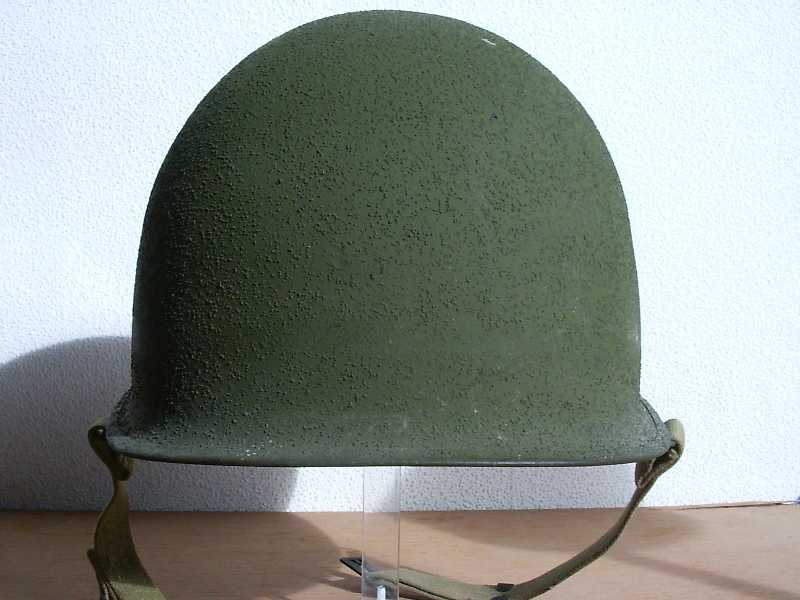

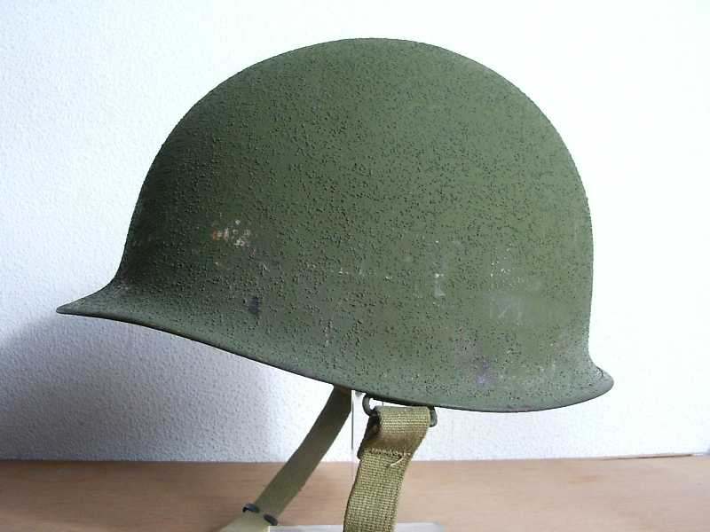

All looked like this one:
Screamingeagles101
Hold my beer... :lol:
{style_image_url}/attachicon.gif fashion e.d. 016.jpg
{style_image_url}/attachicon.gif 00010.jpg
{style_image_url}/attachicon.gif 00017.jpg
{style_image_url}/attachicon.gif 00014.jpg
{style_image_url}/attachicon.gif 00011.jpg
hahaha
Very nice!
However, mine are all fixed bales ;)

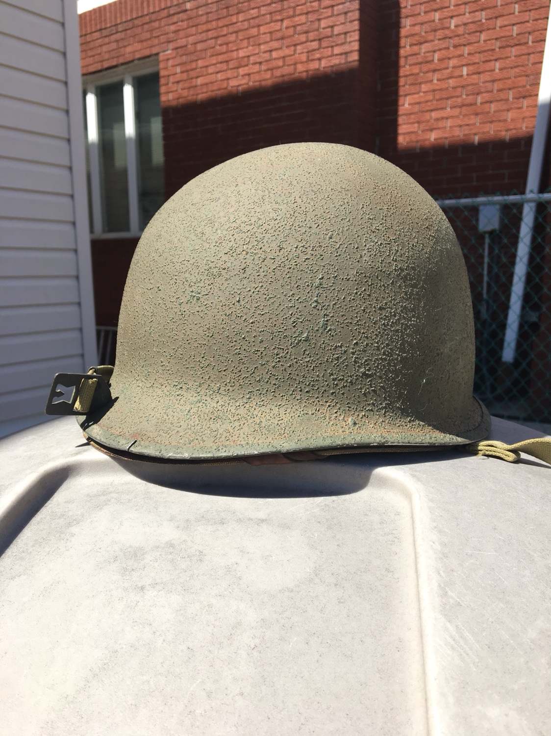

Here’s another
Posted Image

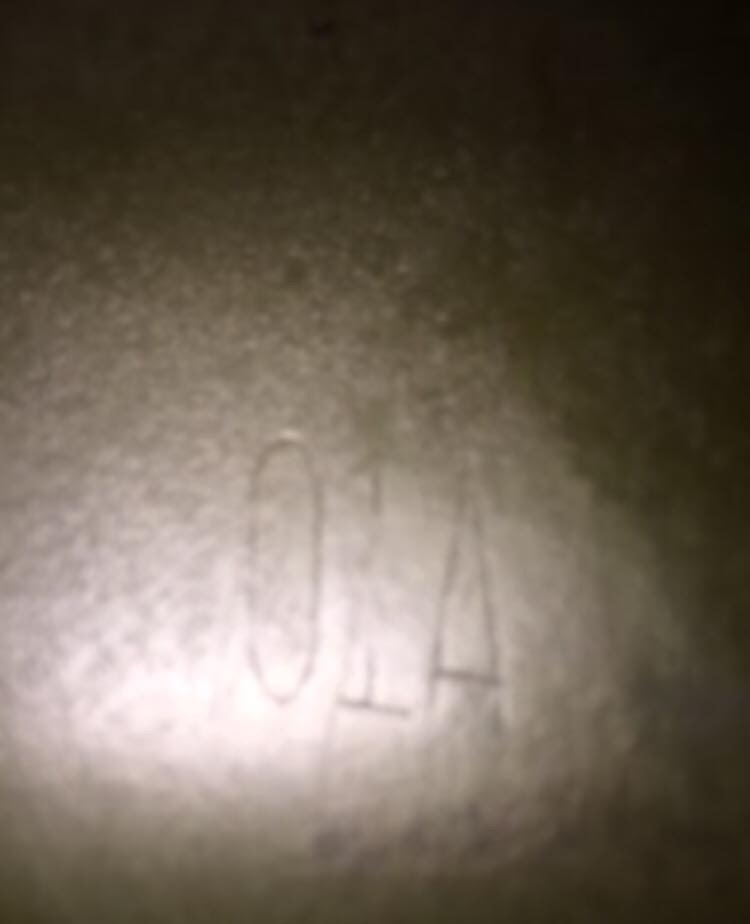

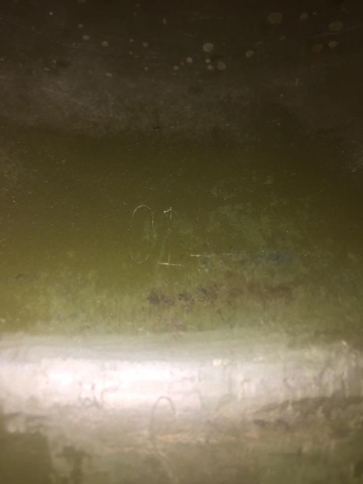

13th_Cavalry
Schlueter 01A from first batch. I need to update the list. More pics on the topic on here if you type in Schlueter 01A. It was a lucky find. Had the helmet authenticated already so im just sharing the low batch number. All i collect in M1s are pretty much Schlueters.

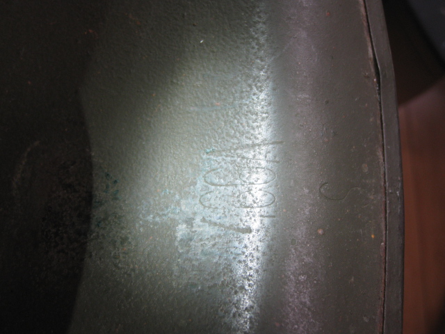

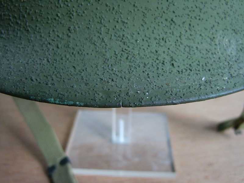

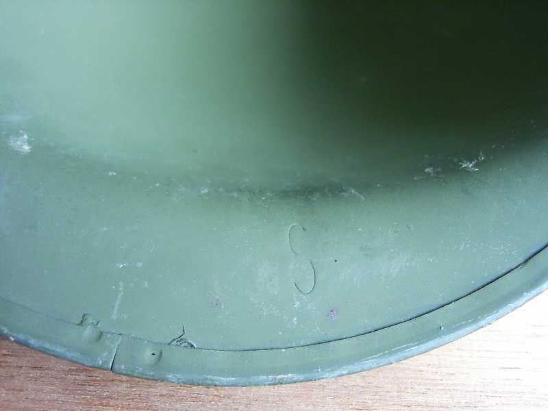

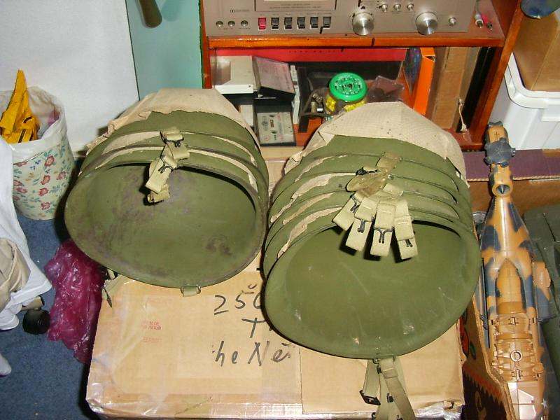

Hi. I know it's a "rough" configuration chart but was wondering why certain numbers are not present. I myself have Schlueter helmets # 524A, #534A and 542A, all rear seams no chinstraps. I also have a #216A front seam but not followed by an 8 as the chart lists.
I created the chart by observing original examples shared on forums, ebay listings, google image results, etc. If you or anyone else did not share those examples, how am I supposed to know enough information to add them to the chart? Additionally, this chart only includes helmets that still retain their original chinstraps, whereas your examples are all lacking. Did you read the initial post? "...f you have a helmet that meets the criteria and is not already on the chart, please by all means post your findings."

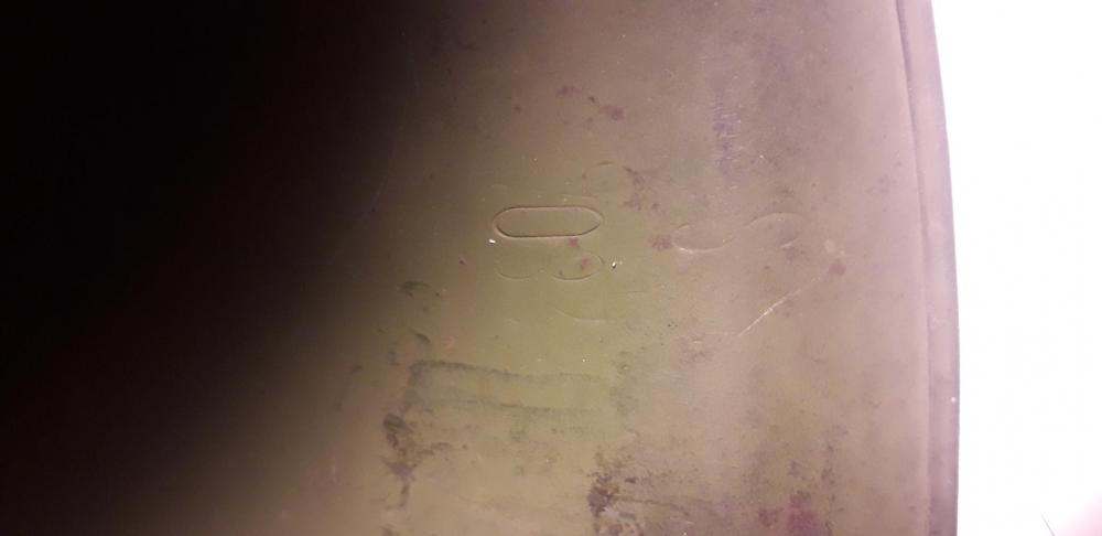

Yes, I was actually adding those numbers for you to use perhaps on a future new list. I also have a fixed bail with stamp #2?5A. The number after the 2 did not fully come out but it shows a loop on top for a partial number which could be a 2,3,6,8,9 or 0.

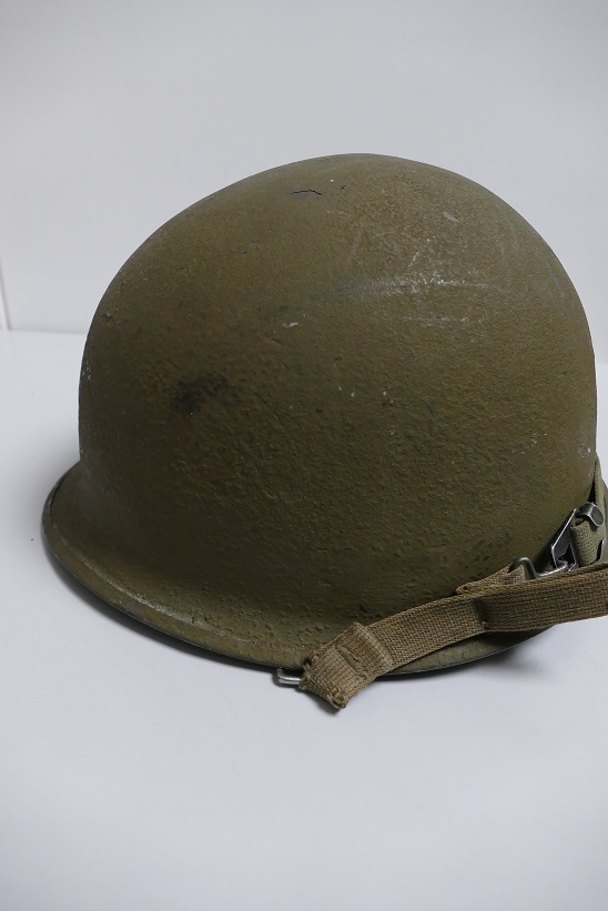

Hi Guys

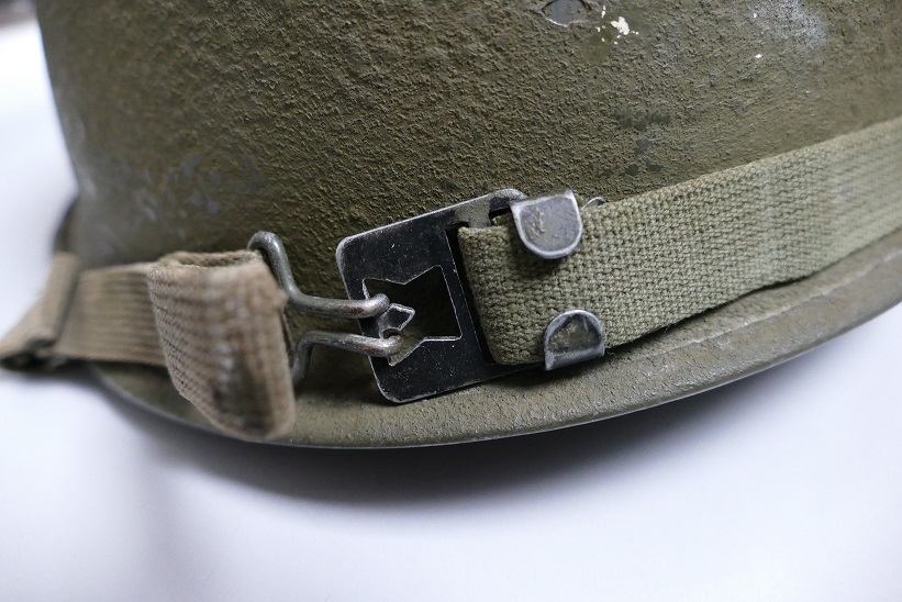

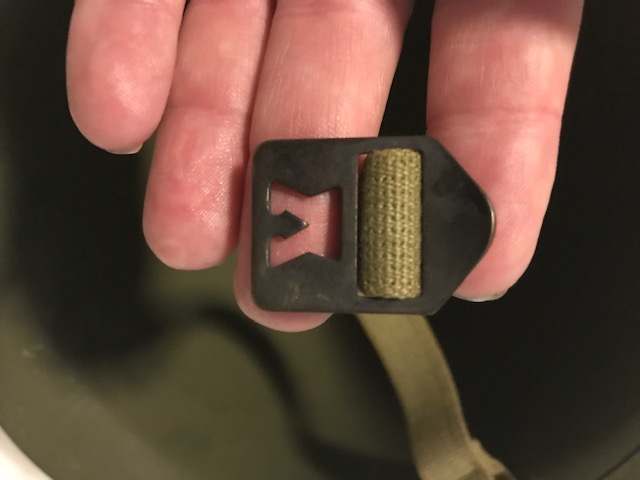

Hope this helps. I have a Schlueter heat stamp 522A with original OD7 chinstraps.
It is rear seam, swivel bail with a Manganese rim.
The buckle is a blackened flat brass type and the J hook is also brass with flat cut ends.
I've got one with a heat stamp of 517A. Manganese rim, rear seam, swivel bail, with OD #7 chinstraps, and flat blackened steel hardware.
Doesn't add any new information but I figured I'd share since it was one of the missing lot numbers.

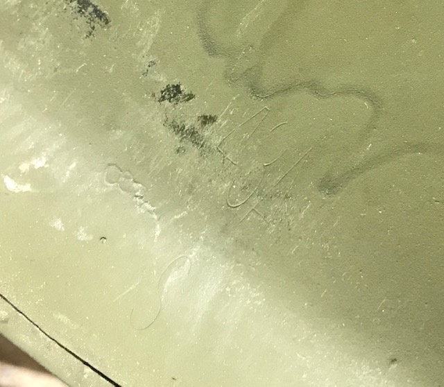

I have a Schlueter Shell with a pre Vietnam war liner. The shell is a rear seam swivel bail with OD 7 chin straps and has the number 49?A. The unknown number could either be a 3,8,6, or 0 can't really tell.

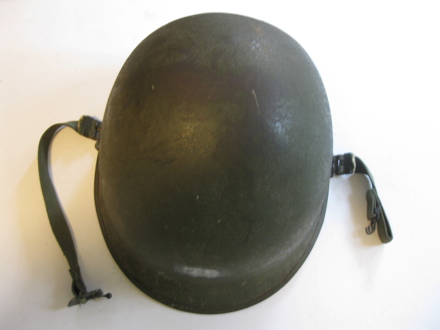

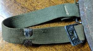

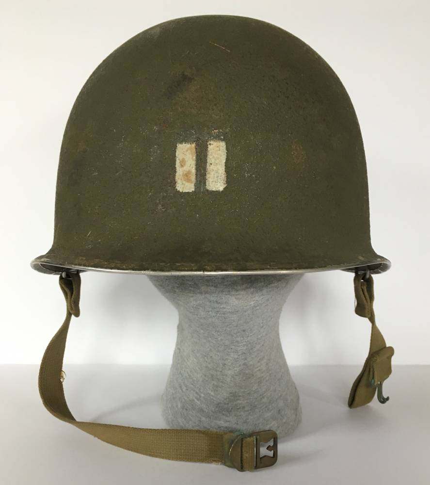

I have two Schleuters in my collection:
248A swivel bail front seam straps OD7, flat brass buckle
280A swivel bail front seam straps OD7 (but these look awfull new, maybe post-war replaced) flat brass buckle
the marking of the 280A is out of line

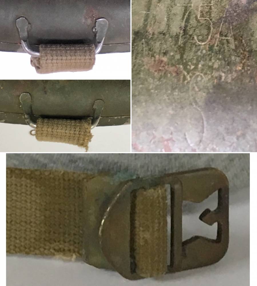

I noticed you have lot 75B, but not 75A represented. Here is my example, which differs slightly:
Fixed Loop, Front Seam, Stainless Steel Rim, OD3 Straps, Raised Brass Buckle
Catfishcraig
I have a mint Fixed Bail Schlueter with heat stamp of 43A. It came with a mint Inland Liner.
Catfishcraig
Unraised painted brass buckles and OD 3 straps

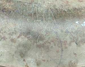

I think we should also add 13th_Cavalrys 01A Heatstamp to the chart. Even though we don't know much about the helmet he still had pictures of the heatstamp and everything looked good. Just my thoughts.

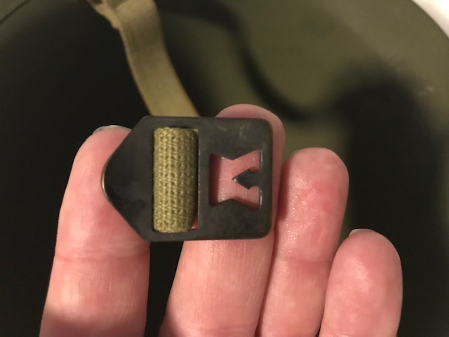

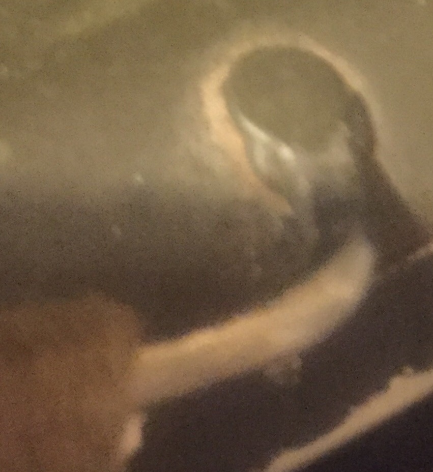

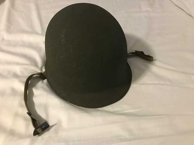

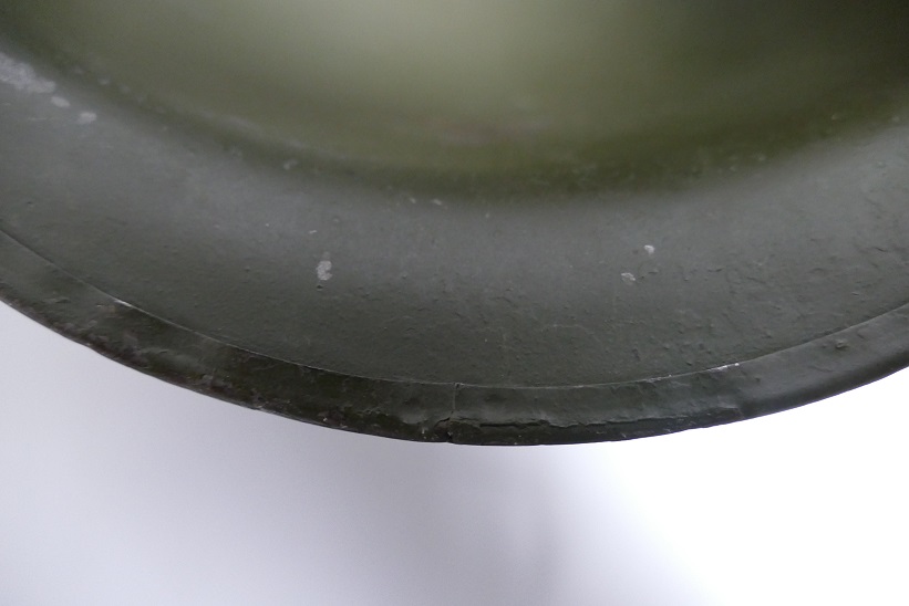

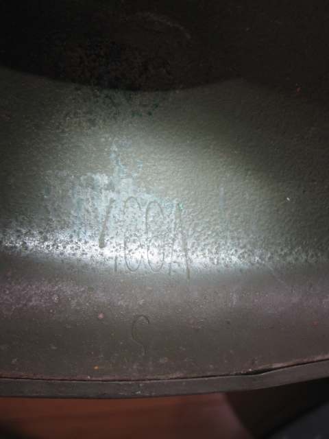

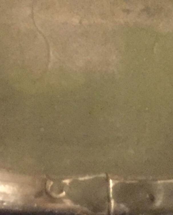

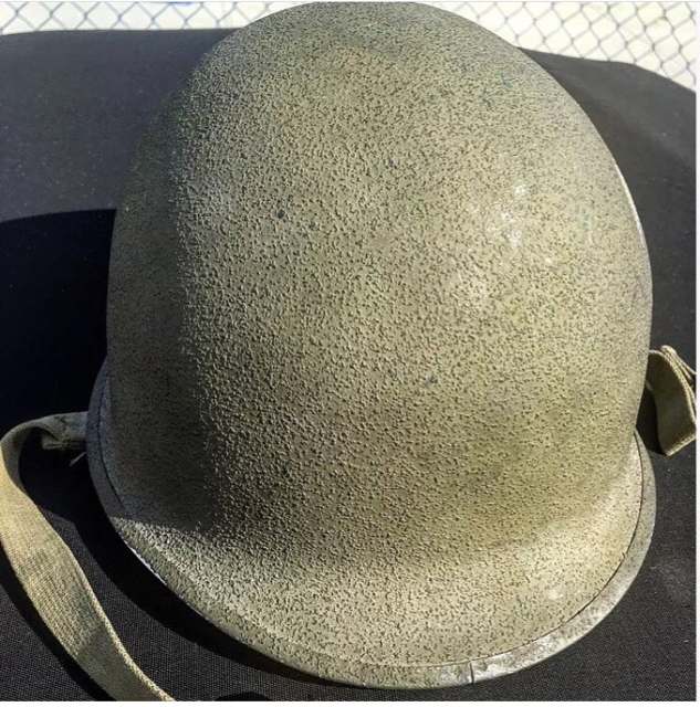

I can probably close another gap with a heat stamp I read as 329A: Manganese rim, front seam, swivel bail. The chinstraps look OD#3 to me, with flat blackened steel hardware. This is my very first post - Please kindly let me know in case I missed out or misinterpreted anything?post-233171-0-97895900-1561477682_thumb.jpgpost-233171-0-76230400-1561477696_thumb.jpg
Shell repainted but chin straps look original to me
post-233171-0-76226900-1561478334_thumb.jpgpost-233171-0-72868700-1561478343_thumb.jpg
