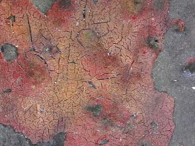

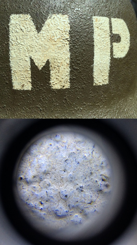

Rick, I just picked up the exact same magnifier from Amazon and it's awesome! You can see micro cracking as clear as day. Only tricky part is taking a photo through that loupe.
Here is an example of my original MP helmet magnified as a model for what to look for

Another example, paint looks pretty smooth from a distance but, under magnification, it's got micro cracking.

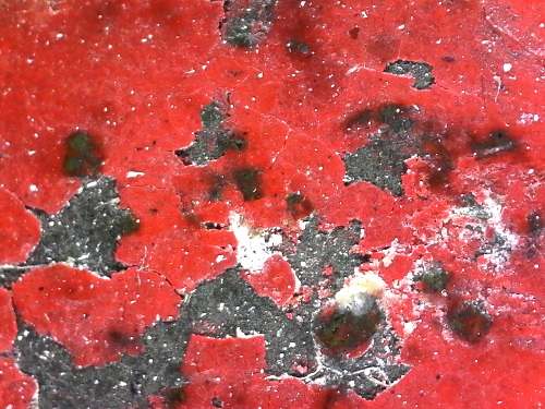

I agree with the high % of age cracking when paint is vintage

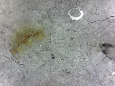

I have noticed that is more present and noticeable in white paints. Others does not crack so evident
Here you have the visible age cracking in the white paint but not so noticeable in the red paint on this medical helmet where cracking seems to be caused by the white pain coat t under the red one
Have also a 90th Div with similar evidences.

I believe that's because vintage white paint contains lead carbonate which, over time, produces those distinct geometric cracking patterns. When exposed to the elements, lead carbonate oxidizes over time and forms that yellow color you see on old white paint.
Other factors to take into consideration for cracking is that some paints just don't adhere to each other and crack/flake easily afterwards.

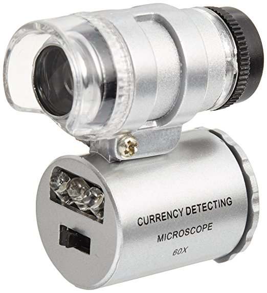

While carrying a jewelers loupe with you is going to save you a ton of money when purchasing, for a little extra comfort you can check it out with an electronic magnifier when you get home with 500X magnification which couples with your computer! These guys go for less than $50.
JUST ORDERED ONE (500X) OFF EBAY.

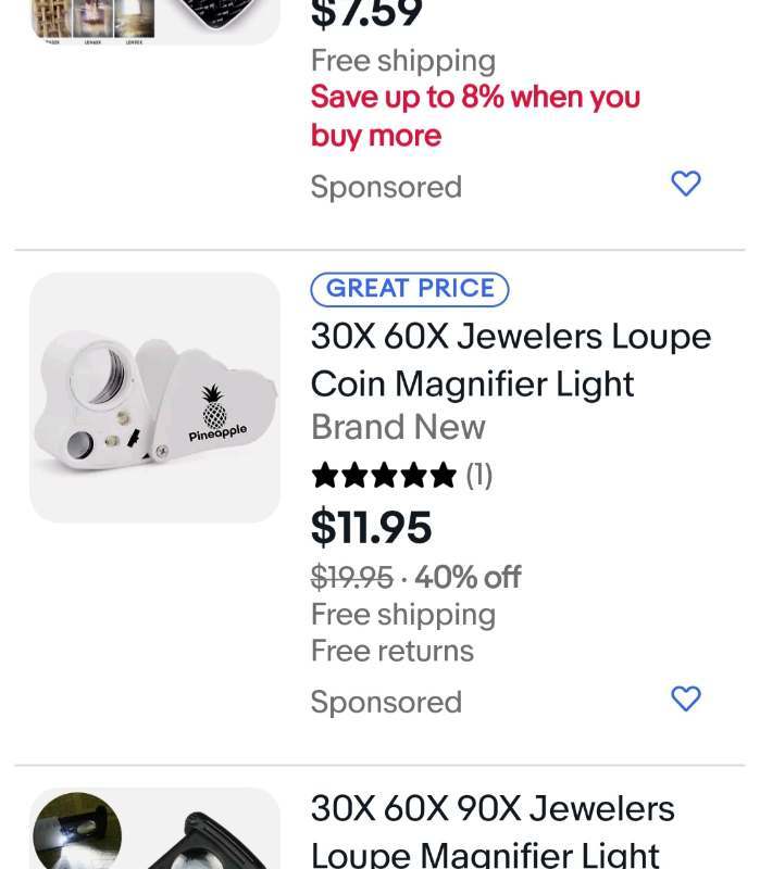

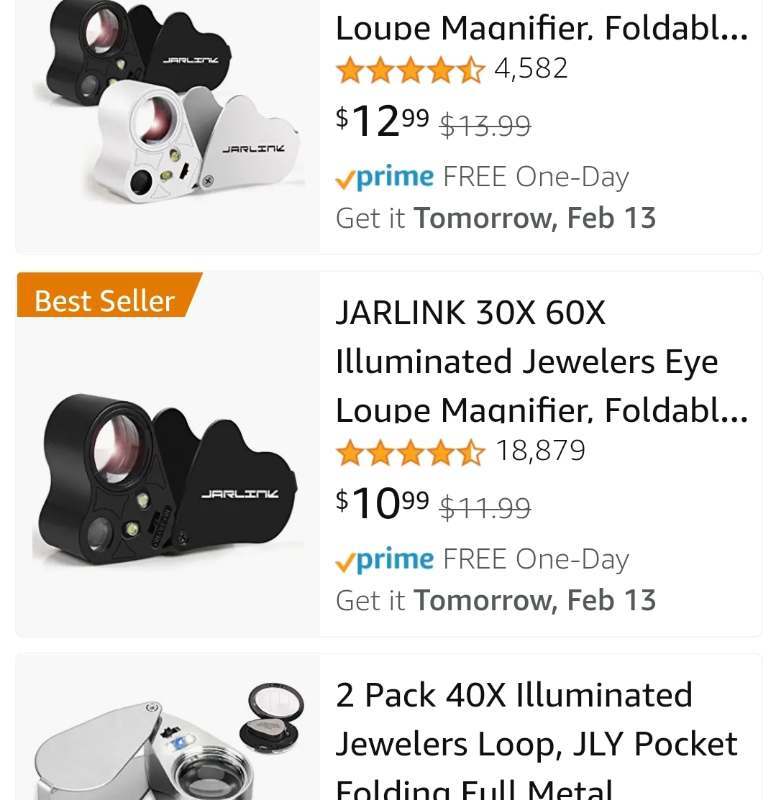

As show season begins with the SOS on the horizon, just want to remind guys to carry one of these handy jewelers loupe with you. You could save yourself from an expensive mistake with one of these. A quick search on eBay found dual 30X/60X lighted loupes, shipping from the US and not China, for $11.95 with free shipping and on Amazon for $10.99 with free next day delivery for Prime members.
Amazon:
eBay:

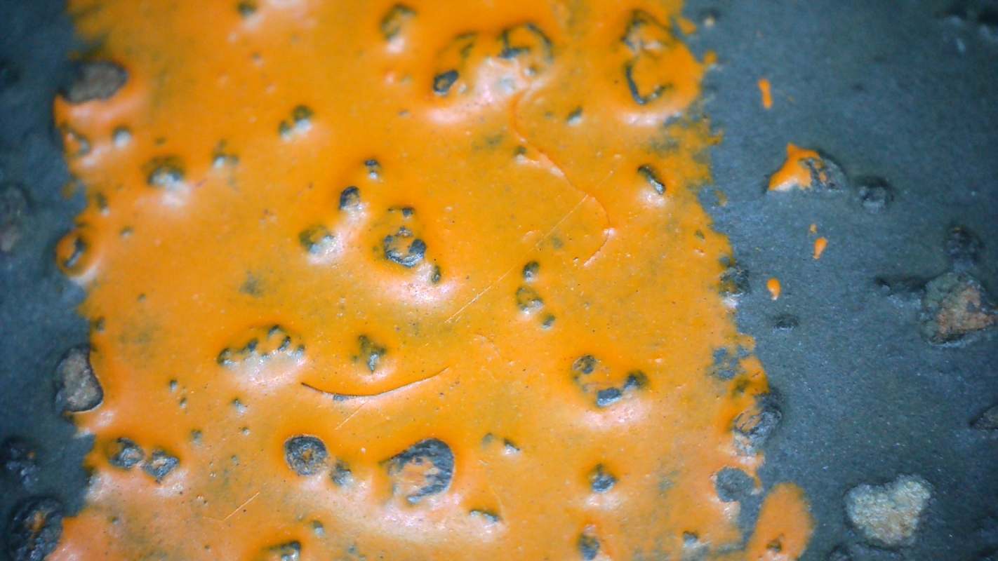

Morning folks,  would appreciate an opinion on colour paint used for stenciled lettering on an M1from an WW2 Emergency rescue squadron (3rd ERS was a Pacific based unit). I bought a fairly cheap mismatched set consisting of a FS SB McCord with the mid war steel buckle / J hook. Liner is an early 70's one. The condition of the OD, straps etc. are excellent, no corrosion at all. Which raises a question on Pacific theatre use, especially sea rescue of downed crews.
The helmet has stenciled letters in a fairly bright orange paint. I have seen 2 other examples of the same shell configuration with same lettering (one at SOS this year / Second on a FB group). Having viewed quite a few white painted sets under high magnification which mostly had the expected cracking, the paint on this shell exhibits zero cracking under high magnification. Simple question > is it a fantasy piece or a case of period correct colored paint not cracking?
Don't hold back, I bought this one too learn.
And this is why magnification is only "one" of the aides for authentication. Now comes knowledge of paints.
So, WWII white is high in lead content, low in pigment binders, so white tends to age check/crack/craze quickly.
Red, orange, yellow were also high in lead, however, they were also high in oxide which acted as a good binder.  This binder kept the paint from checking as quickly or as excessively.
Then, factor in that there were different levels of storage both good and bad. While one can look unchecked because of good storage, another can be highly checked because of excessive heat and/or moisture where it was stored.
I happened to have examined the one at the SOS in Louisville, and that one looked a lot like this one. Is this the one from there?
