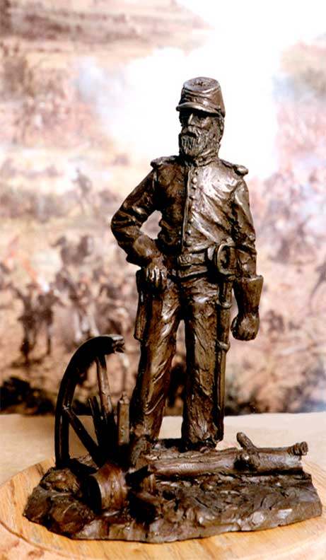

kanemono Posted July 3, 2013 Author #53 Posted July 3, 2013 Here is a small bronze I did in 1995 titled "Artilleryman at Gettysburg". The piece is lost wax cast and is 7" tall. Dick

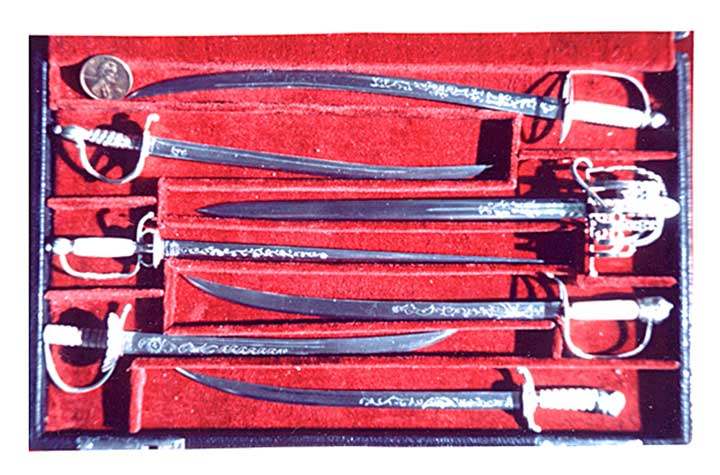

kanemono Posted July 8, 2013 Author #54 Posted July 8, 2013 Here is a cased set of miniature swords that would have been carried by officers during the American Revolution. The blades are steel and etched. The grips are ivory and the hilts are silver. They were all fabricated. They were commissioned in 1976 for the Bicentennial of the American Revolution. Dick

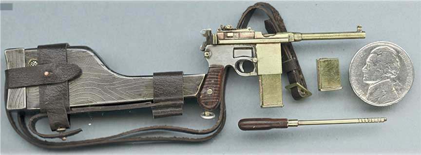

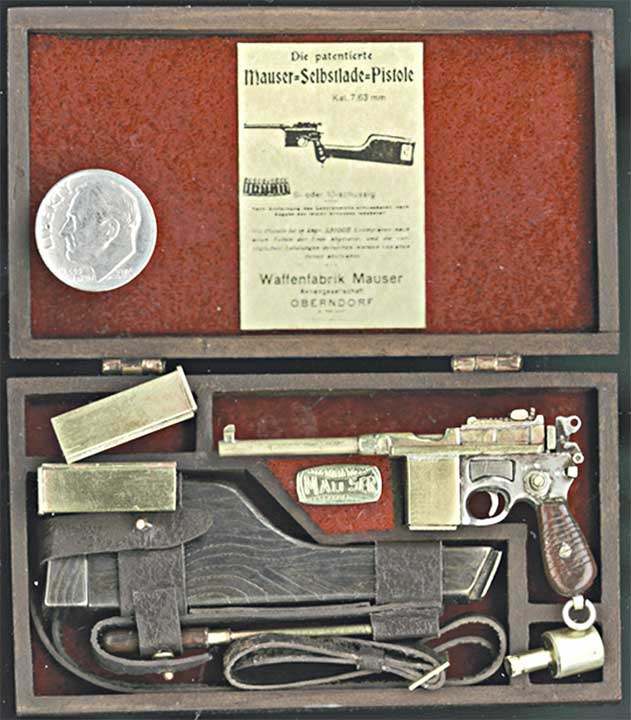

kanemono Posted July 27, 2013 Author #55 Posted July 27, 2013 I was asked to show some different pieces. This is a cased Mauser Schnellfeuer in one sixth scale. This was a Cotswold production piece. They made the pistol, stock and harness' Dick
Jack's Son Posted July 27, 2013 #56 Posted July 27, 2013 Dick.....is there ANYTHING you DON'T do?? These are beautiful works, such fine detail in the size, I'm impressed!

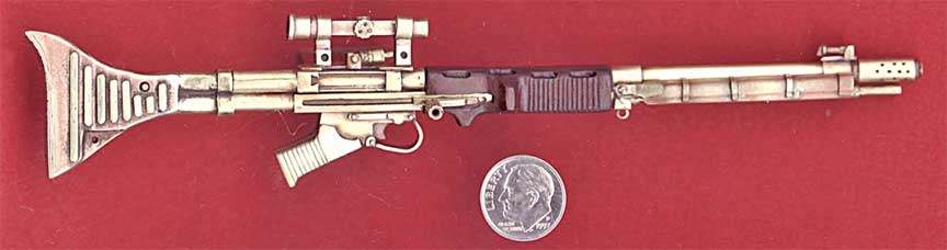

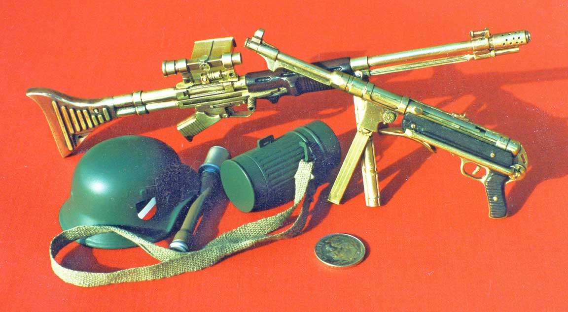

kanemono Posted July 27, 2013 Author #57 Posted July 27, 2013 Thanks Robin. I do very small pieces and very large bronzes. Here is another Cotswold piece. As before everything is fabricated from a hundred or so individual pieces. The MP-40's bolt is spring loaded and works. The stock folds and unfolds. The scope is removable on the FG-42 and the fixed sight folds up and down. The bi-pod folds up and down and the bayonet ican be removed and fixed. Dick
Sabrejet Posted July 27, 2013 #59 Posted July 27, 2013 Unbelievable skill and attention to detail! Do you make molds from these masters and then cast them in white metal or resin?
kanemono Posted July 27, 2013 Author #60 Posted July 27, 2013 These pieces were produced from my prototypes in plastic. The plastic weapons were produced in China for Cotswold Collectibles using injection molds created by pantograph from my brass original prototypes.We did make some pieces in the US in both white metal and resin.Here are some pieces that were produced in resin in the US. Dick

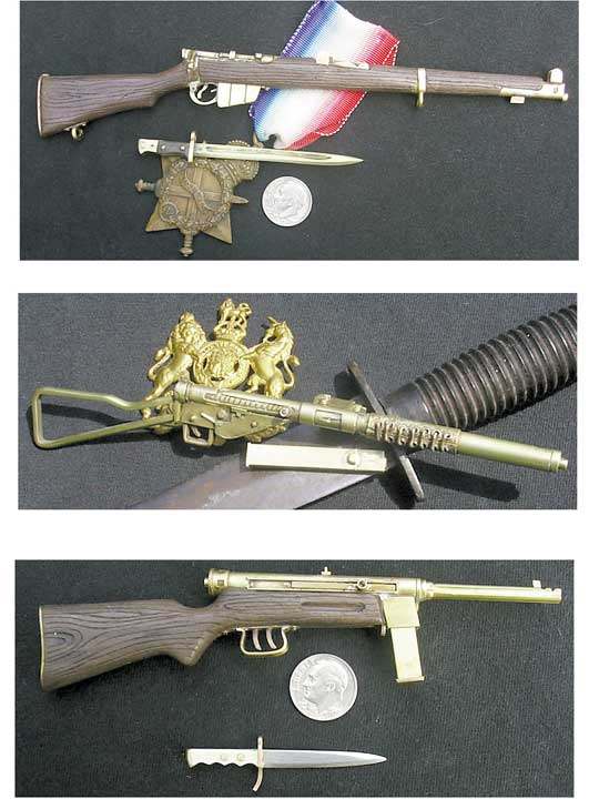

kanemono Posted August 3, 2013 Author #61 Posted August 3, 2013 Here are several more brass prototypes that were made for Cotswold. All metal parts are brass and the stocks are made from colored epoxy. I really liked the way the lacing on the silencer on the Sten worked out. These are all fabricated from dozens and dozens of individual fabricated pieces brazed and silver soldered together and 1/6th scale. Dick

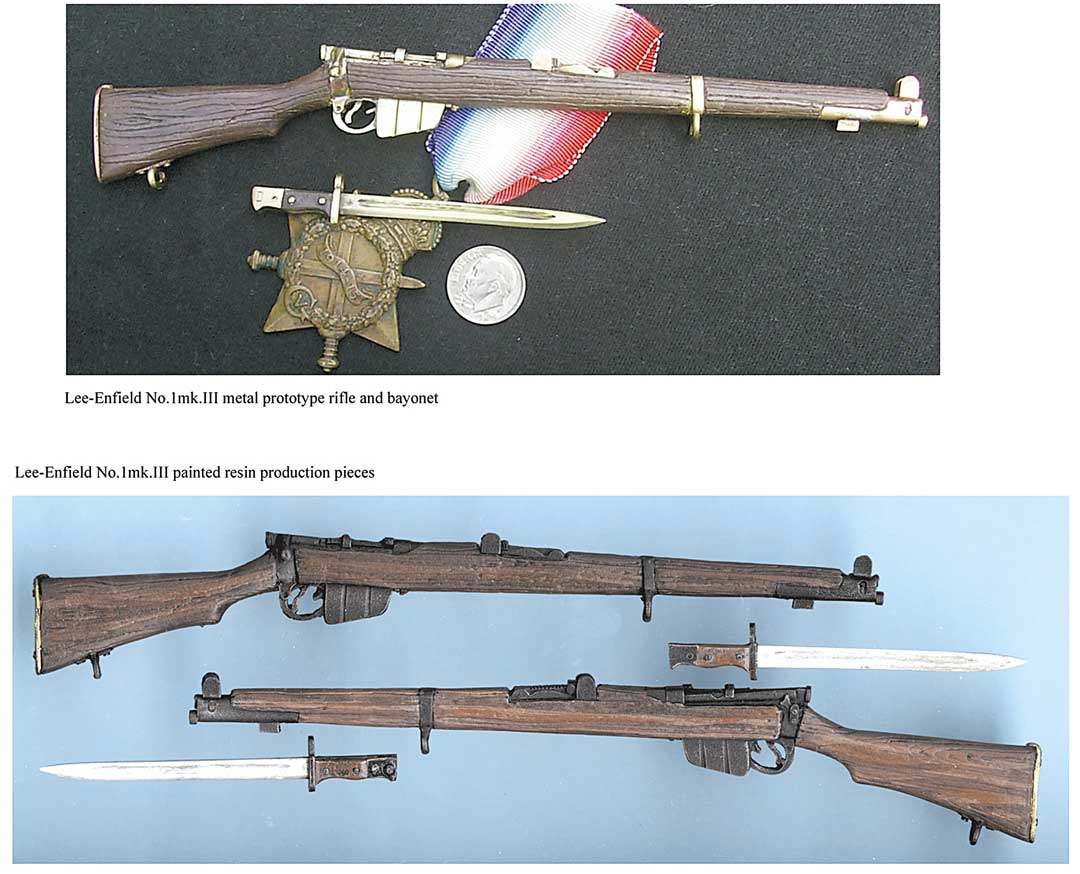

kanemono Posted August 6, 2013 Author #62 Posted August 6, 2013 Here are resin production examples of the Lee-Enfield No.1 Mk III. Dick

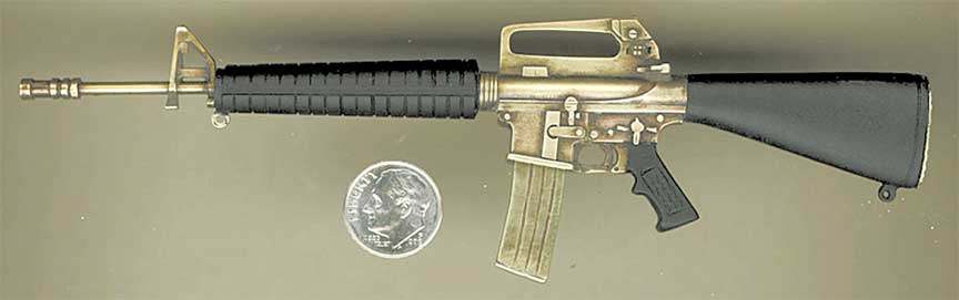

kanemono Posted August 15, 2013 Author #64 Posted August 15, 2013 I was looking through my photographs and found this prototype of an M-16A1 and thought I would add it to the post. I think this was mass produced in resin but I am not sure. All of the metal parts are brass and the stock, handguard and pistil grip are made from epoxy. This like the other prototypes is fabricated from dozens of individual pieces brazed and soldered together. The magazine an be removed from the rifle.

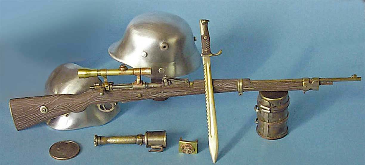

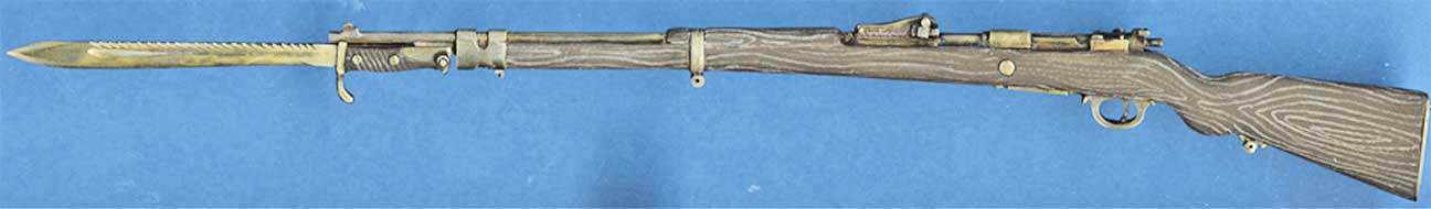

kanemono Posted August 31, 2013 Author #65 Posted August 31, 2013 Here is a set of items used by a World War one German sniper. The Stahlhelm has the heavy front plate to protect the sniper's head while firing,he also has the pioneer bayonet for cutting brush. Everything is one sixth scale. The trigger guard on the Mauser is made thicker to allow for shrinkage during the manufacturing process Dick

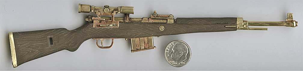

kanemono Posted September 14, 2013 Author #67 Posted September 14, 2013 Here is a G-43 snipers rifle I made that was reproduced in the US in white metal. The production piece had a nice heft. The magazine was removable. The rifle was made up from dozens of pieces fabricated from brass except for the stock which was resin. Dick

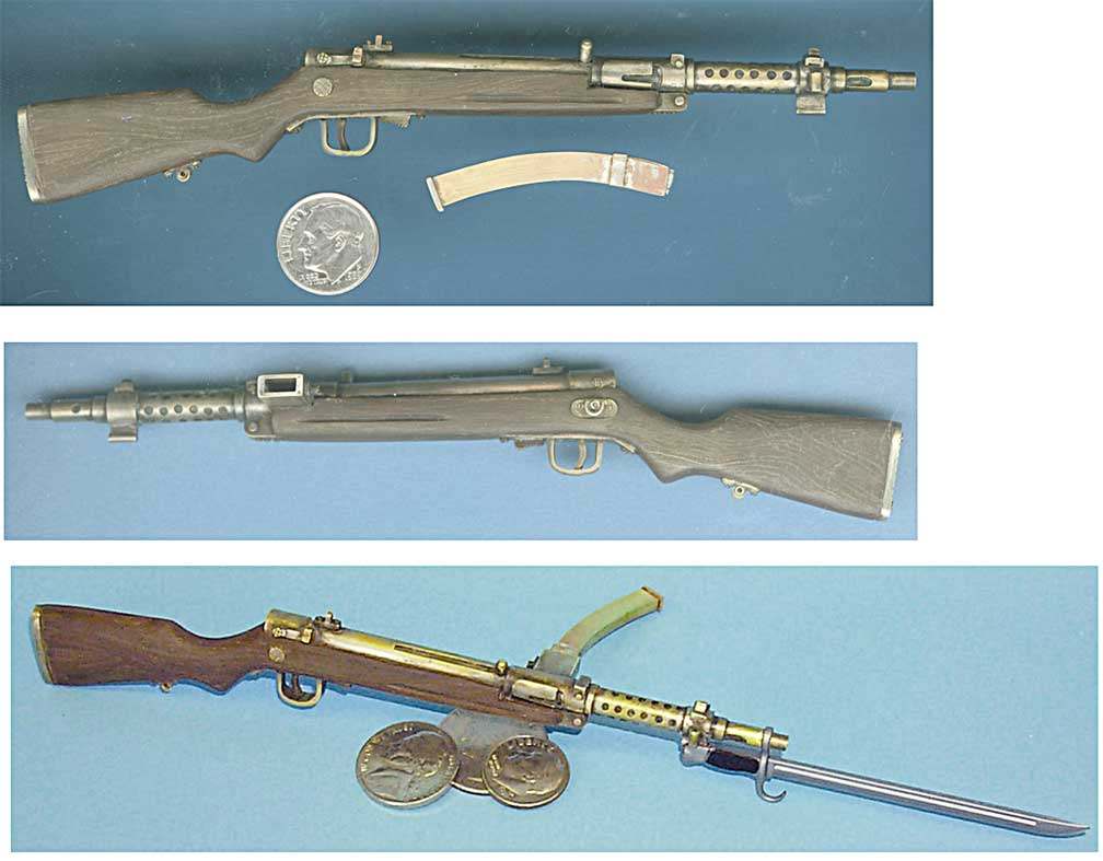

kanemono Posted October 15, 2013 Author #70 Posted October 15, 2013 Here is a prototype of a Japanese Type 100 Submachine Gun made for Cotswold Collectibles. The full size gun was made in 8mm Nambu. The trigger guard is thick to allow for shrinkage in the manufacturing process. The bayonet is a plastic stock Cotswold item. All metal parts are brass and the stock is made of epoxy. The days of the handmade prototype are over since the injection molds are now cut using a computer controlled milling machine from original blueprints. Dick.

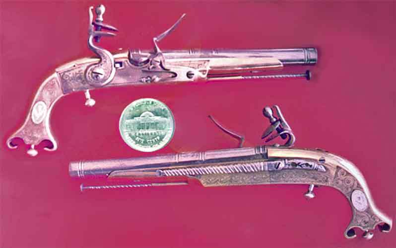

kanemono Posted December 17, 2013 Author #73 Posted December 17, 2013 Here is a pair of miniature Scottish pistols I made in 1976 for the bicentennial. I apologize for the photograph. When I took the picture I was using 35mm movie film from California to save money and the image deteriorated. I tried to scan the image almost twenty years ago on my old Mac and when I tried to transfer to my PC the image really got messed up. I tried to clean it up and this is the result. It was the only image I had of the pistols. I sold all of my early miniatures at gun shows so I have no idea where the pair are now. Dick

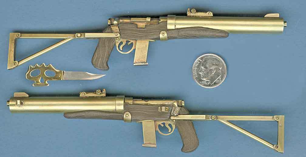

kanemono Posted January 2, 2014 Author #74 Posted January 2, 2014 Here is a "GI Joe" prototype created for Cotswold Collectibles in 1999 of a De Lysle .45 ACP single shot Commando Carbine. This converted .303 SMLE rifle was almost totally silent. It was used by both British and American Commandos during WW2 and Korea. This miniature is 5 1/2" long the magazine is removable the stock folds and the bolt opens and closes. This rifle is made from dozens of individually fabricated brass parts. The stock is sculpted epoxy resin. The trigger guard is thicker than scale to allow for shrinkage. The Middle Eastern knuckle knife is made of brass with a steel blade. Dick
KASTAUFFER Posted January 2, 2014 #75 Posted January 2, 2014 All I can say is WOW. Your talent in creating these is extraordinary. Kurt
