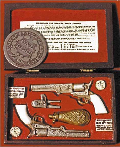

Here is a pair of cased Colt Navy pistols with flask and bullet mold. The grips are ivory, the cylinders revolve and the bullet mold works. Each pistol is 1 1/4" long. That is a real dime.
Dick

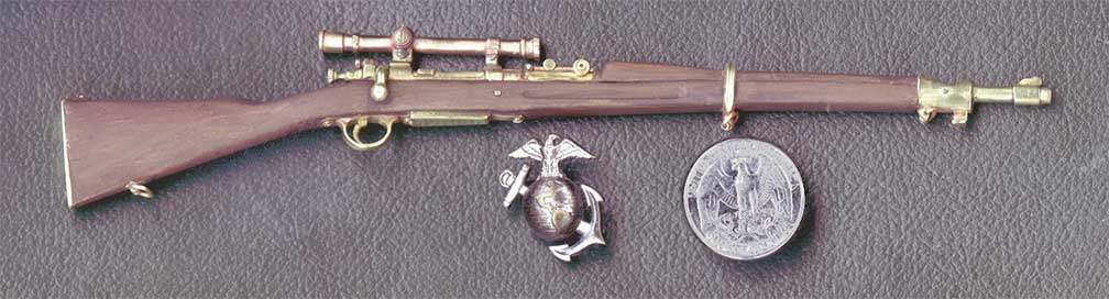

Here is a prototype of the 'o3 Springfield Sniper Rifle. This is one of my embarrassing mistakes. The sniper scope is wrong. When I created this piece I used a picture from the American Rifleman as a reference. The problem was that this was a scope that was tried but never used. I was called to task at the GI Joe Convention in Washington DC. All I could say was "sorry" I made a dumb mistake. The interesting thing was that only one person spotted the mistake and he collected sniper rifles.

Thanks for posting your incredible artistry, Dick. It's hard to believe they're miniatures and that your Liberty dime isn't about 5" diameter!

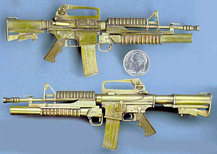

Here is another brass prototype I made for Cotswold in the 1990's. This M-4 is made from well over one hundred separate individual pieces soldered and brazed together. This piece is a bit beat up because it was used to make an injection mold. Before everything was created in a computer, injection molds were made by a pantograph tracing all the detail on one side of the prototype then flipping the prototype and cutting the other side of the steel mold. I had to make the prototypes in brass to survive the process. Today everything is cut from drawings or scans direct from a computer. All the people like me were put out of a job, however, the finished pieces are exact, perfect copies of the real thing. Human error has been eliminated.
Dick

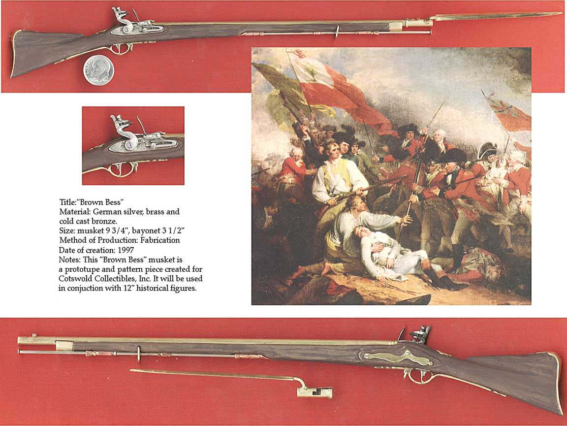

Here is another miniature. This is a "Brown Bess" musket used by both sides during the Revolutionary War. All of the metal parts were fabricated from German silver and brass. I sculpted the stock in wax, made a rubber mold and cast it in "cold cast bronze" which is bronze powder and epoxy resin. This piece was used with a number of 18th century figures.

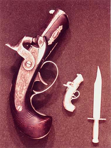

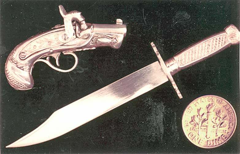

Here is a working miniature Derringer that I made for the Franklin Mint in 1977. This is the model Derringer that Booth used to shoot Lincoln. The gun and knife are fabricated except for the pistol stock which I sculpted in wax and cast. Everything is sterling silver except for the springs, which are steel.
Dick

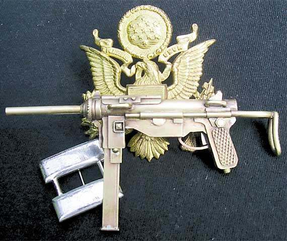

I had posted this Grease Gun by itself and I thought I should be here since it is a Cotswold prototype. I think this came out really well, one of my favorites.

I agree...that is a pretty nifty miniature M3. Remarkable detail in so small a scale!

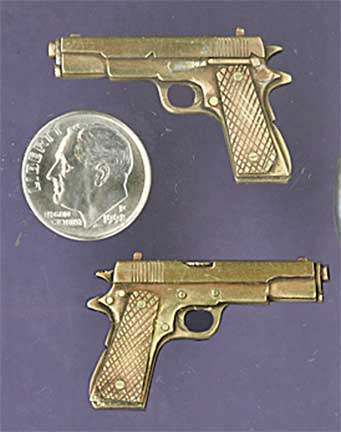

Thank you both for your comments. There is a lot of time involved but when I worked creating peototypes I learned to work fast. There was a strict timeline so pieces needed to be finished on time. It was a lot of fun! Here is a Colt 1911 that I made for Flatt World Figures "The Phantom" figure.

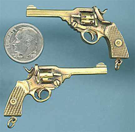

Here is a Webly .455 pistol. I think this is OK to post since the Webly pistols were used by Americans who flew with the RAF in WWII. The piece is brass and fabricated from many pieces. If you were wondering how I was able to do the checkering on the grips so well there is a secret method. Not really. I placed a file between two sheets of brass and ran everything through a rolling mill. The brass protected the rollers from the file while printing the checkered pattern into the brass.
Dick
