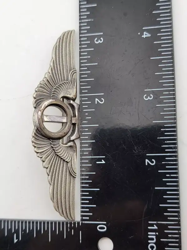

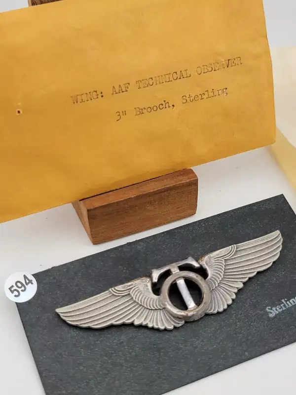

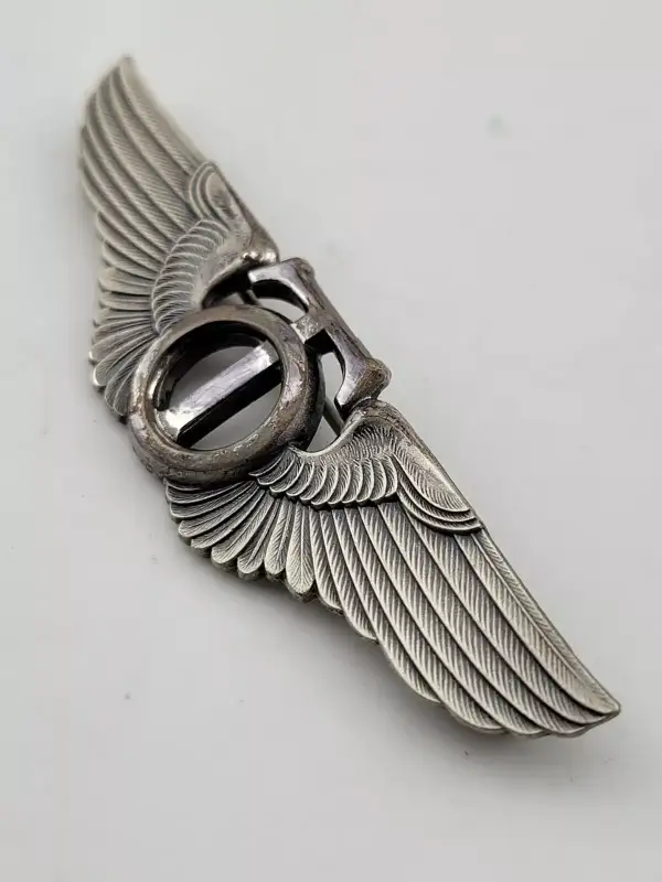

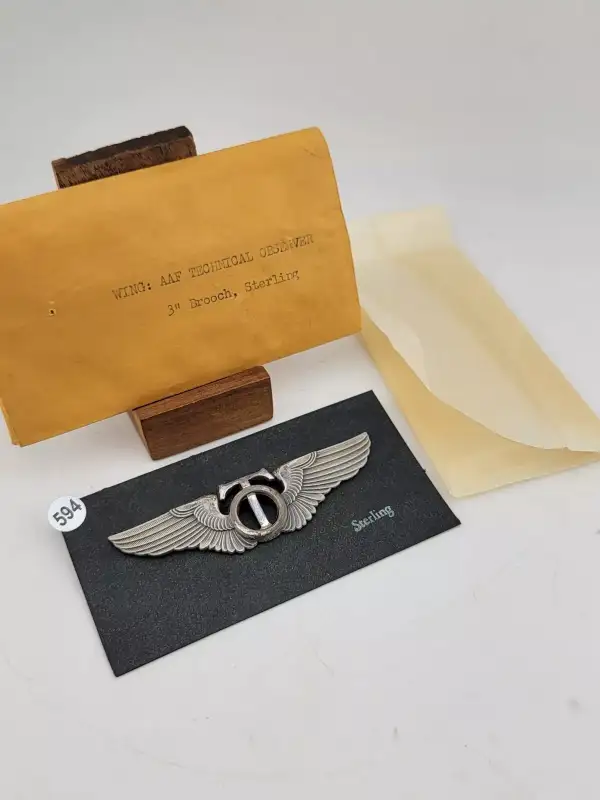

Available on eBay for $350 is this modern restrike of a very rare LGB/Balfour Technical Observer wing. It is pretty close to the original since it has been restruck from LGB dies. It is not a period manufactured wing. The tells are the overall finish of the badge, the pebbly finish on the back and the LGB STER hallmark. LGB wings were never marked STER. Compare to an original example here: http://ww2wings.com/wings/usaaf/technicalobserver/rwlgbto.shtml

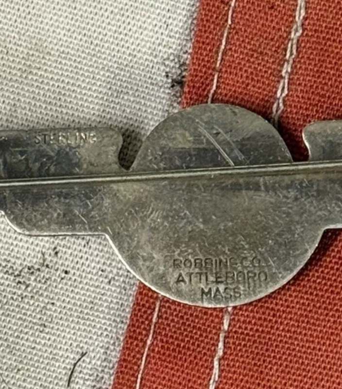

Fake ACFC wing on ebay. There is a good write up HERE. I was curious on these so I did some research here. Glad I did. Hallmark is wrong. Should be: ATTLEBOROMASS
             STERLING
Sterling is in the wrong place.

If you look at the "ACFC" wing image in post 362 or 363 you will see another obvious problem.
The center piece has morse code with five letters   A - F - A - T - C  (red - blue - red - blue - red)
These are the letters for Air Force Air Transport Command, not Air Corps Ferry Command
That center piece is the first thing I look at. And of course the markings are wrong as was already stated.
