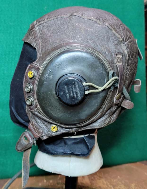

viking73 Posted July 24, 2021 #13 Posted July 24, 2021 Hi Group, I recently picked up this A-11 helmet with the receivers. Looks to me that the receivers aren’t properly seated into the rubber ear cups… I found this thread after a search. I am hoping that with the aid of some dish soap and a butter knife, I can get them seated properly. I don’t think unscrewing them would help at this point? -Derek
pararaftanr2 Posted July 24, 2021 #14 Posted July 24, 2021 Agreed, at this point, unscrewing won't help. You might try pushing on the earphone from inside the helmet with both thumbs, if they are not totally unseated from the rubber cup, to pop them back in place. It's worked before. Good luck!
phantomfixer Posted July 24, 2021 #15 Posted July 24, 2021 Yep yhe hard part is over..push from the inside, and they should seat fairly easily
viking73 Posted July 24, 2021 #16 Posted July 24, 2021 Man, I tried pushing them in with my thumbs and the only thing that happened was my thumbs are now sore from the effort! Looks like this won’t be easy at all… ☹️
