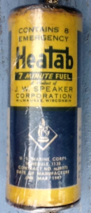

General Apathy Posted May 2, 2018 #2 Posted May 2, 2018 Hi Guys, The humidity in my apartment has been around 50%. As far as collectibles go, is this too humid? I know 40/45% is ideal for comfort but as far as damaging things, should I get a heavy duty dehumidifier? I have damprids in my apartment but they don't drop the humidity at all. Somewhat related question, are there any high end, very accurate hygrometers out there? I just use one of the top rated ones on Amazon but it doesn't seem super accurate. Thanks! .Hi Avigo, how very weird, I had several of these 1943 dated USMC Heatabs, and sadly due to humidity I lost three of them, the tabs inside absorbed the humidity and dissolving the tabs the tubes then fell apart as well from the moisture. literally just five minutes ago before finding your post I wrapped my last perfect one in food-wrap to preserve it and the tabs inside, I have had previous success doing this with other GI items, soap, chocolate bars, cigarette packs, and other items susceptible to moisture. Being a round tube it is more difficult to seal the ends neatly, much easier on square items. Also amused by your Avatar photo, I have the same style watch in my collection, but no-where as clean as your example......... Nice piece. Good luck with your quest for protecting your collection. Lewis. .
avigo Posted May 2, 2018 Author #3 Posted May 2, 2018 . Hi Avigo, how very weird, I had several of these 1943 dated USMC Heatabs, and sadly due to humidity I lost three of them, the tabs inside absorbed the humidity and dissolving the tabs the tubes then fell apart as well from the moisture. literally just five minutes ago before finding your post I wrapped my last perfect one in food-wrap to preserve it and the tabs inside, I have had previous success doing this with other GI items, soap, chocolate bars, cigarette packs, and other items susceptible to moisture. Being a round tube it is more difficult to seal the ends neatly, much easier on square items. Also amused by your Avatar photo, I have the same style watch in my collection, but no-where as clean as your example......... Nice piece. Good luck with your quest for protecting your collection. Lewis. . image.jpg I'm sorry to hear that! What was the humidity % of the area those items were stored in? Yeah, I love those Elgin watches!

Bluehawk Posted May 3, 2018 #9 Posted May 3, 2018 6. Inherent vice - a small percentage of artifacts, such as perhaps the Heatab illustrated above, are just going to deteriorate under all but the most strident storage climate conditions, and maybe even then. Other examples include nitrate film (such as most old movies were made of), certain kinds of batteries, certain dissimilar metal alloys in contact with one another, some works of historical or contemporary art, certain mixed media artifacts, objects in which the process of deterioration/corrosion/rot have already begun and the like. 7. Hygrothermograph - This device is useful in some applications such as large collections in different rooms or rooms/spaces of differing sizes. What it accomplishes is to tell us what is basic common sense (i.e. relative humidity and temperature fluctuate over time, and by how much, within what range) but mainly to signal anything highly unusual about the stability/consistency of storage climate, which needs immediate attention. 8. Humidifer - As has been many times stated, using the best possible and/or professional grade machine is usually best, because it can be calibrated and regarded as effective.
