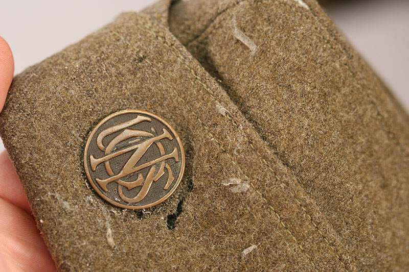

I was photographing my collection and upon pulling out a sidecap, I noticed a bunch of moth bites and larve cocoons.
I didn't remember this hat being in this shape when I put it away, and oddly enough, it was in a ziploc bag inside yet another ziploc bag! My only guess is that the larve were on it when I got the group and then decided to feast on the hat (and putees) in the bag over the past year. Oy!!!!!
I've been asked a few times what mothing in progress looks like. So, here it is. Sadly, it's a hat in my collection (now in the freezer!) that had to jump the proverbial grenade. Luckily, out of 114 uniforms and groups, this was the only mothing I found, but still......
First photo...the tell tale cocoons...
A bit more close up to the damage. At this time, I DID NOT KNOW that I had one of the buggers on my thumb!!!!!!!!! w00t.gifw00t.gif
And finally, the culprit. My camera couldn't focus 'cause the little bugger was FAST! He was hauling along the hat...and now he's frozen to death.

E-Gad! :unsure: That is my worst nightmare!! fear.gif Now you prompted me to go look through my uniform collection again to check for any of the vermin! Did you put the hat in the freezer once you got the grouping, or is it in the freezer for the first time?

No, it's in the freezer now. Some folks swear by putting their groups in the freezer to keep the mothing at bay. Had I done that with this one, it would have saved the hat (the puttees weren't bad). However, when I was getting in around 5-10 groups a week...that requires a real, real, real big freezer (and one I don't have!)

You don't have to permanently store the items in the freezer, just keep them there for about 2 weeks to a month. (Turn the temp down as far as your freezer will go.) The cold will kill the larva or the eggs. Best is what one of the others metioned, though, and that is a thorough dry cleaning. The solvents will kill the bugs and clean 'em out at the same time. Freezing is the choice if there's concern the item will be damaged by dry cleaning. Most 20th century (WW 1 and II) wool items are OK with dry cleaning if they're otherwise sound (i.e. the stiches are not rotted, the cloth is not too fragile, the dyes are not "ersatz," metallic braid or stiching is not falling apart, etc).
You really have to make an item by item choice to decide if it will stand up to the handling at the cleaners. Places that specialize in furs, wedding gowns, and other expensive garments are usually bonded and will take care to handle things carefully. (If the counter help is clueless, ask when the manager will be around and go back later to discuss your item with someone who will give a darn.)
If the item is really fragile, your best bet is to hand wash and dry flat. You can judge as you're washing just how much handling the item can take. If the item is too fragile even for that, then freezing and carefully vacuuming (cover the end of the hose with a piece of nylon stocking to keep it from sucking the fragile cloth into the nozzle) or use a combination of a small 1" paint brush to losen the dirt and dust and the vacuum to just take it away (i.e, not applying the vacuum directly to the cloth; best done with two people working together, one brushing and one vacuuming).
The moths have much less tendency to get into clean wool than dirty. Moth balls or flakes work well, but stink, are poisonous, and have to be kept enclosed with the wool to work. It's not necessary to permanently keep the wool item enclosed with the moth balls or flakes, just for 1-2 weeks to kill the moths. Keep the balls or flakes away from the direct contact with the wook (use sachet bags or a smal pillow case, etc to hold them.)
Cedar is really only a repellant, and works only in enclosed spaces. It won't kill the moths or larva, so is only effective if the item is already moth-free.
Isolation of new items from the rest of your collection, as also mentioned, is a very good practice. But, you do need to periodically monitor the item to catch the little bast**ds even then. The standard for isolation is also about 30 days.
