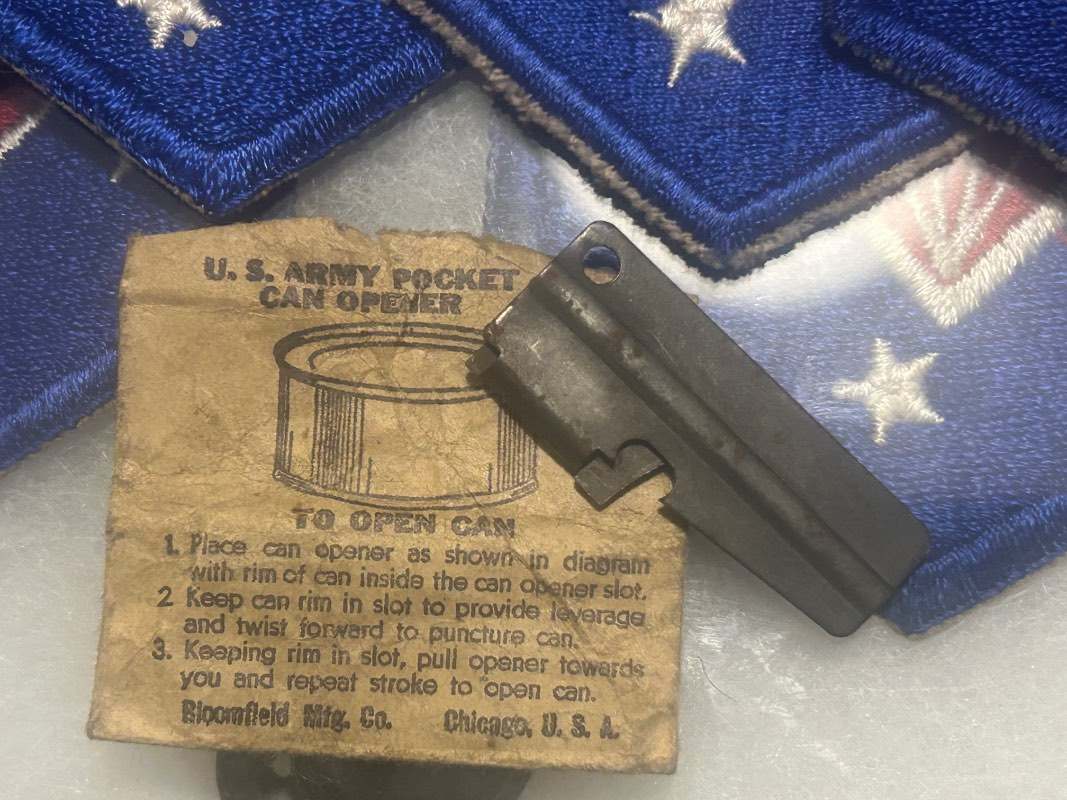

Also, does anyone know how to tell these wrappers are definitely WWII?

Wrappers WWII (reportedly).jfif

That would be nice to see, then we'd know that WWII issued can openers were dated. I just can't find any online and don't have one myself. Maybe someone out there has some more examples.
I googled and sure enough no ww2 dated P-38s are coming up. I can confirm they exist. Maybe dated ones that early are super rare.
