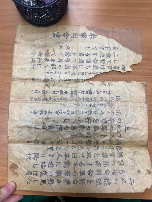

My maternal grandfather was Martin Quince Porter 1912-1972. He was a school teacher with 4 daughters when he was drafted by the US Navy for WWII. Family legend states he was helping clear out offices and this made it into his pocket. He was afraid of what would happen to him if anyone found him with it. It was given to my mother when she accepted a job teaching American History. When I went to college (1991) I took it with me and had an international student from Japan translate the letter. I remember how shaken she was by it and asked how I got it. I was young and didn't realize how it could affect her.
I'm uploading the document, her translation and a pic of Quince Porter.
I'm very curious if anyone has seen something like this before?  It's one piece of paper with writing on front and back. I've shared different views of it.  I've also included the translation --I'm not even sure if it is correct. Any information or referral source would be greatly appreciated!
Although with my limited ability, this is a more accurate translation I believe.
The document is instructions, written by US forces, for Japanese garrisons on how to make contact with, and surrender to, allied forces following Japan's capitulation. There are no names, units, or signatures in the document, only generic titles (such as simply "commanding officer"). Its possible this may have been simply a draft of some sort. The only specific information is at the beginning, where it states it is aimed at the Japanese on Pagan Island (of the Marianas archipelago). This island was among those cut off and bypassed by allied forces during the advance towards Japan's home islands. It later came under US occupation.

Oh my goodness!! Thank you so very much! I've always wondered about this document. You have answered many questions.
Marti
Marti, I find this very interesting. Do you know whose offices your grandfather was clearing out, American or Japanese? My dad was in the Pacific so I take a keen interest in all thing's Pacific theatre.
