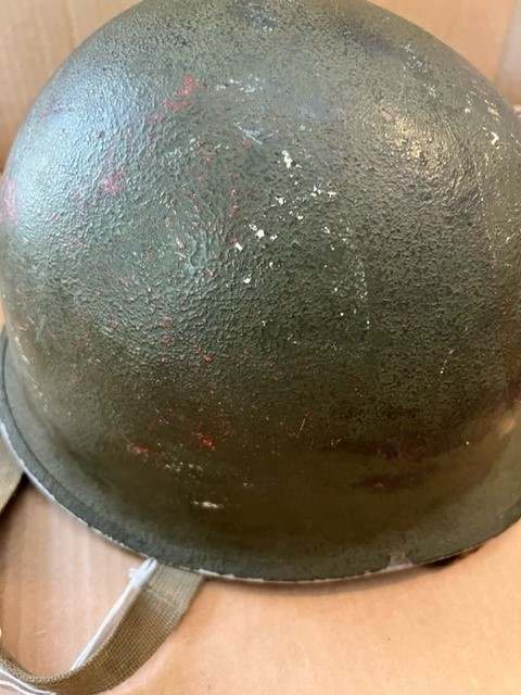

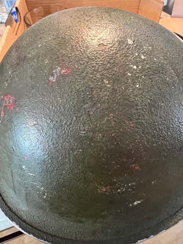

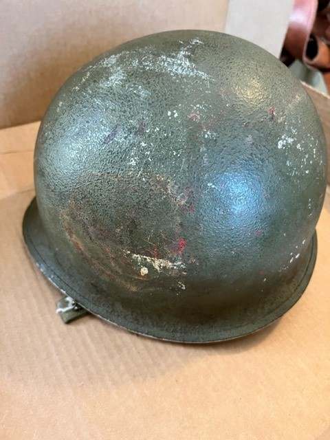

Recent gun show find, looks like a 3 panel medic FB.  I typically leave what i find as i found it but in this case I'm contemplating carefully peeling back a layer.
Thoughts?
tdogchristy90
I would leave it. No other reason than my gut feelings.
dhcoleterracina
It's a personal choice, lots of opinions on both sides. As for me, I'd be gently removing the newer paint.

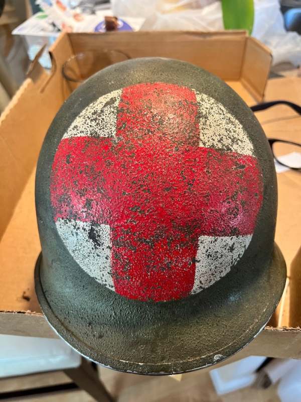

Well I bit the bullet, here is the progress thus far.
Most of the dark spots are remaining overpaint I’m not comfortable digging deeper into.   Some are raw metal from chips etc….
Very impressive! What chemical and technique did you use for the removal?
Removal started with goof off with virtually no effect, so I moved on to a paint stripper gel Qtips, paper towels and water and went very slowly on small 1 inch sections at a time.

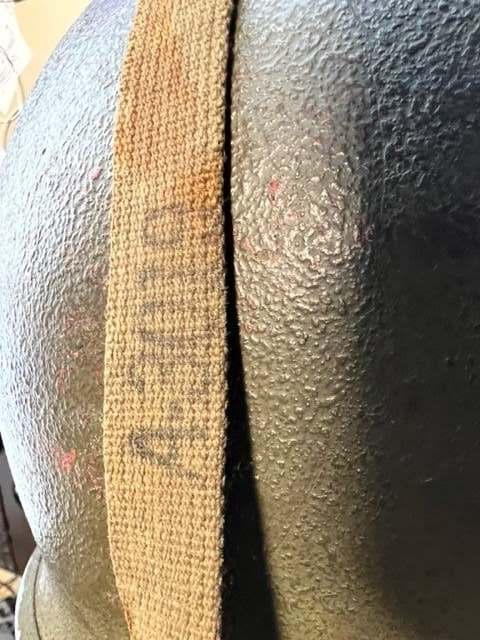

Here the strap and the heat stamp is 44B followed by a 3 off center and to the far right, not seen this before.

Excellent save, good for you.
Thanks guys, im going to leave the last panel as is, I think it best represents it as it is/was etc….

Very well done! My fear was misplaced.
Looks good, why not take the same approach with the other panels?
Keeping panel overpainted to show it as I found it, the other panel can always be cleaned up but I like the idea of showing the varied condition or life cycle of the helmet.
All McCord shells before lot 52 has an additional number, spaced, after the lift letter, like yours “44B 3”. Lot 44 would have been made roughly early December 1941. Would love to see more images of the shell, lot stamp, loops, both of them, rim seam and overall of the inside.
