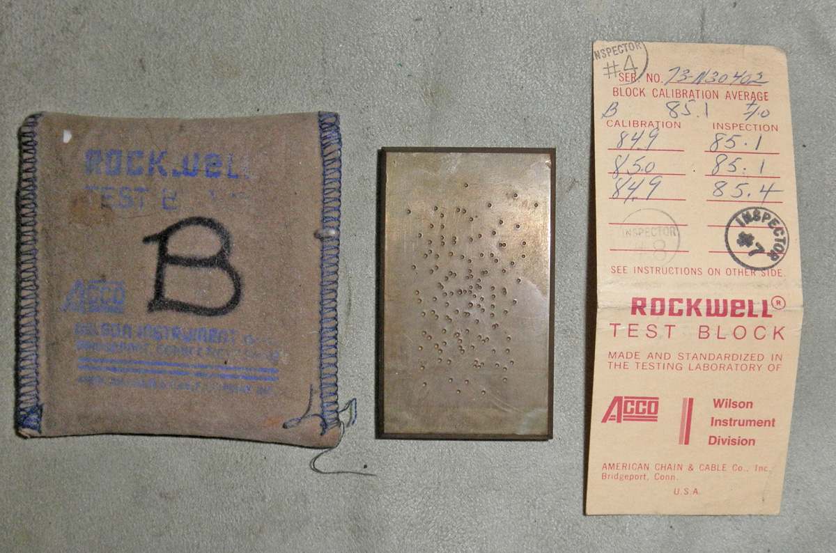

With the talk about hardness testing, I thought I'd throw up this Rockwell Hardness Test Block.  Individually serial numbered and calibrated for penetration into the block.  I'm assuming the punch for the test would be compared to a punch on the block to confirm the receiver or piece of metal is of the desired hardness.
Joe Occhiuto
I don't think the punch marks are compared to one another.   Based on my long ago experience with Rockwell Hardness testing I assume that the block is a known hardness against which the testing machine is calibrated.   Any markings or paperwork to confirm or refute my assumption?
You are probably right; while I haven't seen the testing machine or tool it would have to be one that exerts a consistent force on a punch.  Likely a spring loaded tool of some kind.
Joe Occhiuto
Yes,  I believe the test equipment applies a fixed amount of force and the depth of penetration is measured and inserted in an equation to compute the hardness.  The force is quite substantial, like in the 100,000 lb range.  This is based on my recollection from a long ago and passing exposure to Rockwell Hardness testing, so I would be happy to be corrected.
Woodymyster
Joe is correct.  The Hardness tester is a large press like machine.  The test block is to calibrate the reading on the machine.  The "B" indicates what scale the operator reads off the display.

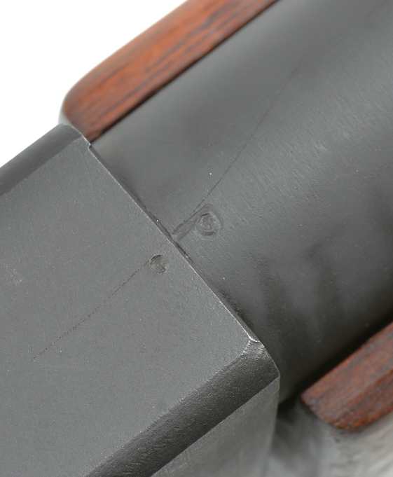

Similar punches are present on Thompson Submachine Gun receivers that have had barrel replacements, usually during rebuild, but also likely in the field.  I have attached an example photo.  I have encountered Thompsons with two punches, but I have not seen three.
