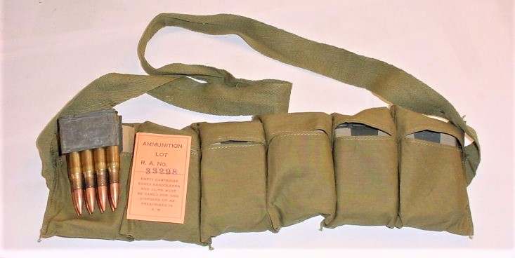

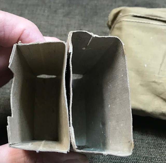

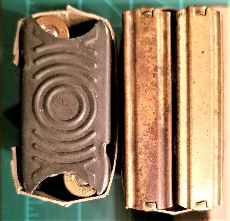

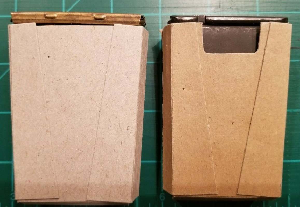

Your information is partially accurate. There were actually three variations of the enbloc cardboard sleeve. The bandoleer sleeve was the same height for the enblocs as it was for the stripper clips. Pre-war and early war the sleeves looked identical to the 5-round sleeves, but side-by-side comparison shows the enbloc sleeve to be slightly narrower.  Then mid-war a notch was put in the enbloc sleeve to make it easier to grab the clip. By 1945, when the lot card was discontinued in favor of printing on the bandoleer, the embloc sleeve was reduced in height.That shorter sleeve was used through the end of .30-06 production.
The first photo shows a Remington bandoleer from 1943, with the notched sleeves just visible in the pockets. The second photo shows a Frankford bandoleer from 1944 with the tall enbloc sleeves with cutout. The third photo shows a 1945 bando from St. Louis with the shorter sleeve and the last of the lot cards used. The fourth photo shows the early sleeve from a 1942 Denver bando. The last three photos show the differences between the enbloc and stripper sleeves.
Hope this helps. If you need any of these sleeves, I make replicas of both tall sleeves (shown in the last photo).

armysoldierant1944
Charlie

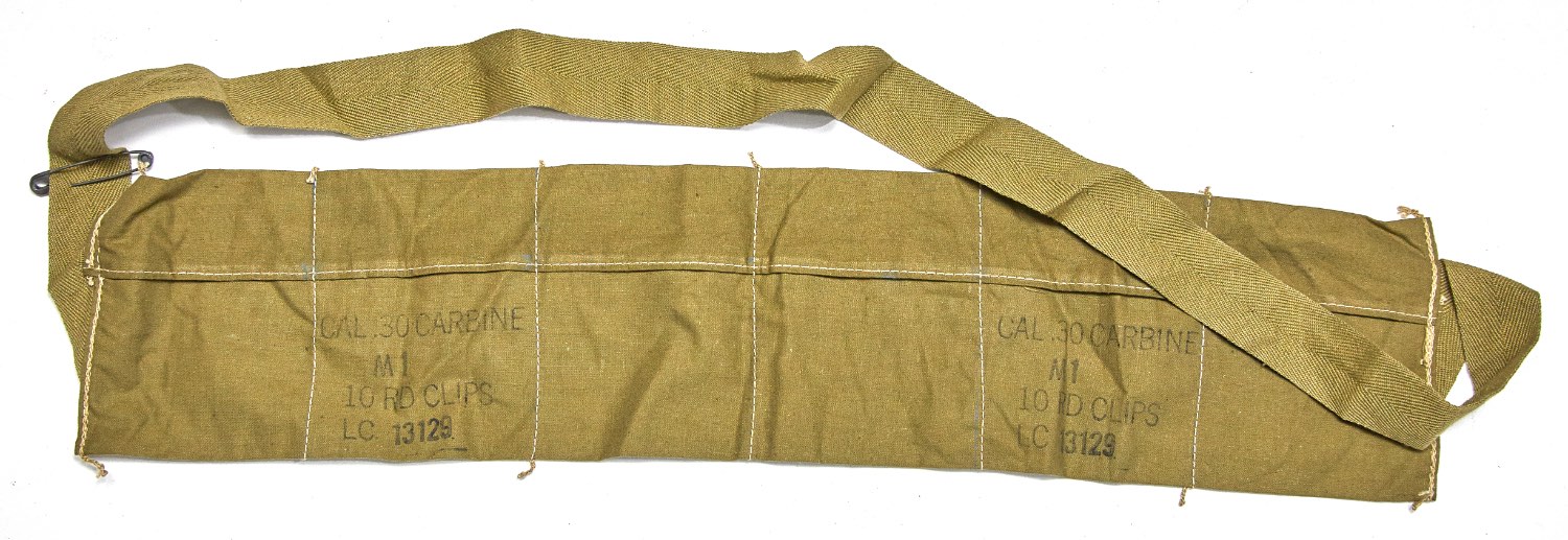

collector
So this would be Korea? I have another with 1952 date on it that is the darker greener green(OD #7), but this one has a color more resembling the WW2 khaki-like color (OD#3).
Link to post
silverplate
That's actually a bandoleer loaded with carbine rounds. Carbine ammo wasn't packed in bandoleers during WWII, that practice started with Korea. As far as the color goes, it could've been a wartime production that was left over then put in service for Korea when bandoleers were needed again. Also, the carbine lot numbers from Lake City ended at #12965 in 1945. That's a nice example!
