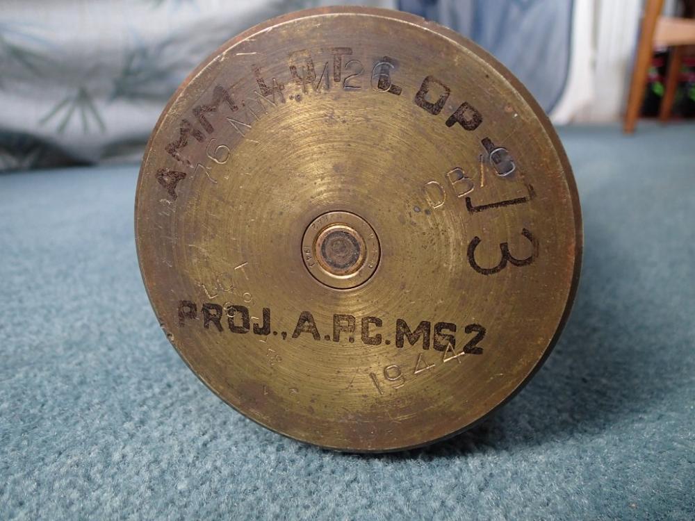

This is an example in my collection. It is not for sale but will provide you with your request to see an example.
Note that the projo is marked 3 inch and the casing is 76mm, which is the proper nomenclature to these WW2 APC rounds.
1 of 5
CCYOOPER, I believe yours is a navy 3" round, whereas the other is a 76mm army tank round....Yours has a nose fuse instead of a base fuse found on an APC ( armor-piercing capped) round....Bodes
Looking at it again, I think I see cross cannons on the bottom of your casing....That would denote army acceptance...The head is not an APC round though....Bodes

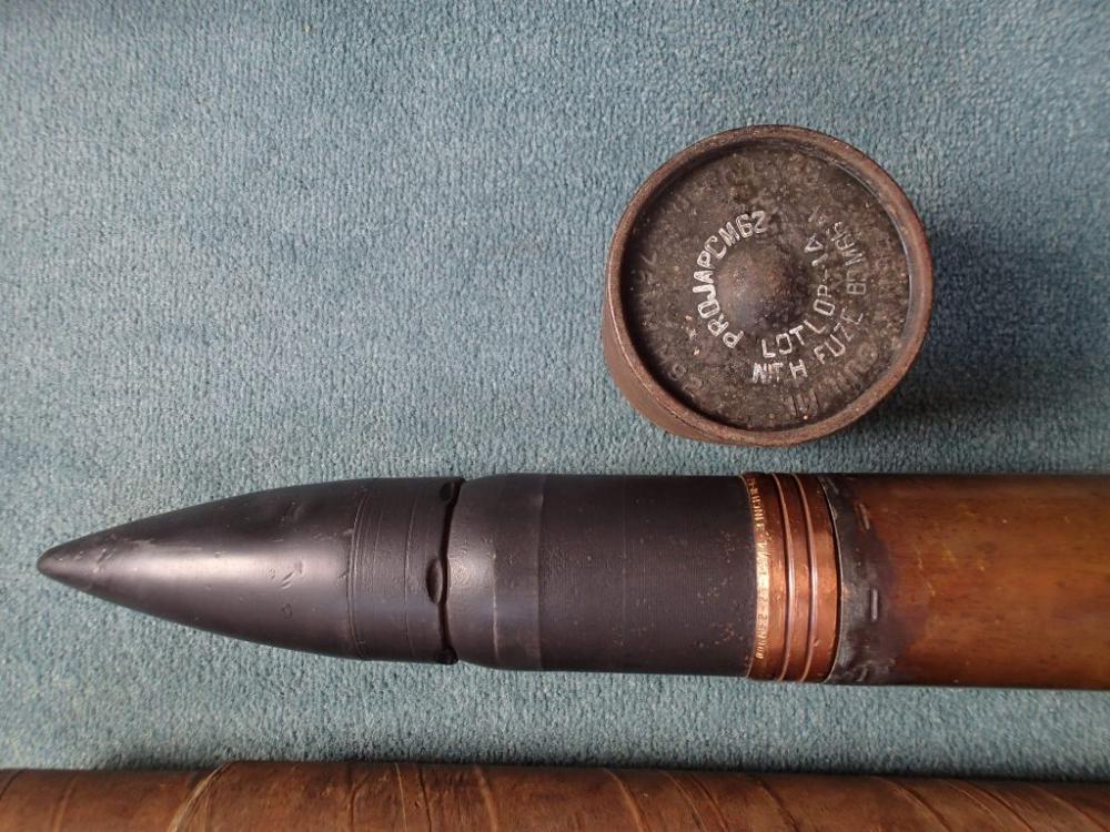

Here is another still in the tube.

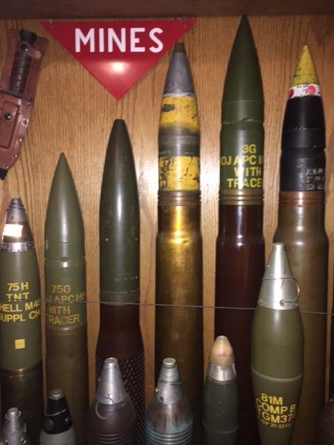

Your projectile looks like an M42 HE 3" but the casing looks odd- way to short. Here are my examples. L-R. 75mm Howitzer w/ M48 HE projo. 1944. 75mm APC M61 projo (w/ explosive filler) 1945. 75mm Recoiless 1945, 3" M42 HE 1941, 3" APC 1944, 3" / 50 Navy MK 29 AP 1942.

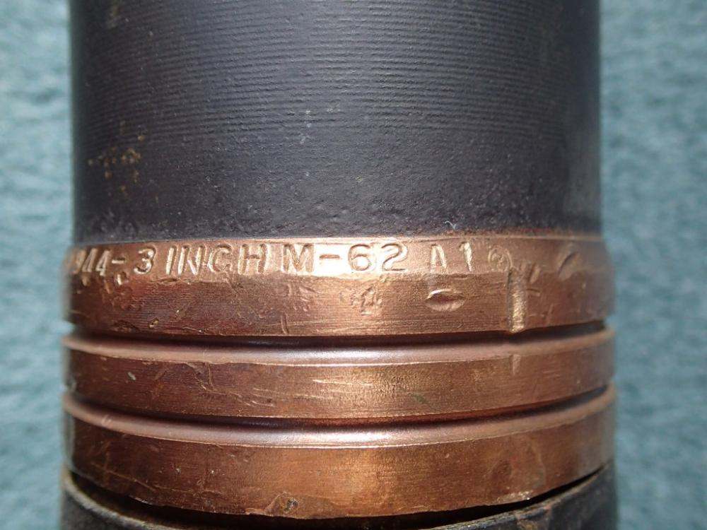

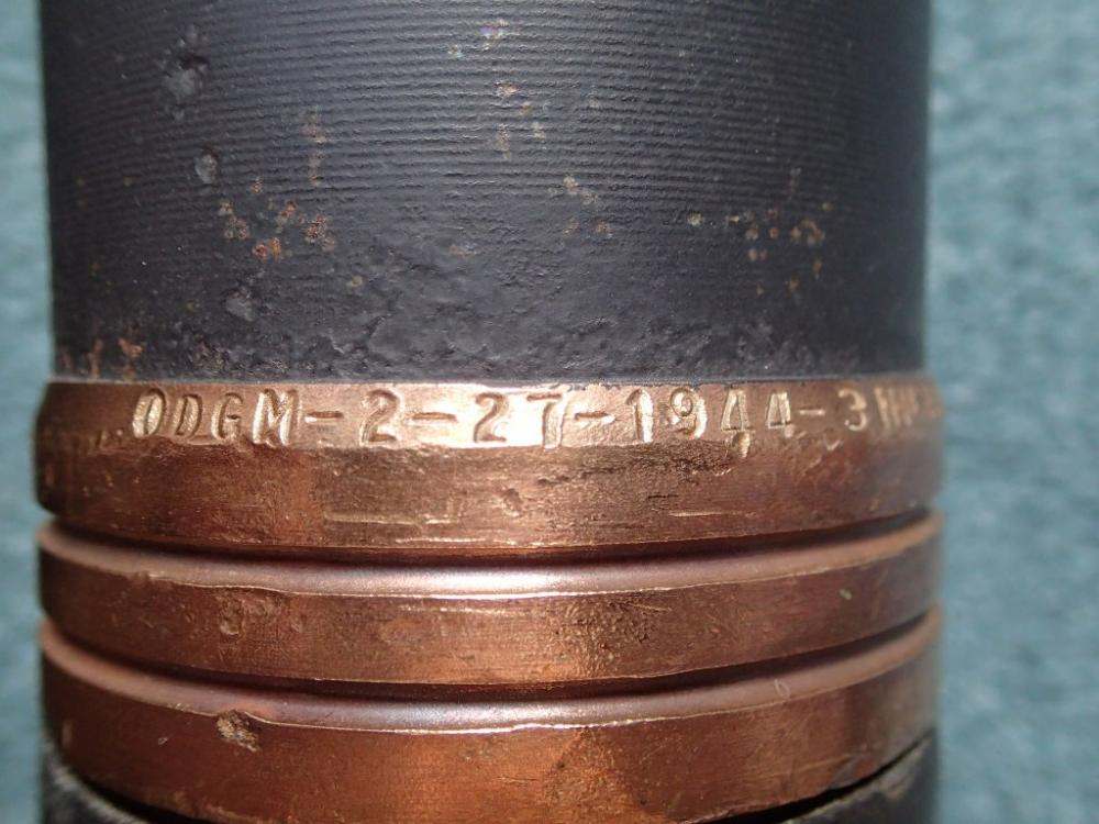

Lots of confusion in the 3" ordnance pieces. The Navy 3" has a different style driving band and different case, similar to the Army 3" but more rounded at the shoulder , also marked with an Anchor. Now the real confusion, the 3" projo ( M62) was loaded into two different style cases. The M26 straight case as Persian Gulf's example and the type in my collection. Both cases were made in both steel and brass. The proper terminology is 3", thus the "3G" inking on the projo. post-180924-0-55116500-1576033098_thumb.jpeg

The green shell on the right is a m71 90mm round. The other rounds are still in the tubes if you look closely. Unfortunately I dont have pictures out of the tubes on my phone now. They are black APC rounds
