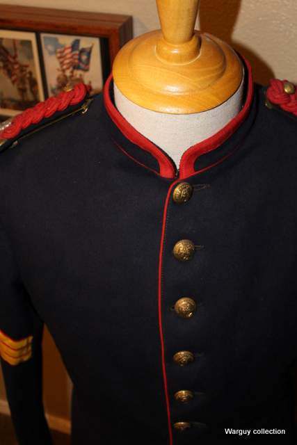

I recently grabbed this grouping and am quite happy with it. It is difficult to find Span Am Marine material, and a khaki tunic from that periord was needed to fill a gap in my Marine uniform pre WWII display. This tunic came with a fair amount of paperwork and photographs that identify the owner of the tunic as Perry Daubenfeld. Perry entered the Marines in 1901, rising to rank of Corporal in 1904 and was discharged in 1905. He led an interesting life, moving on to the Illinois National Guard where he rose to rank of Captain and then served as a Captain in WWI with the 132nd infantry. His service record with the Marines is recorded in some of the paperwork I received in the grouping as well as his muster records on Ancestry. He spent considerable time in the Philippines.
Here is the tunic that came with the grouping. I really like the tunic, it "feels" right. It has a nice set of period correct USMC Cpl. stripes (a little dingy from some old water stains) and a complete set of matching Horstmann back marked Marine brass buttons. I found a very faded and difficult to see name hand written under one pocket flap that the seller missed (he said it was un-named). I can just make out the first half of the name which "P Daub" which is a match. There are no other markings in the tunic.

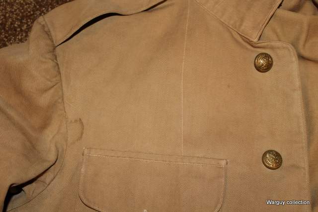

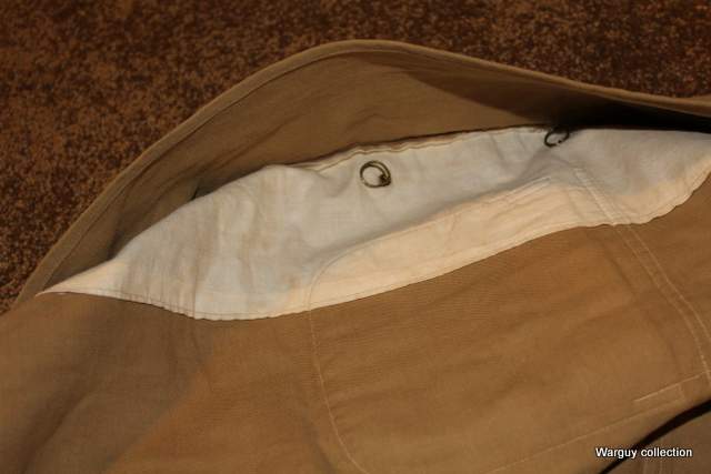

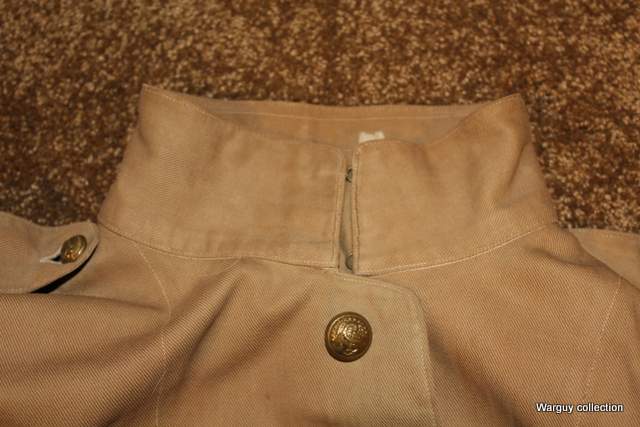

I'm not terribly thrilled with the photos that you've posted; the overall image is tiny, and there is no complete
view from the rear. I would have liked to see whether the rear "skirt" has two splits, or not. Moreover, I'd
like to see the internal stitching to determine whether it is machine (treddle) sewn, or hand finished; and
a better view of the collar laying flat.
Because he served in the Philippines it is possible that this blouse is a personal purchase item from that
source, or British Hong Kong; better detailed photos could confirm or eliminate that possibility.
Your coat lacks the two welted gore seams that run from the collar to the upper pockets (see photo in your
post #3). This detail to USMC clothing can be found on the enlisted summer service coat (khaki) starting
with the 1904 pattern. The earlier 1900 pattern, which I believe yours to be, did not have this feature.
The 1900 pattern had two rear vents (also found on later patterns); a slightly rounded standing collar (I can't
discern this detail from your photos), whereas the 1904 pattern and later had a square standing collar; five
domed gilt brass buttons down the front.
What I am seeing seems to be consistent with a 1900 pattern enlisted summer service coat (khaki).
Whether foreign made, or domestic, it is a highly collectable prize for your collection. Kudos!

Hey thanks to all for chiming in. I was really hoping to see some intelligent discussion on this subject, and I am not disappointed. WWI nerd, I was also hoping you would show up and thanks for posting the photos. I actually saw these images when researching the past week. Dirk you are always a welcome visitor to any thread I post and always appreciate your input.
Msn, thanks for your comments as well. I thought I got the most prominent aspects photographed, but can see quickly I fell short. I will take some additional shots and post them by tomorrow evening (my Sunday was unexpectedly busier than I thought). Thanks for weighing in on your assessment of a possible 1900 pattern tunic. I will say that there are no vents to the rear of this tunic. I also read your thread from some time ago about the Hong Kong or British made army tunics of this time period and there is no internal belt in my tunic so I know it is not one of those. Finally, with regards to the rolled collar, my tunic definitely does not have one. I am familiar with that feature as I have a couple Marine tunics (blue wool ones) with rolled collars. As I indicated in the original post, I also possess a very interesting USMC blue wool tunic with a straight standing collar and a 1898 paper QM label sewn inside. This came from the Greg Beck collection (Greg’s collection was prominently photographed in Alec’s Equipping the Vorps volume 1), and he said at the time I purchased this uniform that it might appear in Alec’s next book. I think it is a key piece as it definitively answers the question on when the Marines went from the rolled collar to the straight...1898. Obviously Marines in the field probably wore their rolled collars until the uniform wore out, but I would imagine that tunics produced by the Marines from 1898 on likely had the straight collar. Just my assessment I guess. Thanks to all again for taking the time to help me out. I will definitely post more photos by tomorrow night. Kevin

As promised some more pics of this tunic:
