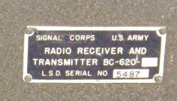

Does anyone know how to date a BC-620? I want to buy one buy only have photos. Not sure if I can pull date from the serial number? Thoughts?
Did, can you open it to look inside?
stealthytyler
No, i have not purchased it (yet).
The LSD stands for Lexington Signal Depot. A post WW2 rebuild facility. So it's a WW2 radio but rebuilt post war.
stealthytyler
So if I understand you clearly, this radio was built in WWII and might have seen wartime service but was then sent to LSD to be reworked and rebuilt? Did LSD rebuild for the military or for civilian use? Thanks!
Rebuilt for military use. Then later on sold as surplus. Many times they are also repainted but not in the original crinkle OD paint. More of a smooth slightly shiny OD.
