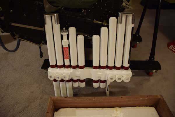

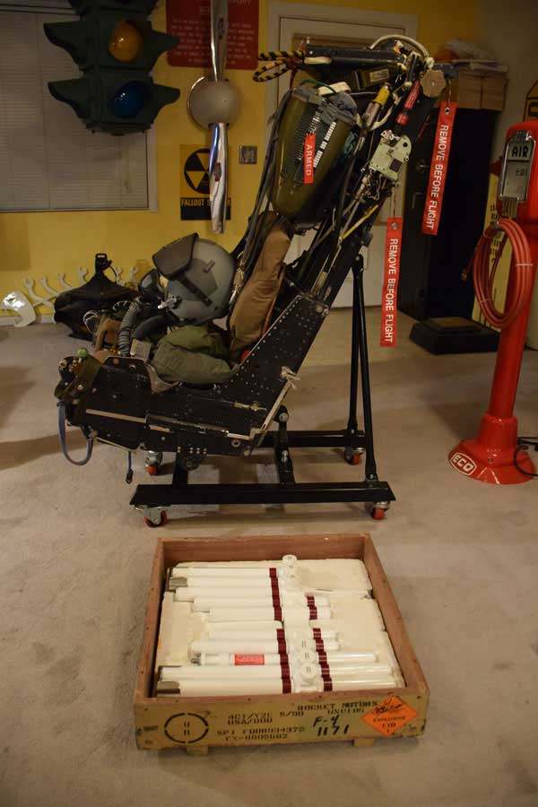

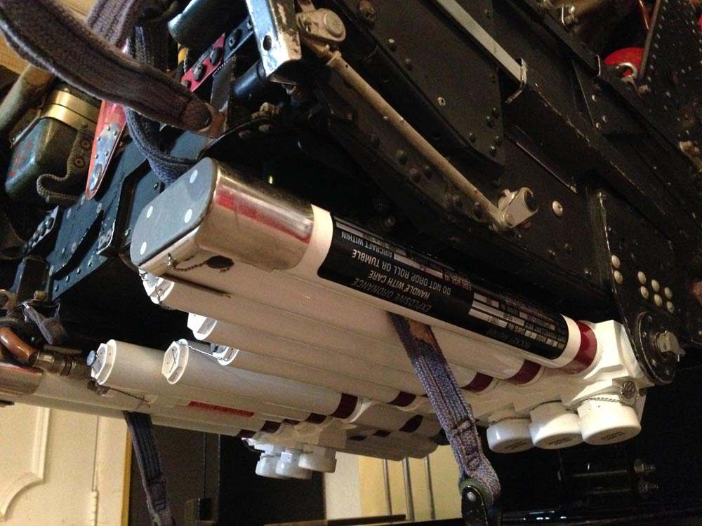

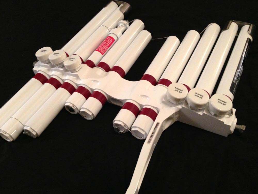

After a long search I was able to obtain a MK 92 under seat rocket motor for my Martin baker MK H7 Ejection seat. This seat flew in the F-4 Phantom. After I put the lock wires on the motor I will install it on the seat. The motor weighs just about 21 lbs. The tubes are empty so it is inert. Originally it contained 6.5 lbs of solid rocket fuel which made it weigh 27 lbs before it was shot out of a jet during an ejection.
I added the lock wire to the rocket motor today. I have to wait until it is under the seat to wire the leg guards. The left and right leg restraint cords must be slipped down between tubes 1 & 2 and tubes 9 & 10 first,
northcoastaero
Nice USAF F-4 ejection seat and hard to find rocket motor. What is the tail number on your seat? Is it a fwd or aft seat? The seat looks to be in 1980s-1990s
configuration. The earlier MK-H7 seats had a cable firing assy. on the under seat rocket motor instead of gas. The MK-H5 seat was replaced by or upgraded
to the MK-H7 in 1968.

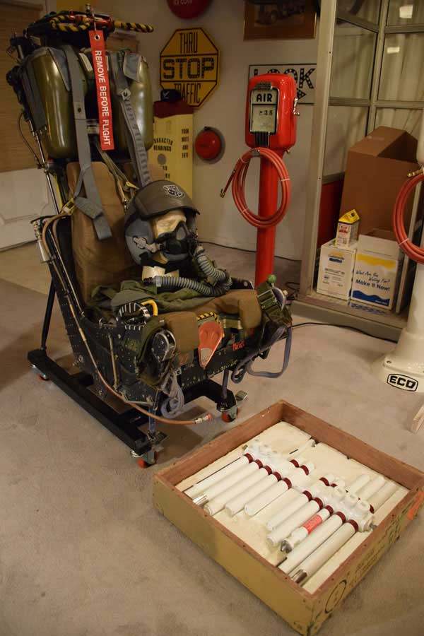

I purchased the seat about 7 years ago from a TSgt who worked at Eglin AFB. He said it sat in his dad's bar for a few years. Over the years I added some missing parts the biggest being the cat tube and now the rocket motor. I would like to find the two little brackets that the leg restraint cords attach to. These would have been bolted to the aircraft floor. The top latch plunger and spring were missing but I found one and it is on the way to me. I have the brass top latch hand wheel tool so now I will be able to attach it correctly. Three months ago our last manned QF-4 here at Tyndall AFB was flown to Holloman AFB. The last 2 unmanned QF-4's were flown out over the gulf and one was intercepted by a jet from Homestead and shot down and another jet from Eglin did the same for the other drone.
I just re-claimed my fully restored Navy/Marine version H-7 ejection seat from an unnamed aviation museum where it had been on loan for 22 months. While it was there, my pristine MK92 rocket pack seemed to have grown legs and walked off the premises! I'm dying to know - where on earth did you score such a perfect MK92 in the original shipping case?

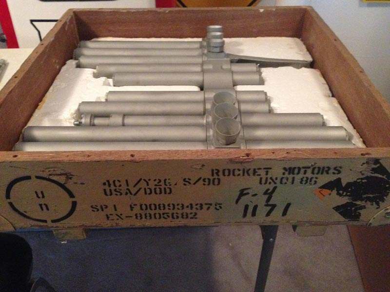

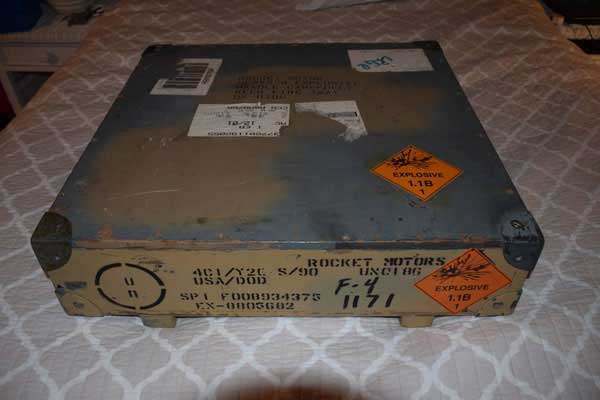

That's really bad for a museum not to protect something on loan. I'll bet you were sick when you saw that missing. I hope they can help you replace the motor. My motor came from a friend in Tucson AZ who purchased it from AMARC in the early 90's. It was unpainted and had a few tubes dented from a hard landing. I did the body work to fix the tubes and then painted it with PPG automotive urethane products. The decals are copies of ones done by another enthusiast. The shipping box came from the same friend. While visiting the egress shop at Davis-Monthan he spotted a couple of the boxes in the dumpster and was allowed to retrieve them. It makes a cool display for the motor. Here are a couple of photos of the motor when I received it.

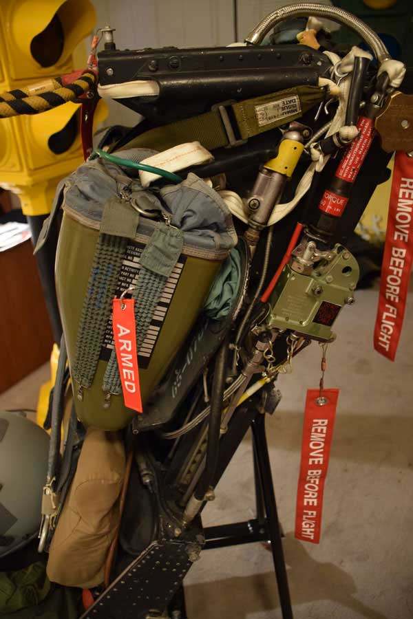

Very nice. How do you get the parachute container to look in such good condition? Shiny!
