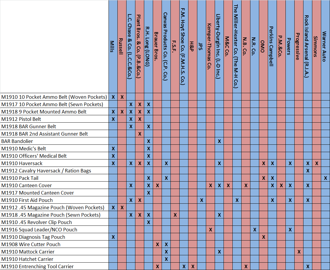

Mitter2k1 Posted September 14, 2014 #1 Posted September 14, 2014 I started this project quite a few months ago and put it aside at the time. I have recently picked back up on it and need some assistance from the very knowledgeable members of the forum. Basically, I am compiling a list for my long term goal as a collector and that goal being to have 1 belt, haversack, first aid pouch, canteen cover, etc. by every manufacturer during the wartime years. So far I have a few manufacturers that are abbreviated and hope that someone can ID them. I will update this new ones I don't know as I come across them. M1910 Canteen Covers marked with M&C Co., P.M.&Co. M1910 First Aid Pouches marked with The M-H Co. (The Miller-Hexter Co.?), JPS M1910 Entrenching Tool Covers marked F.M.H.S. Co., H&P M1910 Haversacks marked L-D Inc. Thanks in advance, Mike

Mitter2k1 Posted September 20, 2014 Author #13 Posted September 20, 2014 Ok, here is what I have so far. I'm sure I have some errors within the document, but I am still gathering data and revising. Also, I think the company I have listed as N.R. Co. may be N.B. Co. with part of the letter missing on the stamp. I haven't been able to find N.R. Co. anywhere else on the internet. I have the tool carriers listed as M1910 since I couldn't find anything else that said otherwise. So, if anyone has any additions, edits, criticism, ideas, etc., LET"S HEAR IT! Most of the information gathered is from what I could find on the forum, on dealer web sites and eBay. If an item did not have a clear stamp, I passed on it and continued on. Any addition assistance would be greatly appreciated in helping me complete this project. When it is finally finished (If that is possible), I hope to share it on the forum and with collectors everywhere as a checklist of known war time manufacturers of WWI era US Army equipment. Thank you, Michael M.

Mitter2k1 Posted October 14, 2014 Author #20 Posted October 14, 2014 Alright, I have searching high and low and this is what I have currently. I have added a couple of pieces of field gear and some manufacturers to the list. Hopefully I have ID'd the wartime manufacturers of just about all the field gear I can think of. If anyone has any additions or edits that need to be made, please let me know. I want this to eventually be a simple tool that collectors can use to ID WWI wartime made items. Thanks, Mike
