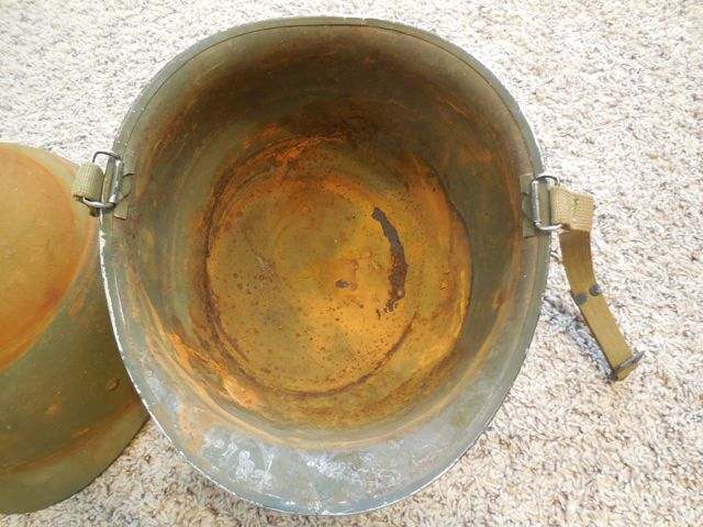

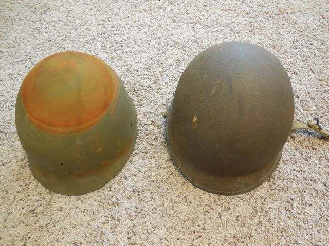

Catfishcraig Posted July 19, 2014 #1 Posted July 19, 2014 I picket this helmet up recently and it has rust on the inside of the helmet shell and on the liner. From the past posts I've read I'm going to try and use a WD-40 and a bristle pad on the outside of the helmet shell. Any suggestions for in inside of the shell and the top of the liner? Thanks Craig

Catfishcraig Posted July 19, 2014 Author #3 Posted July 19, 2014 Please read this thread first before you make the mistake of using WD-40:http://www.usmilitariaforum.com/forums/index.php?/topic/45336-oiling-your-helmets-other-helmet-preservation-misconceptions/ The proper product to use to remove rust stains is: WHINK, which can be found in most hardware stores. Thank you. I missed this one somehow and will scrape the WD-40 idea. My intent is not so much to alter the look of the helmet but to get most of the surface rust off. I would like to put a salty WWII USMC cover on it that already has a few rust stains of its own, I just don't want to make them worse. Craig

GeneralCheese Posted August 1, 2014 #6 Posted August 1, 2014 I have a liner just like the one the OP posted, will WHINK work on it, or is it just for the shells?
coolhandluke Posted August 1, 2014 #7 Posted August 1, 2014 I have a liner just like the one the OP posted, will WHINK work on it, or is it just for the shells? Ben, I used Whink on the liner that came out of the shell in the photo above. It was in nearly identical condition to the OP's and all rust stains were successfully removed. I used a rag saturated with the solution and lightly wiped the affected areas. There were traces of paint on the rag afterwards but it was very minimal. The paint on the liner was original, so I cannot say how it may affect a liner with overpaint. The only article that I have had adverse affects using Whink on was a rusty M1 Carbine magazine. All traces of the finish on the magazine were removed within seconds of being submerged in the solution.
