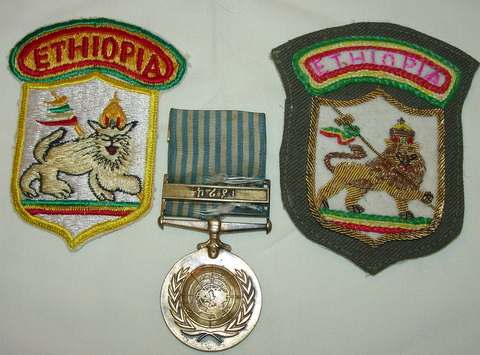

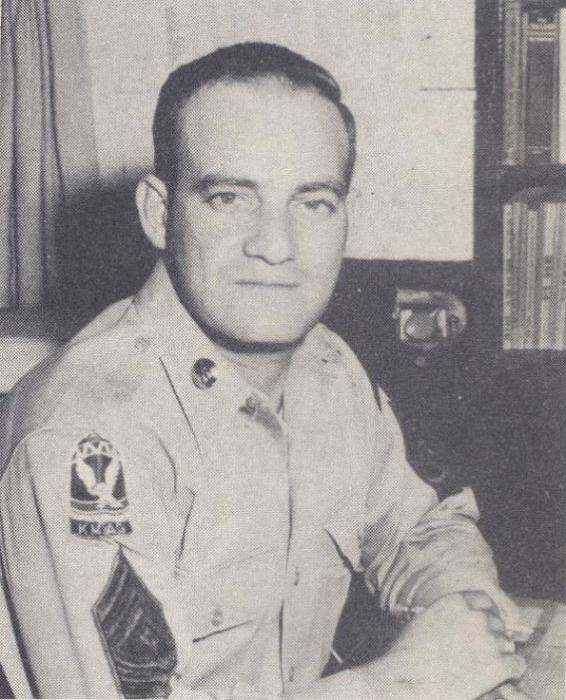

Korean Military Advisory Group. I'm not sure how obscure this one is, but I wouldn't think it is very common. I think the unit was re-designated or absorbed into another unit right after the Korean War began.

The Closest patch that I can find a match for would be Ethopia's Kagnew Battalion. If it is the Kagnew patch it most likely was a honorary thing, the Kagnew battalion was at one time or another assigned along with it's parent U.S. 7th Infantry (Bayonet) Division to IX Corps
