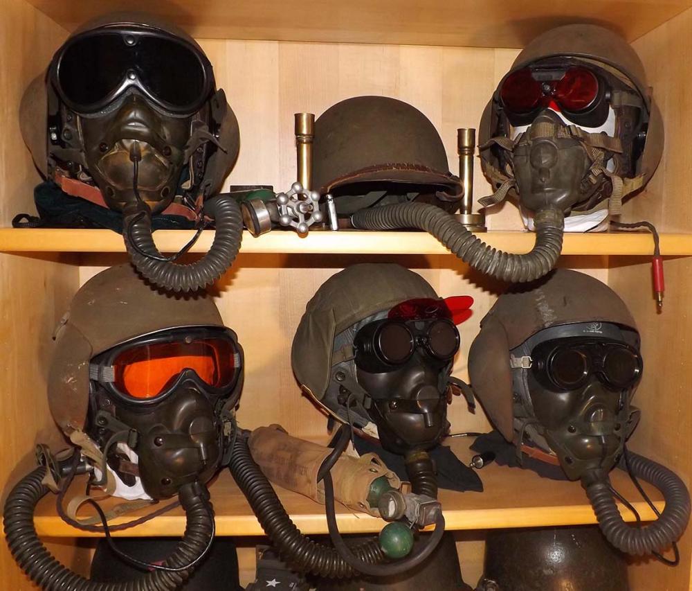

The Rooster Posted November 4, 2019 #6 Posted November 4, 2019 Heres some displays I have with a11 and a13 helmets
AZPhil Posted November 4, 2019 Author #7 Posted November 4, 2019 Thank you Guy's , I'll see if there are any photo on the 447th webpage for that time frame and see what B17's they were flying in January.. I think I know what you are talking about for the O2. One was constant flow and the other was regulated , Correct?? Those visual are awesome Rooster! Excellent collection Sir!!! Thanks All Semper Fi Phil
