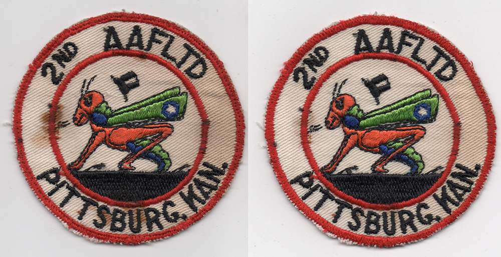

On the finished scan, it appears that the blue ran into the white border on the left hand side, That was just the damp threads sticking straight up. No dyes bled into others.
Here is a better scan of the patch after it has dried. About a week later, I smelled the patch and it has that old attic foot locker smell to it. No lemon (I let it soak in water baths around 4x to remove the lemon and salts).
Question: Do you think the white came out too white for a restoration process? Still better than the rust obviously.
I don't think it came out "too white".. it's the correct white we just aren't used to seeing a patch so clean (I think).
I think it looks boss.
I guess it's a possibility that a tiny amount of the blue leeched into the white thread, which would actually (to the eye) make the white look "whiter".

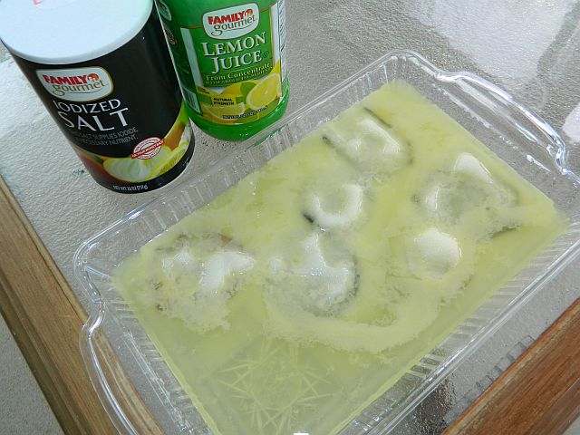

When sitting in the sun, it is still in lemon juice with salt on it. I have found that the lemon juice really just needs to be 4-5mm more than the patch. And then put a generation pile of salt on top of the stains. Not huge, but enough to come out of the water. Every 2-3 hours I go back and put more salt over the rust as the lemon juice takes it away in solution.

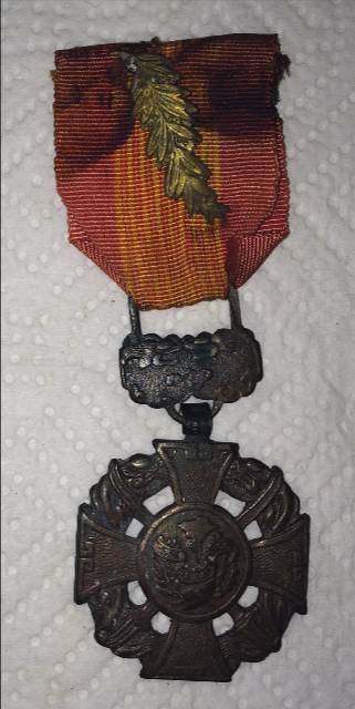

Here is my try. As you can see in the first photo, this VN Cross of Gallantry was improperly stored and the steel pin-back rusted and bled through the ribbon. I soaked it in the lemon juice and salt for 24 hours and then let it sit in the sun for about 5 more hours. The results are mixed. Something I didn't pay attention to was the pendant. At some point it fell into the mix while I wasn't around. It probably sat in the solution for 20-30 minutes until I came back to check on it. Even though I rinsed it and wiped it down, you can still see the verdigris and the lighter patina.
The rust weakened the ribbon, almost making a straight cut on the back where the ribbon was in contact with the pin. While I considered this medal a loss when I started, I think the results turned out fair. However, I would be much more careful with this thin of material, keeping it under close observation.

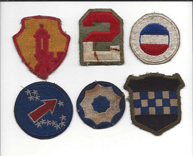

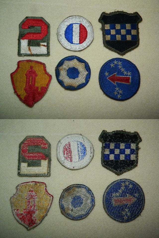

I've been wanting to try this technique myself and I finally got around to it today. I picked six soiled and stained patches for treatment. I'm using the same procedure as outlined above. Being winter in Ohio there's not a lot of direct sunlight right now. So that may affect the outcome, we will see. I photographed them before and under a UV light. This is going to be a long soak out on my patio. I'll post my results in a few days.

This is after 48 hors of soaking in a lemon juice and salt bath. Not much change unfortunately. I think the missing element is the sun. Unfortunately we don't have much sun right now. I'm gonna give it a try in spring.
