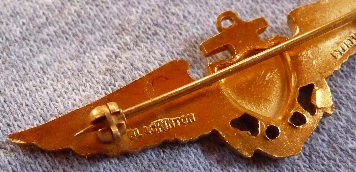

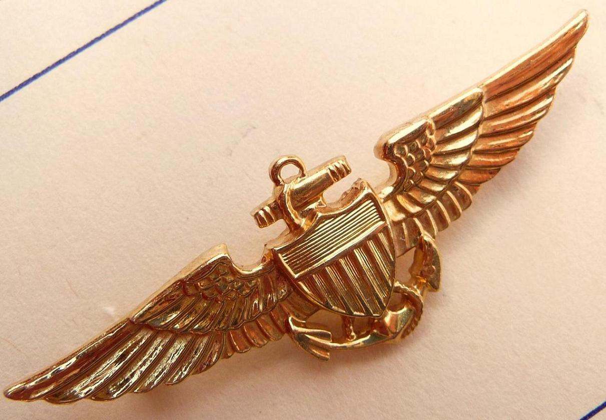

Navybob Posted April 23, 2010 #14 Posted April 23, 2010 Since it's Show~n~Tell Friday, I'm sharing a wing I picked up some time ago. Un-issued on a Pasquale card. Have a great weekend!
pconrad02 Posted April 23, 2010 #16 Posted April 23, 2010 Great wing! Can you show the back? With all the issues with this brand ( on non Navy wings) I would love to see the hallmark. Paul
pconrad02 Posted April 23, 2010 #18 Posted April 23, 2010 You don't really need two do you :whistling:
CliffP Posted April 23, 2010 #20 Posted April 23, 2010 What a terrific badge, and from this vantage point it helps to confirm that only V. H. Blackinton made the wing badges that were sold by Pasquale Company, San Francisco. Three thumbs up for that one. :thumbsup: :thumbsup: :thumbsup:
gparlin Posted April 23, 2010 #21 Posted April 23, 2010 Over the years I have seen many different Navy wings. This is the first time I have seen this wing, with a drop catch, and on a Pasquale card - WOW – impressive. This is one of the reasons why I just love the Forum, folks sharing their collections and interests. Gregg
bschwartz Posted April 25, 2010 #22 Posted April 25, 2010 This is a hell of a find but I'm partial to Blackinton wings so I always love seeing them. I have a full size Blackinton Naval Aviator wing but the 1/20th 10k GF marked is excised but the Blackinton is still clearly visible. I love the wing. Mine is a clutch back.
Wiendolch Posted April 25, 2010 #23 Posted April 25, 2010 That's about the nicest wings i've seen and looks like they are one rare bird not to mention they are in mint condition with the original card man you must be very happy with those wings Bob.

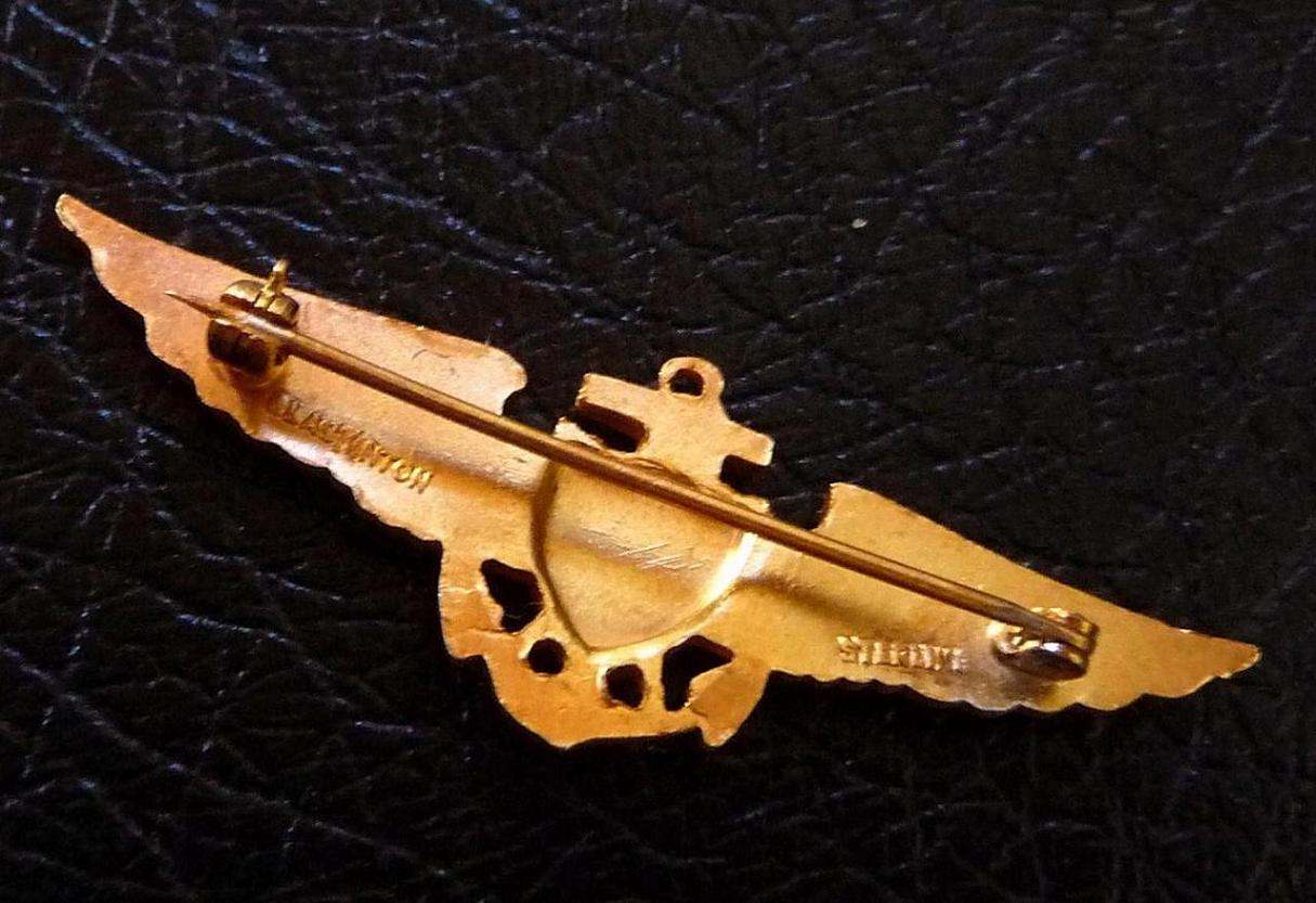

pfrost Posted April 26, 2010 Author #24 Posted April 26, 2010 That's about the nicest wings i've seen and looks like they are one rare bird not to mention they are in mint condition with the original card man you must be very happy with those wings Bob. Hello, Are these the smaller 2 inch wings or the larger regulation size wings? Reason I ask is that I just picked up a pair of the smaller 2 inch wings, but I have never seen the regulation size Blackinton marked USN aviator wings. Nice! Patrick
bschwartz Posted April 26, 2010 #25 Posted April 26, 2010 You have now! Click here for the link to my full size wings on my site. I'll try to get better pictures in the future. The 1/20th 10k has been excised because I think this is just a base metal wing but you can clearly see the raised Blackinton mark.
