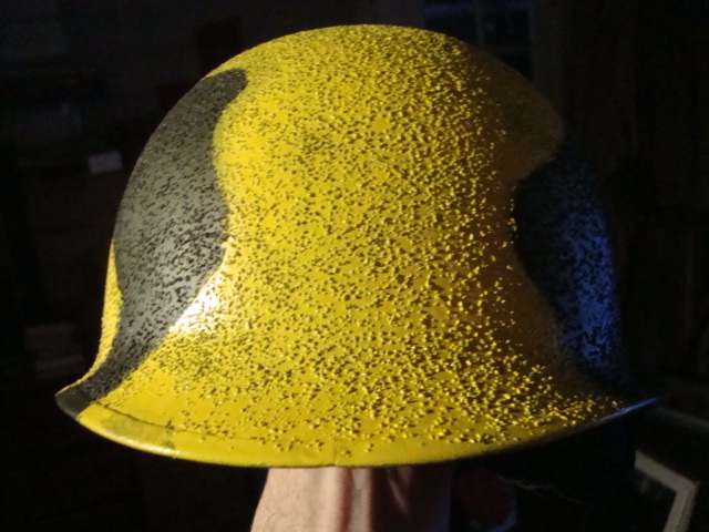

BILL THE PATCH Posted January 12, 2011 Author #28 Posted January 12, 2011 , i hope to get better at this as time goes buy. maybe i can save some old rust buckets for the future.
1canpara Posted January 12, 2011 #29 Posted January 12, 2011 Nicely done Bill! If this is your first attempt at a restoration/preservation, all I can say is :bravo: What was your method for applying the cork? I have a battered old rust pot I thought I would attempt a restoration on and was thinking of a wine cork and a cheese grater....but if you have a better method I'd love to hear about it... Anyway, great job! Congrats! Rick

DeuceGI Posted January 15, 2011 #42 Posted January 15, 2011 What was your method for applying the cork? I have a battered old rust pot I thought I would attempt a restoration on and was thinking of a wine cork and a cheese grater....but if you have a better method I'd love to hear about it... Not the OP, but I had some success by using a wood rasp to reduce a cork held in a vise. Once I had a pile of cork debris I screened it to rmove the big pieces and the dust. I made a shaker out of a plastic bottle with a lid and shook it over my helmet after I sprayed a wet coat of paint. Once dry I oversprayed about a dozen more color coats. I've also read that crushed cork is available via model railroading retailers, but I was not able to find ant in my area. HTH To the OP: NICE save! Tim

fallschirmjager Posted January 20, 2011 #45 Posted January 20, 2011 Bill Very good work. If you want some advice, use finer grade cork and try and spread it more evenly, I do it by sprinkling small amounts with my fingers at a height so it falls gently onto the paint. Allow to dry and paint another coat of OD over this. Leave to dry a good few days and then sand down with fine grade sandpaper. Then paint OD again. This way you get the original 'flat' effect as the originals had. At the moment the cork on yours is just a little to proud. But I love the metal glue you use, does it dry like metal or is it indeed metal? p.s. no chinstraps being added? Mike
