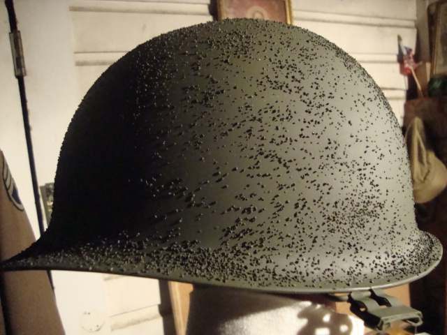

BILL THE PATCH Posted October 11, 2010 #1 Posted October 11, 2010 WELL HERE IS THE McCORD HELMET I RESTORED LINER CAME OUT WELL ALSO. I'LL LET FORUM MEMEBERS DECIDE. LET ME KNOW

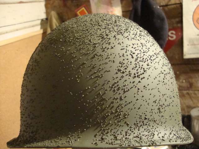

BILL THE PATCH Posted October 11, 2010 Author #4 Posted October 11, 2010 THERE WILL BE A COUPLE OF TOUCH UPS WHERE THE CORK IS NOT AS HEAVY, BUT YOU GET THE IDEA.
ww2_1943 Posted October 11, 2010 #11 Posted October 11, 2010 The color looks good. What paint did you use? You have the right idea on the cork. This is not to be critical, but the pieces you used are too big. When I cork my helmets I used fine grain model railroad ballast. It is just fine ground up cork. I then take some sand paper to in to flatten some of the Sharp edges and knock off loose pieces before I apply a final coat of paint. I used an original helmet as a guide.
BILL THE PATCH Posted October 11, 2010 Author #12 Posted October 11, 2010 The color looks good. What paint did you use? You have the right idea on the cork. This is not to be critical, but the pieces you used are too big. When I cork my helmets I used fine grain model railroad ballast. It is just fine ground up cork. I then take some sand paper to in to flatten some of the Sharp edges and knock off loose pieces before I apply a final coat of paint. I used an original helmet as a guide. I USE CORK BOUGHT RIGHT FROM J MURRAY INC, THEY SPECIALIZE IN RESTORING WW2 HELMETS. I DID NOT USE SAND PAPER AS OF YET CAN YOU SHOOT ME A PIC OF A WW2 ORIGINAL PAINT JOB WITH CLOSEUP'S. THAT WOULD BE A GREAT HELP.

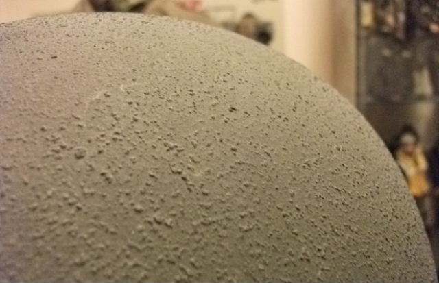

Sabrejet Posted October 11, 2010 #16 Posted October 11, 2010 I've got a couple of mint WW2 M1s which I'd be happy to photograph for you..unless another forum-er gets in first! Ian

Sabrejet Posted October 11, 2010 #19 Posted October 11, 2010 Here you go Bill. This is a close up of an unissued WW2 M1...should give you an idea of the grain and distribution of the cork. Ian :thumbsup:
