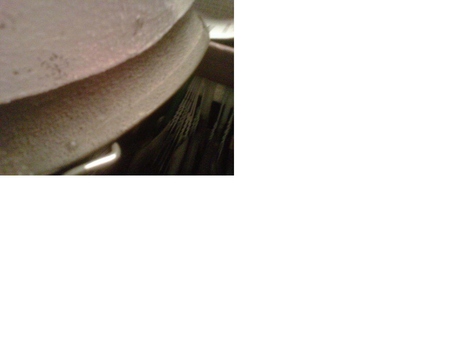

I USE CORK BOUGHT RIGHT FROM J MURRAY INC, THEY SPECIALIZE IN RESTORING WW2 HELMETS. I DID NOT USE SAND PAPER AS OF YET CAN YOU SHOOT ME A PIC OF A WW2 ORIGINAL PAINT JOB WITH CLOSEUP'S. THAT WOULD BE A GREAT HELP.
Saberjet posted a good pic. Maybe it is just the shadows being cast from the cork. The best I can do are cell phone pics.
This is an original McCord front seam. The paint is original, but the MP markings are not.
This is my first helmet attempt. I need to strip and do this one over, but it shows the cork I used.
sorry for the bad photos
