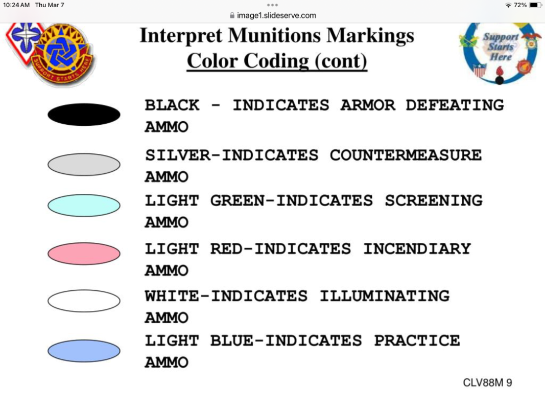

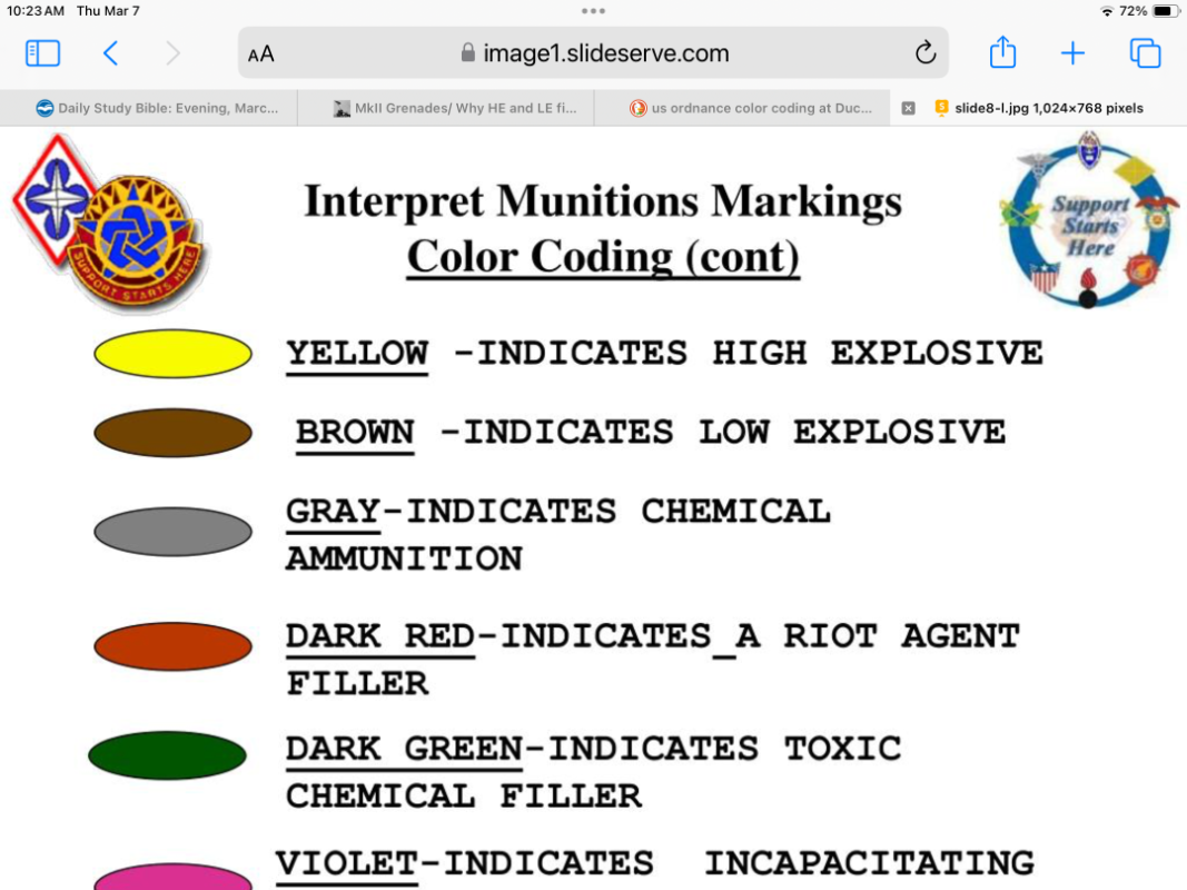

917601 Posted March 7, 2024 #7 Posted March 7, 2024 The US ordnance color coding was just being developed prior to WW2. It wasn’t totally standardized till the 50’s. Here is where we are today. Note the color Gold or Bronze isn’t listed but Gold colored ( I have a Gold colored WW2 81MM projectile and a Gold colored 155mm M121 VX shell dated 1991) signifies a complete round with NO energetic ( explosive) compounds loaded. Used for assembly/ disassembly, instructional, ammo feeding/ cycling/ loading drills. By today’s standards, the yellow stripe on the flash powder filled MK II’s neck would be incorrect as the flash powder is not HE. Today, most black powder filled ( low order explosive) ordnance will have a Brown stripe. An example would be the spotting charge inserted into a practice bomb. While the bomb itself would be blue, or a blue stripe, ( training- concrete or water filled) , the black powder filled signal casing would have a brown stripe….another example are modern era Practice grenades, they had a Brown stripe on the neck, the body Blue, indicating it had a black powder spotting/ noise charge inserted into it.

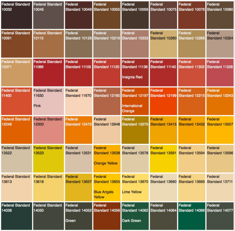

917601 Posted March 7, 2024 #8 Posted March 7, 2024 Also, do realize if doing “ restorations”, all these colors have a Federal Standard color, eg “F.S. XXXXX”. Most restorations when painted never look “ just right” to the trained eye because common rattle can spray paint was used. The FS paints are meticulously mixed, all the same. Testers modeling paints ( Hobby Lobby) have correct colors mixed up to the Federal Standard ingredients. For example, three , four different OD Greens were used in WW2. eg… Grenades had a specified FS color and number, Jeeps another, aircraft insignia, really fascinating on some WW2 colors….the regs actually stated by percentage the ingredients ….India black x percent, varnish x percent, linseed oil x percent, and keep in mind all the paints of that era were lead based, not acrylic or polyurethane based rattle can colors of today. A trained eye can tell the difference by color, hue, texture ( sprayed, painted by brush, etc) , the study of the paint technology of that period is fascinating.
917601 Posted March 7, 2024 #9 Posted March 7, 2024 More to illustrate the rather complex color coding system.
