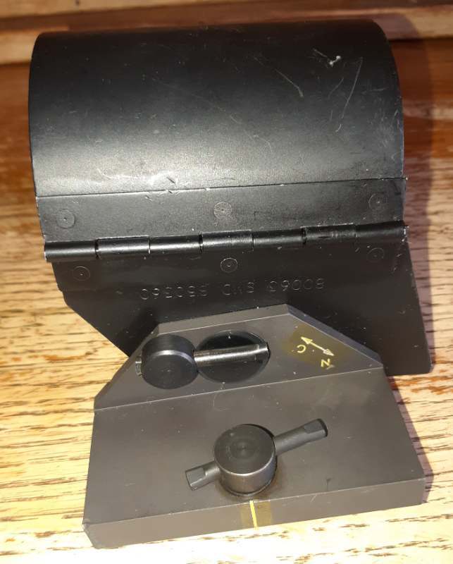

I was hoping someone out there could help identify this item. I have no clue what it is and what it's used for. I think it's a mount for some kind of scope??? The top of it is hinged and opens up.

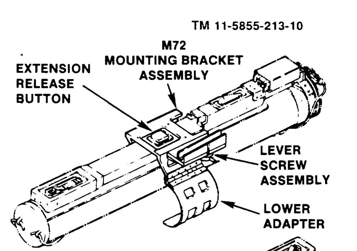

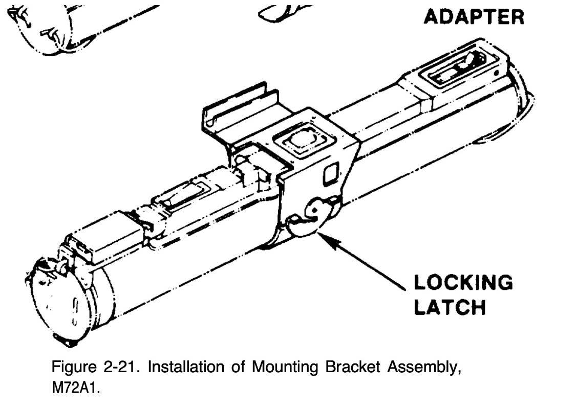

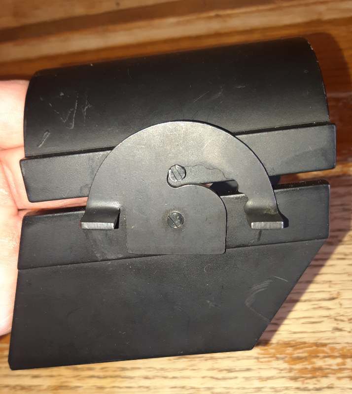

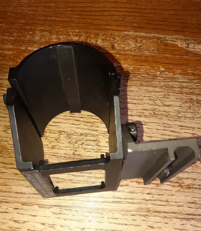

The bracket you posted  is 80063-SM-D-850360, is US military , and from the early 1990's.  This is a mounting bracket for the AN/PVS-4,  Night Vision Sight, Individual Served Weapon. This particular model ( M72A1) is used on M72 LAW and has the corresponding bracket to compensate for cold (C) weather when aiming.
Often pieces like this remain under ITAR rules so be careful to whom you sell to.
