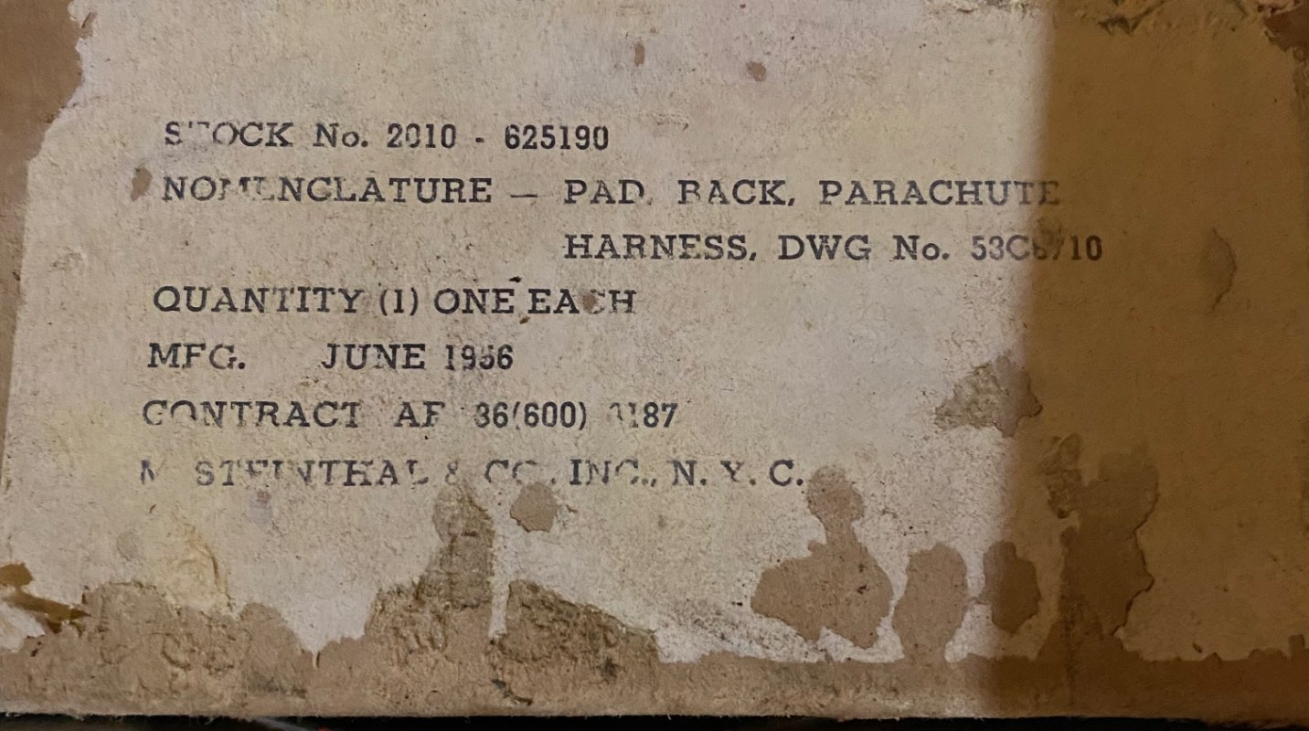

This is the data tag/ info on a sealed carton containing a USAF parachute back pad
can anyone provide a visual for which type of back pad is inside, based on the drawing and stick number?
dated 1956
trying to avoid the temptation of opening the carton
thanks much
When I looked up that drawing number, the specs it lists for what it consists of basically sounds like the usual square back pad found on the BA series parachutes, mentions it has 4 snaps, 1 at each corner.
I believe what you have is a 15" square pad that attaches with a snap fastener in each corner. I don't have a manual old enough to show your exact pad, but the manual I have says your pad can be used in lieu of this pad. The cover of yours may not be nylon, but the size and shape will be similar.
