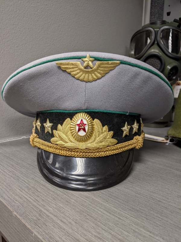

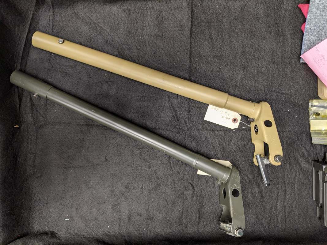

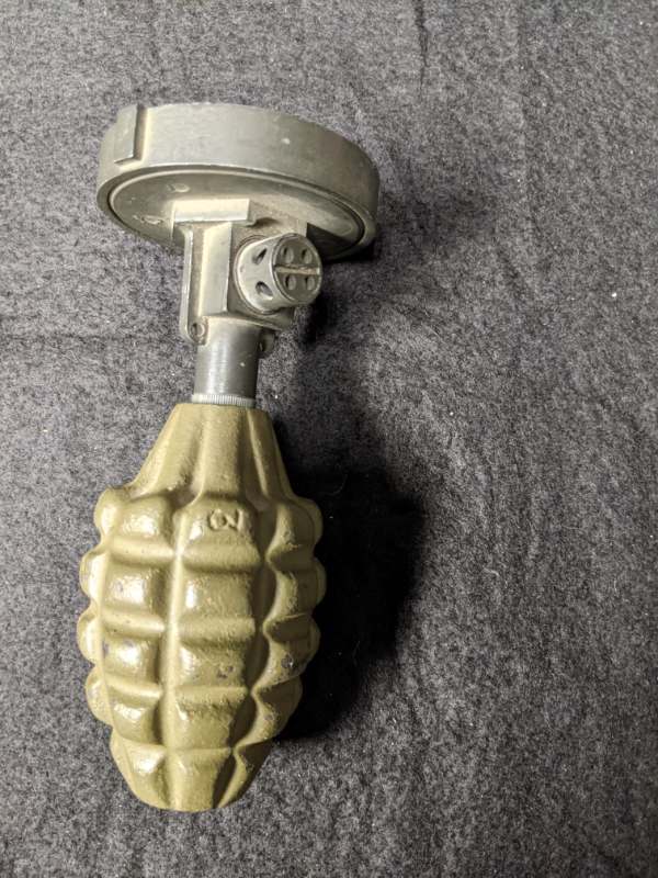

CDGman Posted November 19, 2021 #1 Posted November 19, 2021 Hi all, I am back again looking for your expertise in identification. 1) Two MG34? mounts. They fit onto the previous posted tripod mounts (Drebeins?). Is that their purpose to just create a higher elevated mount? 2) Unknown grenade attachment. 3) Soviet cap, tried researching on my own but can't identify if armed forces or civil, nor what the accoutrements might symbolize. 4) Various munitions we found in a box. All inert. The main items are the bottom two, the top one, and the blue and yellow one marked "Bomb frag" Thank you again!

illinigander Posted November 19, 2021 #3 Posted November 19, 2021 Is that a CN stamped on the grenade? Would it be intended for CN gas? illinigander
CDGman Posted November 20, 2021 Author #4 Posted November 20, 2021 11 minutes ago, illinigander said: Is that a CN stamped on the grenade? Would it be intended for CN gas? illinigander It's marked 3 in this image. RFX on the opposite side.

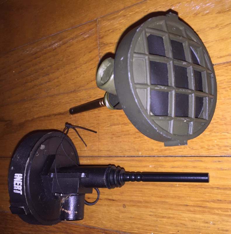

917601 Posted November 25, 2021 #7 Posted November 25, 2021 I know all the ordnance except for the OD grenade with the waffle top and am baffled by it. Nothing in the TMs about it.Experimental? Fantasy piece? Can you unscrew the waffle top for a look at the fuze powder train?

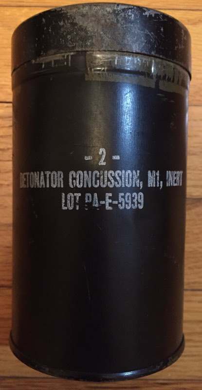

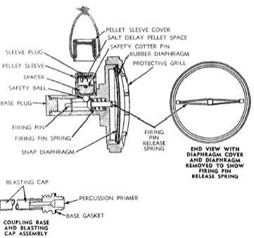

Inertord Posted November 26, 2021 #8 Posted November 26, 2021 The grenade has a U.S. M1 Concussion Detonator affixed to it.
SubgunFun Posted November 29, 2021 #10 Posted November 29, 2021 Wow. Very cool mechanism. Interesting how salt pellets are used for delayed arming under water. Thanks InertOrd for ID'ing this one for everyone.
