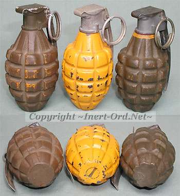

There is known examples of OD green over yellow without the yellow stripe on top. I have one myself. There is even photos of GIs painting yellow Mk2s in the field completely OD and putting them in boxes, I want to say it was somewhere in the pacific. Usually if done in the field the paint is much thicker than what was done in the factories, I was told they sometimes used vehicle OD paint as well.
Kaptainssurplus
Here you can see the 3 versions, all OD over yellow, old yellow MK2 and OD over yellow with stripe on top added (notice the color difference of the all yellow gloss like used on the body and the stripe that is more flat yellow). Also notice that the fuze and spoon was sprayed OD on the all OD MK2, which I have seen many examples of this myself, which would indicate to me it was field painted, not to be confused with the black painted spoon tips that was done when modified.
