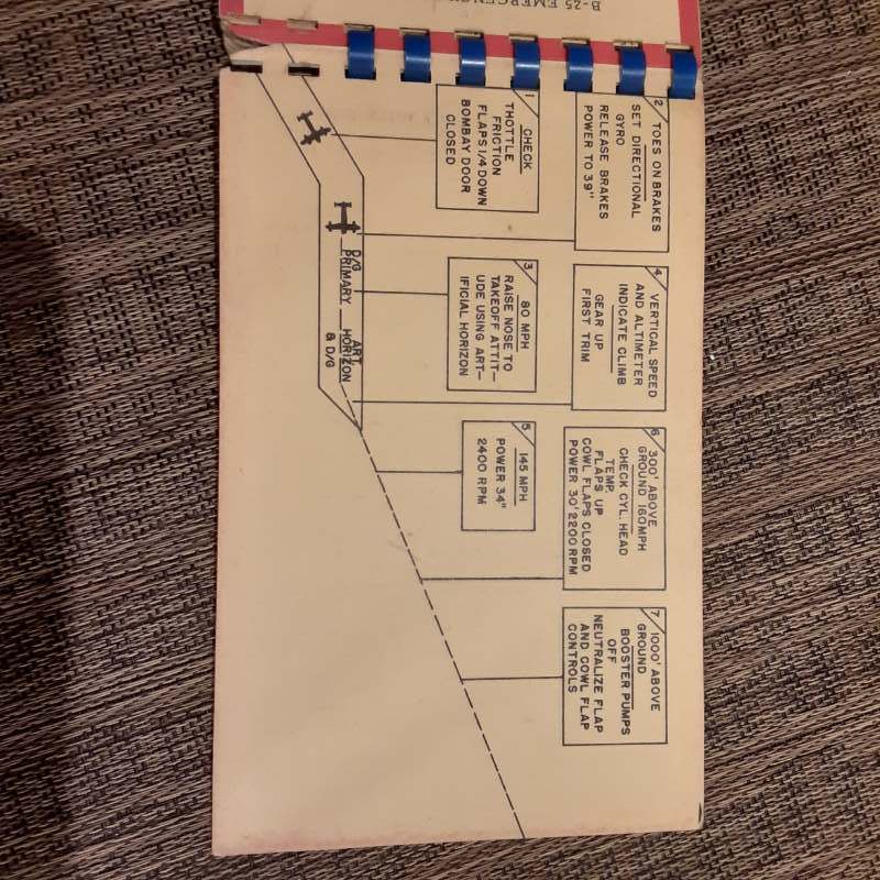

P-59A Posted January 29, 2021 #1 Posted January 29, 2021 I know this should be in the paper photo section, but no. So sue me! This is a cool little book and if I ever find a B-25 with the keys in it..... It has more pages, but you get the idea.

The Rooster Posted February 3, 2021 #10 Posted February 3, 2021 Thank you for posting that checklist. It was very interesting to read. My Fathers Brother was killed in one. A marine corps PBJ version. It was a lot of airplane for 19 year old pilots. And early on, some of its dangerous flight characteristics were unknown. Mainly, it could not be flown safely on one engine if your airspeed was below 145 miles per hour. One of the checklist tasks was for the pilot to react to losing one engine. This killed some young pilots before it was discovered that you have to have airspeed of at least 145 before performing that test.. Afterwards, after many crashes and deaths the test was conducted at higher altitudes above that 145 air speed.

B-17Guy Posted February 3, 2021 #12 Posted February 3, 2021 Hey guys, I feel the need to chime in here about the B-25 flying characteristics. Since I’ve been flying 25’s for 19 years I thought I’d provide some perspective. The 25 does not have any negative characteristics while operating on single engine, in fact it flies quite well on one engine. The need to maintain 145 mph in the B-25 is simply what was referred to at the time as Safe Single Engine Speed and it was in the Flight Manual from day one. Every multi-engine airplane ever built has it and each airplane type is different, but all will suffer a loss of control below this speed, known as Vmc, if corrective action is not promptly taken. Basically, it is the point at which you run out of rudder to compensate for the adverse yaw created by operating on one engine as airspeed reduces. If airspeed decays too far, the airplane starts to roll over. As the condition gets worse, if you don’t reduce power on the operating engine and lower the nose, over you go. It is something we trained on over and over again in pilot training. Today it has become more refined as Blue Line (best single engine climb speed) and Red Line (minimum single engine speed), but on older airplanes they just gave you the one number Safe Single Engine Speed. Incidentally, the worst time to lose one is on takeoff before you reach 145. That’s why we stay shallow initially after takeoff...to get to 145 quickly. This usually occurs by the departure end of the runway, unless you are climbing steeper to avoid obstacles. If you dig into WWII aircraft losses, look at the accident rate. It is absolutely staggering. The fact is that thousands of young pilots were being put into high performance aircraft with minimal experience and the accident rate reflects this. The B-25 however, had such good flying characteristics, that it was used as a multi engine trainer in the USAF till 1958...notice the Marauder was gone immediately after the war. If you want to read a great book, which has a story of fly a B-25 for hours on one engine, I recommend Gen Henebry’s book about flying in the 3rd Attack Group. Hope that sheds some light. Also, I have a number of old B-25 checklists that I’ll post when I get some time. Best, John ps, P-59A, didn’t you and I communicate many years ago about the B-25 single engine accident you referred to? I was flying Executive Sweet at the time.
