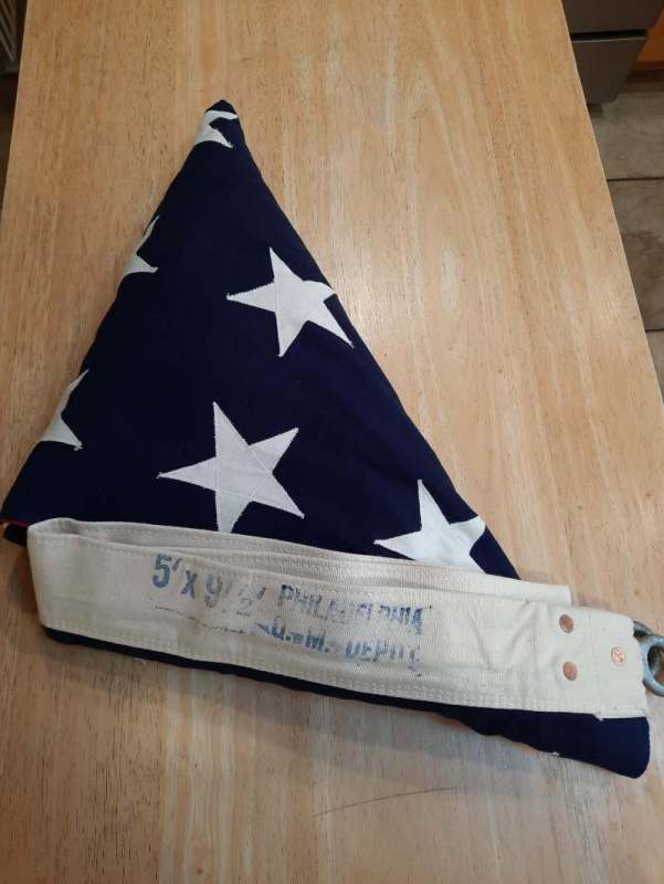

T Ambrosini Posted December 1, 2020 #1 Posted December 1, 2020 Hello all, Is there a difference between the so called 5' x 9.5' "storm flag" and the "interment flag" with the same dimensions, or are they one in the same? I have one from the PA QM Depot with the heavy metal loops riveted to each end of the hoist. Thanks, Tom

dhcoleterracina Posted December 6, 2020 #4 Posted December 6, 2020 The 5 by 9.5 marked flags are internment flags. A Navy #7 is often used for burials at sea and are also dual purpose flags. A question that I have never had a good response about are the heavy iron rings like you describe. What was the purpose of such heavy rings? Often/always riveted. They are used as internment flags too but what again is their purpose?
T Ambrosini Posted December 8, 2020 Author #5 Posted December 8, 2020 Thanks for the response and that's what I hope to learn as well. I understand (perhaps incorrectly) that the 5x9.5 flags with the heavy loops riveted into place are "storm flags", which were to be used in inclement weather. What I don't know is if there was another flag with the same dimensions that was specific for interment use (and used interchangeably). Tom

dhcoleterracina Posted December 11, 2020 #8 Posted December 11, 2020 Me too, I'm sure there is a reg out there, I just haven't found it. There is a macabre video out there showing the process of disinterment from a French cemetery in preparation for returning the soldier home. Hard to watch but in the end you see flag draped caskets lined up. You can clearly see that the flags were those with the heavy riveted rings on all caskets. I also have a 45 or 46 star flag with the heavy rings so they have been in use for a long time. During a previous discussion it was suggested that these were used for burial at sea. The heavy ring would be easy to hang onto when the body is dropped. Interesting theory but I'd like to see real documentation.

tdurbinmas Posted December 17, 2020 #11 Posted December 17, 2020 The type of heavy riveted rings you picture are pretty common on various military flags. I have quite a few different DOD and Army positional field flags from the 50’s and 60’s made by PQMD with identical rings and rivets. The rivets are copper. I also have a couple of old USMC flags/pennants with the same style riveted rings including a church pennant and a QM pennant.
dhcoleterracina Posted December 17, 2020 #13 Posted December 17, 2020 I had seen this thread before and for me it just repeats what seems logical about the heavy rings. It also may be 100% accurate but this is the army we're talking about, surely there is some obscure reg. out there to confirm the information. That's what I really want to see. In that thread the documentation comes from the Zaricor Flag Collection or Museum. They have a similar flag in their collection and the info is in the description. They also have a simple two grommet internment flag that they also call "storm flag". I know the information is out there.
T Ambrosini Posted December 17, 2020 Author #14 Posted December 17, 2020 Blacksmith, Thanks for linking these threads. I'm still looking around to see if I can find something definitive in the regs, QM catalogues, etc, that gives a specific name and/or purpose to these flag(s). The one I have is typical of the ones shown in the other thread. Tom

P-59A Posted February 9, 2021 #16 Posted February 9, 2021 Here is a description of the history of these flags. 48-Star US Flag from the Philadelphia Quartermaster Depot. This large flag is a storm flag used on army posts during inclement weather. It is readily identifiable as a US government flag by the special size (5' X 9.5') and the distinctive hoist marking, "PHILA.QM.DEPOT" as well as the heavy, riveted, military style staples used on the upper and lower heading on the hoist edge. This flag was made by the Philadelphia Quartermaster of the US Army in the late 1940s or early 1950s. It was used in the Korean War as an installation flag for use during bad weather. The Philadelphia Quartermaster Depot was the designation used between 1926 and 1965 for the federal government's facility on the banks of the Schuylkill River in Philadelphia Pennsylvania. It made a huge portion of the flags used by the United States Army during WWII and the Korean Conflict.

T Ambrosini Posted February 9, 2021 Author #18 Posted February 9, 2021 Great explanation, thanks! Tom
lettow Posted February 9, 2021 #19 Posted February 9, 2021 The flag that draped by Uncle when he returned from Iwo Jima in 1948 was one of these with the large grommets, so they were used for stateside burials after the war. I remember climbing onto the roof of our house to attach them to hooks on Memorial Day.
dhcoleterracina Posted February 9, 2021 #20 Posted February 9, 2021 I recently bought a book called " Under the Flag A History of the Stars and Stripes" It was printed in 1914. This is a civilian written history of our flag but he touches on some military aspects of the flag. In chapter 4 he talks about "Army and Navy Flags". "They are of the following three sizes: The Garrison Flag measuring 38 feet fly and 20 feet hoist, is furnished only to posts designated in orders from time to time from the War Department, and is hoisted only on holidays and important occasions; the post flag, measuring 19 feet fly and 10 feet hoist, , is furnished to all garrisoned posts and hoisted in pleasant weather; the storm flag, measuring 9 feet, 6 inches fly and 5 feet hoist, is furnished to all occupied posts for use in stormy and windy weather. It is also furnished to national cemeteries and recruiting stations. " This excerpt is the first time I've seen the connection between these heavy ringed "storm flags" and use at National Cemeteries. Again this is a book written by a civilian but he writes with such specificity as to suggest he is referring to military regulations though, sadly, there is no bibliography or military reference. I still believe there is an old military document detailing these flags.
P-59A Posted February 9, 2021 #21 Posted February 9, 2021 The information from 1914 has some limited bearing on this flag. That flag had different grommets and there would have been no problems using that flag as a presentation burial flag. The size of the storm flag had changed and along with the grommets by the time the Philly factory started making this flag in 1926. Yes both flags were used, but only if a regular burial flag was not available. The flag in question was made to be used as a storm flag first and a burial flag if needed.
P-59A Posted February 9, 2021 #22 Posted February 9, 2021 I wasn't their, but it is custom to cover the fallen from the time of removal to reburial. I suspect the flag that accompanied your Uncle was with him on his journey from Iwo Jima. That flag was what they had on hand and it stayed with him. I have one of these flags and spent allot of time looking into them. I have seen many photo's of these flags still in the box after being sent to NOK after burial of there loved ones over seas. The problem with this flag is you can not make the tri fold for presentation because it was never made to be the primary burial flag. It was used when that flag was not available.
dhcoleterracina Posted February 9, 2021 #23 Posted February 9, 2021 I'm really not sure what you are saying. What do you mean by "that flag had different grommets"? and "the size of the storm flag had changed"? Can you source your information? What might be better is to post examples of flags that we are talking about since this thread started with a question and not a photo of a flag. I'll try and post some of my examples later.
T Ambrosini Posted February 9, 2021 Author #24 Posted February 9, 2021 1 hour ago, dhcoleterracina said: I'm really not sure what you are saying. What do you mean by "that flag had different grommets"? and "the size of the storm flag had changed"? Can you source your information? What might be better is to post examples of flags that we are talking about since this thread started with a question and not a photo of a flag. I'll try and post some of my examples later. Follow the link in post #12 for several examples of the flag in question. A photo of my flag is shown in in post #14 (grommets cut off the edge of the image). Tom
dhcoleterracina Posted February 9, 2021 #25 Posted February 9, 2021 A few flags,,,first is a storm flag of 46 stars (1908-1912) Made by the civilian flag company Horstmann.
