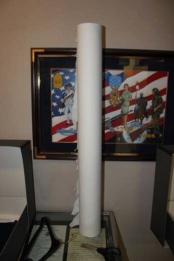

Rakkasan187 Posted October 16, 2017 #4 Posted October 16, 2017 As a museum curator I will suggest to you and to all who have thought of this question before that rolling the flags, guidons, streamers, etc. is the best way to preserve and to prevent fold creases from developing. The cardboard tubes that tarheeltim has suggested is a very good idea. In addition to the cardboard rolls, we use acid free tissue paper as well as muslin cloth to act as a barrier between the cardboard and the fabric of the flags. I would also recommend that you do not roll these too tight but loosely around the tube to let the flag breathe. On occasion you can unroll the flags and rotate the sides of the flag which will also assist in the even aging of the flag. If you see that there are a lot of wrinkles in the flag prior to rolling you can very lightly iron (The lowest heat setting) the flag but making sure that you do not directly iron on the flag itself but use a barrier between the flag and the heat source. One other method that we also use is steaming the flag but again, you do not want to get too much moisture near the flag and absolutely ensure that it is completely dry before rolling. Also use the lowest possible steam setting on the steamer.. One of the reasons you want to have a barrier between the cardboard tube and the fabric of the flag is that the cardboard may not be acid free and after a few decades it can discolor the flag.. Constant inspection of our fabrics and flags will help prevent irreversible damage. We also change out the tissue paper and muslin cloth annually.. Attached is a picture of a roll of acid free tissue paper that we use for various preservation and conservation techniques. This tissue paper comes from an archival business that specializes in museum preservation supplies (GAYLORD). You can also find this type of non-buffered acid free tissue paper at hobby lobby and Anna's Linens... Hanging flags is not recommended since it could cause stress on the fabric and could separate the flag from the halyard and edging if the flag is old. If displaying flags, they should be laid flat and depending on the size of the flag this could present a problem due to obvious reasons with space and flag width/length.. For smaller flags such as small Navy ensigns or unit guidons these can be framed and hung, but make sure that the matting used is acid free and also ask if the frame shop uses tape or other methods to mount the flag to prevent slipping when hung. Hobby Lobby uses archival acid free matting boards and other archival techniques to display flags. They also use plexi-glass and other glass that is UV filtered for protection. You can ask the frame folks at hobby lobby what methods they use for preservation and conservation.. Leigh
