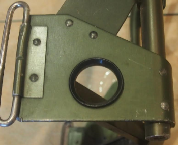

pawtwo Posted November 15, 2016 #1 Posted November 15, 2016 Hello, I would like to ask you if it would be correct for about mid 80's reenactment to use medium field pack configured that way: - 1976 dated Medium LC-1 pack - Green anodized LC-2 frame - 1979 LC-1 waist Pad + LC-1 waist strap (1994 made but still in OG106) - LC-2 shoulder straps (1983). I consider winter configuration so it should have frame. I have somehow weird LC-2 frame. I always supposed green anodized frames with 1 inch offset at middle crossbar to be LC-2. And LC-2 frame should fit quite nicely with all LC-2 straps. But this one is different at bottom loops that you use to attach waist pad. These loops are quite narrow and it's easier to put there LC-1 waist strap than LC-2 one (LC-2 is a bit too thick for these loops, I can put there LC-2 waist pad but it's really tight). These loops looks like loops used on LC-1 frames.

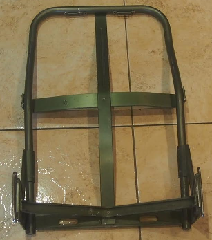

pawtwo Posted November 15, 2016 Author #3 Posted November 15, 2016 And whole frame itself. At the time it's the best looking early (or just 80's) LC-2 frame that I could find here. Yes - it was badly dented, but I managed to make it straight as much as possible and now it looks fine. Most of rivets are quite strong. Only the rivet on the top of the frame is quite loose. Considering these narrower loops for waist pad I was wondering if it wasn't just an early example of LC-2 frame and contrator used old parts that were in stock. All other my LC-2 frames have wider loops for waist pad/strap and you can fit LC-2 waist pad/strap easier in them. What was reason for making LC-1 waist straps in 1994? Were these used for something else or just replacements? I thought that in 90s LC-1 waist strap was a way obsolete.

bummer Posted November 15, 2016 #6 Posted November 15, 2016 pawtwo, You used what you were issued from CIF in the Army. I served during the 80's and we all had a mixture of equipment. The only new stuff I had was purchased by me at the clothing sales store. Just for your information not everyone was issued a frame, I purchased my own at Ft Polk because of being the company rto and the fact that the frame that came with the prc 77 left a lot to be desired.
Linedoggie Posted November 15, 2016 #7 Posted November 15, 2016 Hello, I would like to ask you if it would be correct for about mid 80's reenactment to use medium field pack configured that way: - 1976 dated Medium LC-1 pack - Green anodized LC-2 frame - 1979 LC-1 waist Pad + LC-1 waist strap (1994 made but still in OG106) - LC-2 shoulder straps (1983). I consider winter configuration so it should have frame. I have somehow weird LC-2 frame. I always supposed green anodized frames with 1 inch offset at middle crossbar to be LC-2. And LC-2 frame should fit quite nicely with all LC-2 straps. But this one is different at bottom loops that you use to attach waist pad. These loops are quite narrow and it's easier to put there LC-1 waist strap than LC-2 one (LC-2 is a bit too thick for these loops, I can put there LC-2 waist pad but it's really tight). These loops looks like loops used on LC-1 frames. Frames weren't even issued to all units in the Early mid 80's. I served in 2nd Armored Division at Ft Hood and no one I knew had a frame for the medium ruck unless they bought one either from surplus in Killeen or MCSS. Those I did see were the green frame and a turnbuckle waist pad
pawtwo Posted November 15, 2016 Author #8 Posted November 15, 2016 To be honest I just really like how the pack looks with this turnbuckle waist pad. It's so simple. Also really like how these early spring loaded buckles on early packs works. It's just faster, even if it can be more prone to failure.

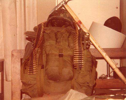

patches Posted November 16, 2016 #9 Posted November 16, 2016 Here's my large Ruck as an RTO summer of 1982 Alaska, going to the glaciers, lot of stuff on it, had to carry extra M-60 belts (blanks) too, a tactical trip this time (not like the summer before), Steel Pot, LBE and Weapons. These where of the Black frame variety then, don't think we ever seen the green type, nor used waist belts. Earlier at Hood in the 1st Cav, 80-81, like Linedoggie, we too were not issued frames for the Medium Rucks, in fact didn't think there was one for this size Ruck.
