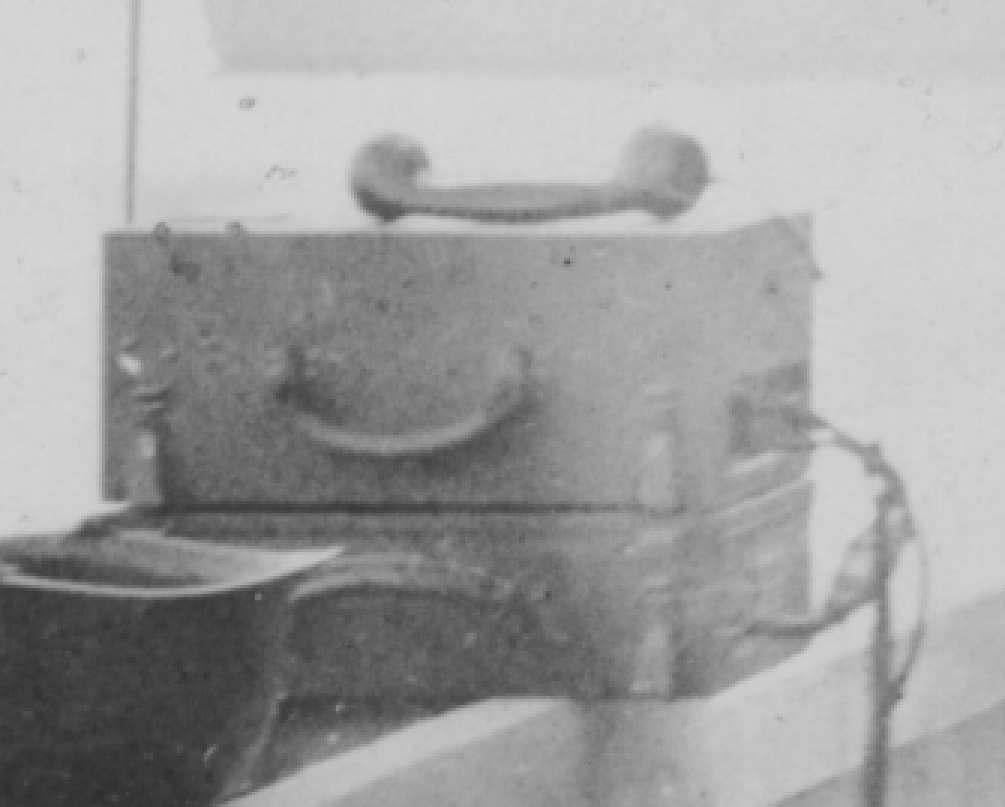

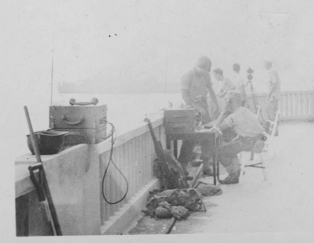

stealthytyler Posted January 22, 2015 #1 Posted January 22, 2015 Can someone please help identify what radios these sailors are using? My grandfather is the one standing looking down next to the radio operator sitting. I am trying to create a display with his uniform and gear and would like to buy this type of radio to go with the display! THANKS!
Sully Posted January 22, 2015 #2 Posted January 22, 2015 Looks to me to be a BC-659 with a PE-120 power unit. I have a pair in my collection. Here is the receiver.
stealthytyler Posted January 22, 2015 Author #4 Posted January 22, 2015 Looks to me to be a BC-659 with a PE-120 power unit. I have a pair in my collection. Here is the receiver. Does yours have handles on the sides? Do you know how they carried these from the landing craft to the beach? Did they have radio backpacks for these? Thanks!
Sully Posted January 22, 2015 #5 Posted January 22, 2015 Yes the units do have the leather handles on the side. I don't think these could be used in a back pack configuration, they are quite heavy. I know that they can be vehicle mounted.
stealthytyler Posted January 22, 2015 Author #6 Posted January 22, 2015 Hmmm I wonder how they got it from a combat landing via LCVP to where they set up communications then. intersting
Johan Willaert Posted January 22, 2015 #7 Posted January 22, 2015 The SCR-509/510 or SCR609/610 were used mounted in vehicles or on the ground with the battery box CS-79 used for Ground Use and a PE117 or PE120 for vehicle use. Mainly used by liaison units or Artillery forward observers to direct fire. http://en.wikipedia.org/wiki/SCR-610
robinb Posted January 22, 2015 #8 Posted January 22, 2015 If you look close you can see that the radio is question is a BC-620, not a BC-659. Thinner antenna and lack of a speaker on the front is the give away. Also there are no brackets on top to store the antenna.
stealthytyler Posted January 22, 2015 Author #9 Posted January 22, 2015 Are the antennas mounted to the backside of the radio? Im trying to figure how a 3 man radio team stormed the beach with this heavy of a unit? Did they have backpacks for them?
stealthytyler Posted January 22, 2015 Author #10 Posted January 22, 2015 I was told by one of the sailors in this platoon that they used TBX radios during Gela, Sicily and Salerno, Italy beach landings. This photo is from the Southern France landings...obviously not a TBX correct?
hbtcoveralls Posted January 23, 2015 #11 Posted January 23, 2015 The SCR 610 was man portable because it broke into two major pieces and each half had a carrying handle and D=rings which attached a strap ST-19 to be carried over the shoulder. I've also seen these on packboards. interesting thing is that the radio had only two channels and had to be tuned correctly by signal corps personnel to work on the net. It wasn't until the BC-1000 came into the picture that a tunable radio became available. Tom Bowers
MIFlyer Posted May 22, 2017 #12 Posted May 22, 2017 I have a BC-620. As compared to the BC-659 and the BC-1000, the BC-620 operated on Armor frequencies. Thus, presumably the BC-620 was used by troops scouting for armor units. The BC-620 was tried out as an answer for communicating with tanks during the fighting in the hedgerow (Bocage) country in Normandy. A backpack version was created, and you can imagine what it must have been like walking around with the equivalent of a full sized microwave oven on your back! The interim answer was to put field telephone boxes on the rear of the tanks, hooked into the intercom, so that the troops could tell the tanks thing like, "Shoot over there to the right. There is a machine gun position we need to take out." I don' think the problem was solved until the RT-70/GRC short range set was installed in tanks after Korea, able to talk to local infantry units with their PRC-10's and PRC-6's There is a picture in the Warren Thompson book on P-51's in Korea of some ROK troops with a BC-620 on high ground above a major armor engagement, presumably scouting for the tanks.
