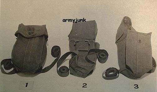

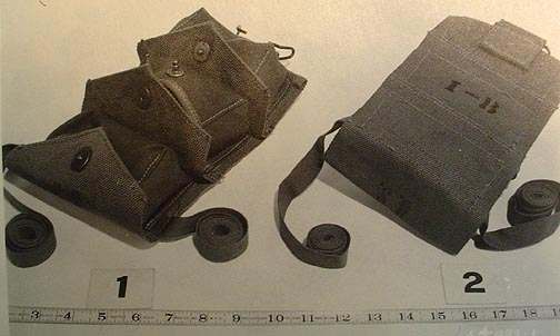

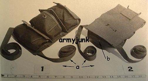

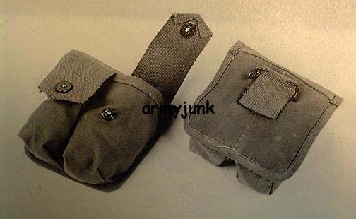

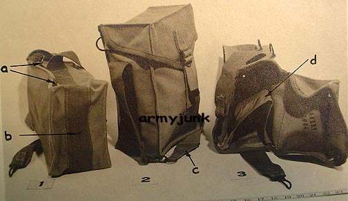

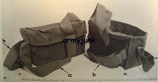

craig_pickrall Posted January 23, 2007 #28 Posted January 23, 2007 I really hate to use this set of pics but it does prove what the 3 pocket, 1 snap pouch was intended for. This is a set of pics that belong to a MCF member named army_junk. In order to see these pics on MCF you need to join, because of that I can not post a link. This set of pics are of experimental equipment, in this case it is grenade carriers. There are several designs included. Please note that for the 3 pocket pouch sample were made with both the flap turned up and turned down.

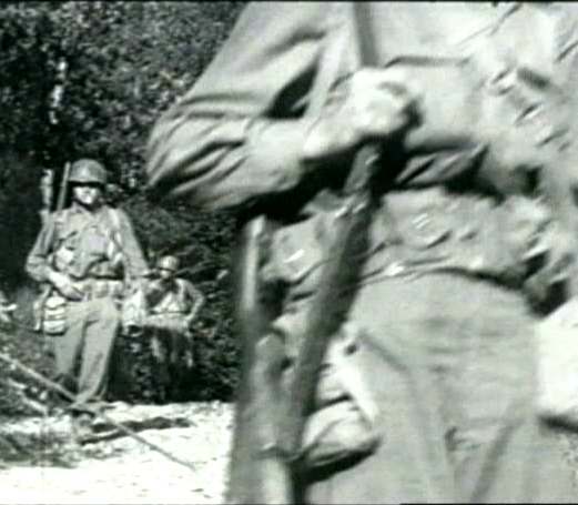

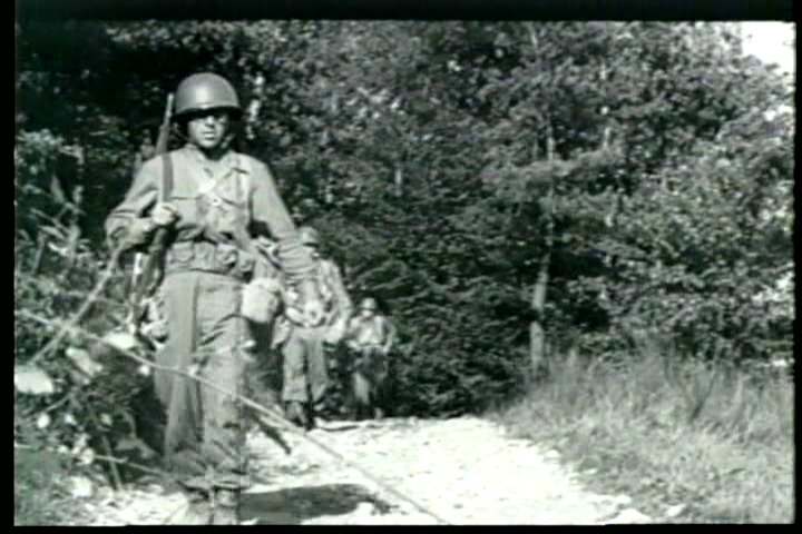

Johan Willaert Posted January 23, 2007 #29 Posted January 23, 2007 I cannot post still images at this point, but those that have the DVD, it's on: DVD Color of War Part 1 Chapter 3 Hope & Despair Scene 1 Between 6Min51Seconds and 6Min57Seconds Between 7Min01Seconds and 7Min06Seconds Same GI's walk thru a French field. Two have the three cell pouch, one on his right, the other on his left.. One has a M1 Carbine and M28 pack, the other a bandoleer and M1 Rifle..
bfryar44 Posted January 23, 2007 #30 Posted January 23, 2007 Here ya go Johan. I screen capped this last night but it didn't turn out as well as I had hoped. You can see the Rifleman at the far right wearing one of the three cell pouches with single LTD. "The Color of War" DVD.
glenm Posted January 23, 2007 #31 Posted January 23, 2007 Maybe it's just me, but I fail to see how the pouches marked 3-a and 3-b can be for grenades - they aren't big enough? Also, the ones in the last pic of the experimental pouches - they aren't grenade shaped surely? Is it definite that these pouches are supposed to be for grenades (i.e. are the photos marked as such from an original source, as opposed to what the collector thinks)? Cheers, Glen.
craig_pickrall Posted January 23, 2007 #32 Posted January 23, 2007 I tried to figure out which pics you were refering to as 3A and 3B. Finally found them. That is an M36 Musette bag. The open area in the back is fairly large and could hold several grenades. It would be worn as an across the shoulder bag with the universal sling. I did not have access to the original photos. Army_junk broke them into groups and posted them. This particular group was refered to as grenade carriers. More than that I can not tell you. The last pouch may be for canister grenades. That is just my guess though. The original source is supposed to be a binder holding a massive set of experimental grear photos and the source of this binder is the US Army. Again that is all I know.

glenm Posted January 23, 2007 #34 Posted January 23, 2007 The pouches I was referring to are the ones in the last pic on Page 1, stencilled on the back of them "3-A" and "3-B" (these are the ones with three rows of 2 pockets with individual pointed flaps, same as the one in the pic above but which only has two rows). No way are those square-shaped pockets big enough for a grenade.
artu44 Posted January 23, 2007 Author #35 Posted January 23, 2007 Armyjunk is a guy who likes share with others his powerful documentation and you can swear pics posted are referring to grenades. He did also on MCF an excellent display of pics reerred to 1912 cavalry experimental equipment.
craig_pickrall Posted January 23, 2007 #36 Posted January 23, 2007 It looks like to me that the 3A and 3B pouches have grenades laid in on an angle with the fuses overlapping.
glenm Posted January 24, 2007 #37 Posted January 24, 2007 Of course, there is also the possibility that along with the Musette Bag, WWI Grenade Vest and Ammunition Bag being used as potential carriers for Grenades, the team doing the experiments included a "triple first aid pouch" in as a potential carrier of grenades......

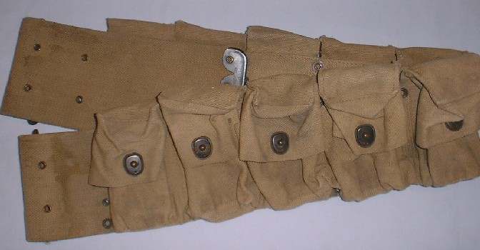

General Apathy Posted January 25, 2007 #46 Posted January 25, 2007 Hi Everyone, Sorry, in my previous post on page one of this topic I forgot to include a photograph of a belt that was mentioned in the quote below. The statement about this belt was that we all know this belt to be a WWI medical Corp belt. In my earlier quote I stated that another member on this forum had made the statement that the Marines in early WWII used it as a grenade belt. So what we could be talking about here is that both items were intended for medical use and ended up with grenades. Lots of things were used in a way not inteneded, let's call that American ingenuity, as in the second quote below, what other uses were the M-1 helmet put to. Until specific paperwork appears this will rage on, but let's keep a civil debate about it, please QUOTES ATTACHED. On the flip side of this question, on this forum in a different section there is a post about Marines in early WWII using left over WWI corpsmans bandage belts to carry grenades, again I believe he states anecdotal veteran statement. How many anecdotal statements do you get about the helmet, headwear, cooking-pot, digging foxholes, washing bowl, etc, etc. In 1979 I attended an Airborne reunion in Nijmegen Holland, I questioned a vet as to what he was wearing by 1944 in that area. He stated this large bag with lots of straps, I suggested the M-1928 pack. He was adament it was not that, I sensed I was pushing too hard so stopped questioning. five years later I turn up a photo, they were using ' jungle' packs, so do we say he was wrong that they were only used in Jungles, because that's what they are called, and he could not have used it, as he was ' Airborne' Cheers ( Lewis )
