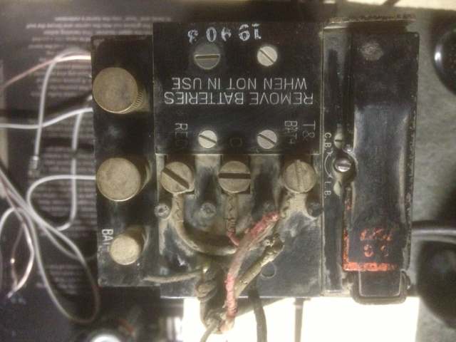

capa Posted June 2, 2013 #7 Posted June 2, 2013 Sorry I got to this late-the EE-8s are really robust and you can most always get them working. As you found out. You got a steal on them if you paid $20 for the leather cased ones. I have one, canvas cased, and need a leather one. What's not working on the 4th one (i.e. the ringer)? Maybe I can help you figure it out.

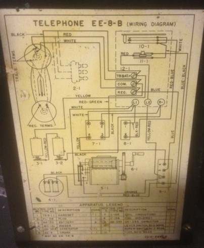

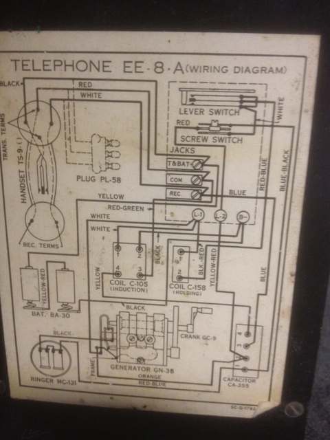

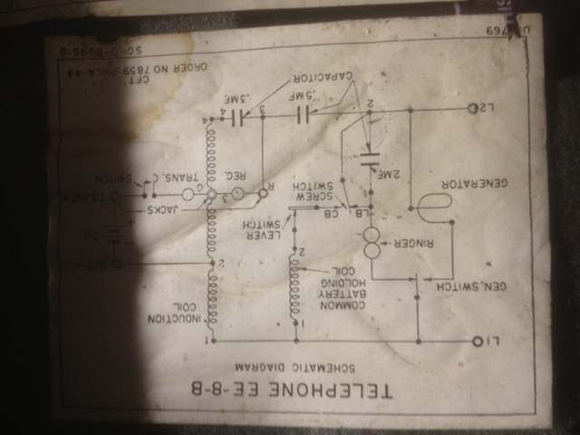

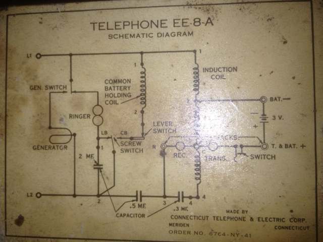

anton67 Posted June 2, 2013 Author #8 Posted June 2, 2013 Thanks for the input. What do they generally go for? No the ringer is OK. The hand held mouth/earpiece does not work. Only two wires connect to the device as opposed to the others which connect with a blk, red & white wire. It is a shame because it is a Kellogg. I got the other 3 to work. They can communicate with each other and I can even hook them to my home phone line.

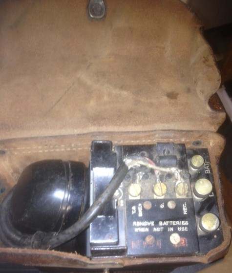

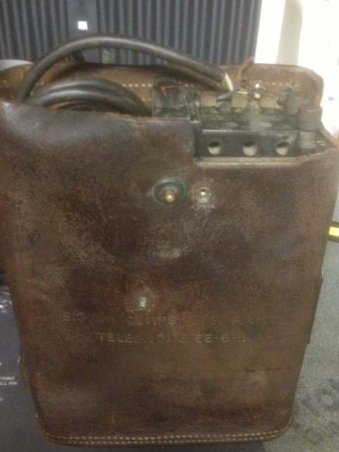

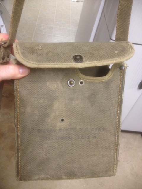

anton67 Posted June 2, 2013 Author #9 Posted June 2, 2013 Here are better pics. First the one that does not work

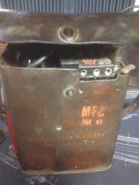

anton67 Posted June 2, 2013 Author #16 Posted June 2, 2013 Last pic of this one. It has the full leather strap too.

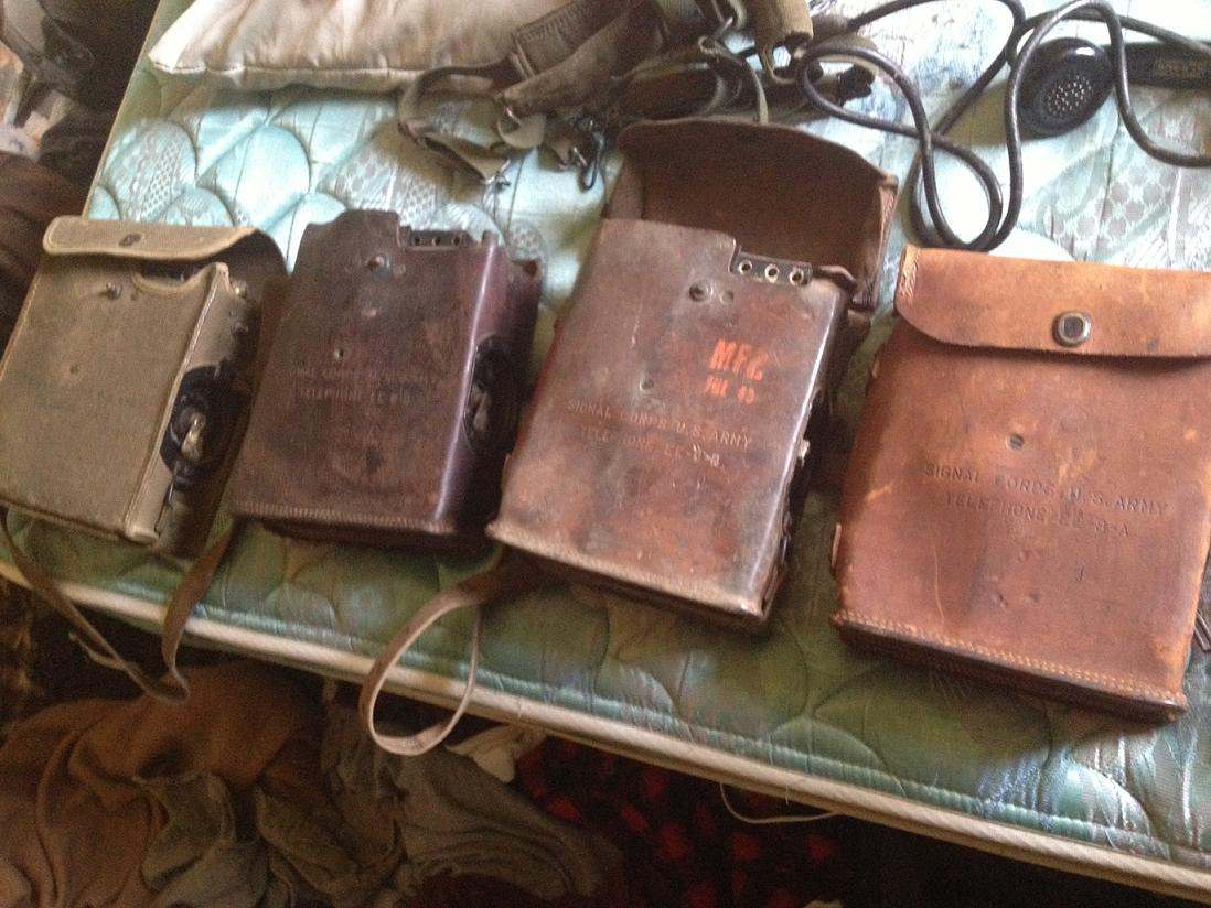

anton67 Posted June 2, 2013 Author #17 Posted June 2, 2013 Next is a 143 Leather cased - missing strap.
anton67 Posted June 2, 2013 Author #21 Posted June 2, 2013 Last one is a 1944 cloth cased. It has the strap to it.
