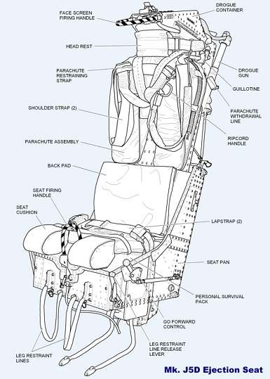

itshistory Posted January 16, 2012 Author #28 Posted January 16, 2012 Since you asked about the MkJ5D with the rounded flexible handle here is an illustration of the MkJ5D as built and presented by Martin Baker. Many features of the MkJ5B can be seen integrated into this iteration. The US Army found shortcomings in this model but MB was not keen to make changes to the seat hence the US Army hired subcontractors in the US to make the desired changes. The photograph shows the MkJ5D after the US Army had the mods made. These included a new rigid seat survival kit with seat pad, new thigh supports with pads that included a coiled line for use if caught in a tree, New lumbar support with pad, a new parachute box to delay degradation by sun exposure, a new reshaped rigid overhead pull handle and a Tip Off Compensating Rocket under the seat bucket. The TCR improved stability and trajectory after the seat was ejected. IH Illustration from Martin Baker web site
northcoastaero Posted January 17, 2012 #29 Posted January 17, 2012 Interesting info on the earlier flexible upper ejection handle and the later rigid. I have seen F-8 Crusader and A-6 Intruder MBEU seats with the earlier handle loop(s) being the rigid handle and the later era seats having the flexible type.
