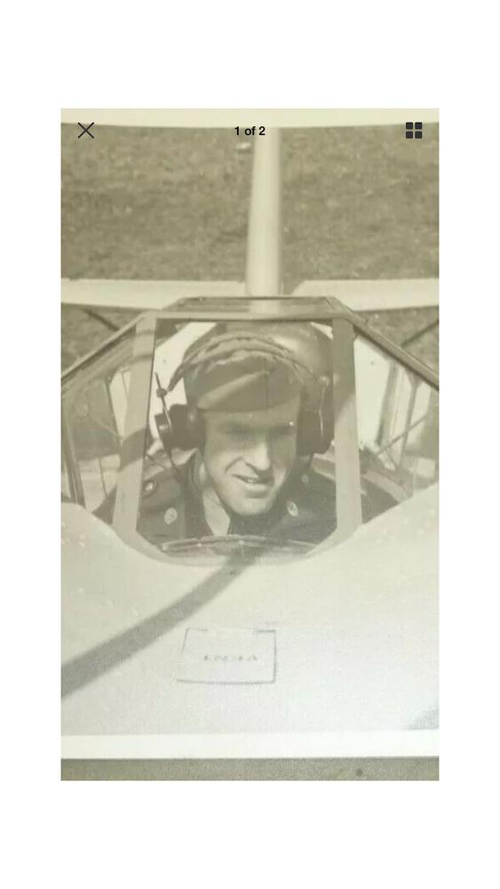

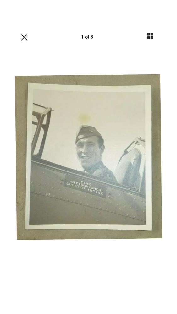

Appears to be 2 different aircraft with 33 ID observer?
Concerning the photo on the right; note how the canopy framing is angular instead of curved. That should be one identifying feature. Most canopies you see from this time period are curved. I think he is in the back seat. Not ready to take a guess yet.
He’s an observer in the 33rd ID.
Sure looks like the patch doesn't it. Also the canopy has a brace running down the middle.
I think it’s 2 different 2 seaters.

I'm going to say the photo on the right is a Douglas O-38, judging by the canopy design, and he is sitting in the rear seat. I'll see what others think. No idea what the one on the left is right now.
Sure looks like it.
He’s in the back seat.

It’s almost as if the observer is in an angular bubble.
Certainly looks like an enlisted man.
Could it be that the photo is taken from the pilots seat looking back?

Could the second plane be a Douglas O-38 variation?

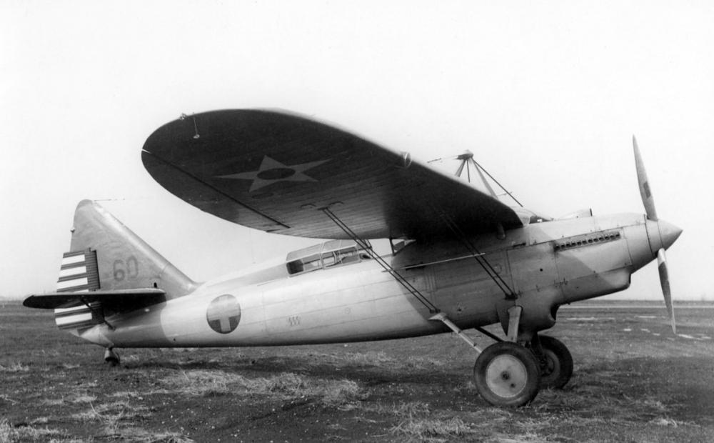

My guess is that both photos are of the Douglas O-31B. In photo #1, the canopy and windscreen - especially the latter - are not quite right for an O-38, plus there appear to be braces under the horizontal stabilizer - not a feature on the O-38, but definitely on the O-31. Also in photo #1 there is the shadow across the windscreen which I suspect is that of the prominent vertical strut contraption that kept the wings were you wanted them.
Photo #2 of the rear seat is trickier, but one can see that the canopy rails extend behind the rear cockpit - a feature of the O-31B, but again, not the O-38.
Both the O-31 and O-38 were flown during the 1930s by the 108th Observation Squadron, and, given that both types were Douglas aircraft, it makes for a tricky ID based on the canopy because, in all likelihood, the same man at Douglas designed both canopies.
