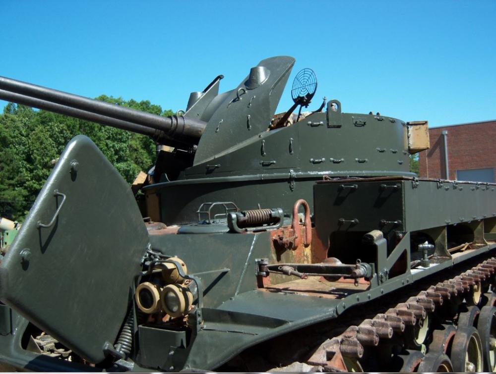

We at the Virginia National Guard HQ are refurbishing an M-42 Duster in our spare time.
Our goal is to eventually refinish it, inside and out, and use it as a historical training device. We will give it Vietnam era markings and use it as part of our Vietnam vet tribute

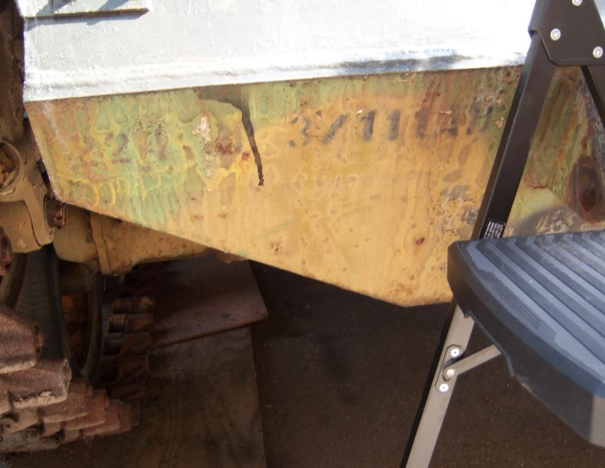

As we have been removing the layers of rust, dust and old camo paint we found some lettering that we would like to re-do when we get to that point--

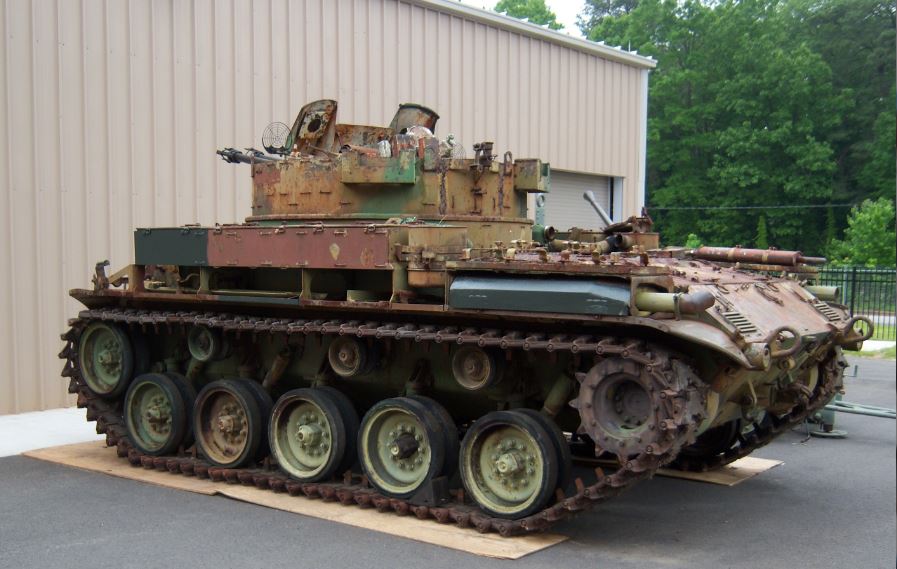

in the one picture you can see the shape it was in when it was delivered and after we put some test paint in different areas to see if the color was right.

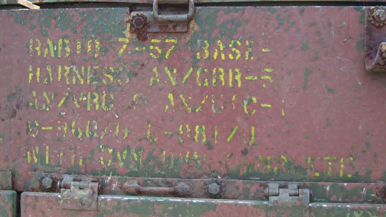

the other picture shows the yellow lettering we uncovered on the one side--we can make out the words "Radio" and "Harness" but are at a loss for the rest---any ideas?

hbtcoveralls
that would have been the MWO (modification work orders) pertaining to the radio sets installed
They would stencil it when the change was complete,

BTW we finally got the MWO info uncovered.as you can see---

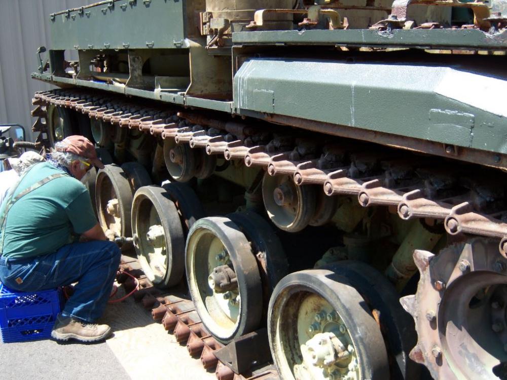

we have run into a problem with the road wheels---by sitting still so long, every time it rained or someone mowed the grass around it, the water and clippings went into the same part of the rim and turned into serious rust--one today turned out to have rust clear through in one spot--hopefully we can find some other roadwheels to swap out if it appears others are as bad.
Al
The road wheels can be bead blasted, acid etched, and welded...the bigger problem will be the bearings and axles if corroded out. Hopefully they were packed with grease when retired....hats off to you, it is a huge project, huge amount of manhours.
Road wheels are 2 piece, IIRC, check MVPA and other military vehicle magazines for replacements. Guessing you all have track jacks and other special tools, working on tracks is hard work, especially when hot. TMs also can be found, you will need one when working on engine. Might want to remove mufflers when starting engine/ adjustinging carbs. LOL. Good luck, will be nice when finished.

Here's a modern -day shot of two of our volunteers working on the road wheels. lots of dust, rust and an occasional hornet's nest....

here's another sign of progress---first, how it looked when we got it, and how some of it looks now---
we still have beaucoup hours of work on the undercarriage, tracks, roadwheels (which are filled with water again from the rain) engine compartment and inside the turret and hull---but it is nice to see some progress-- on Thursday we are going to try to grind off the welds that keep the radio operators hatch sealed.
Al

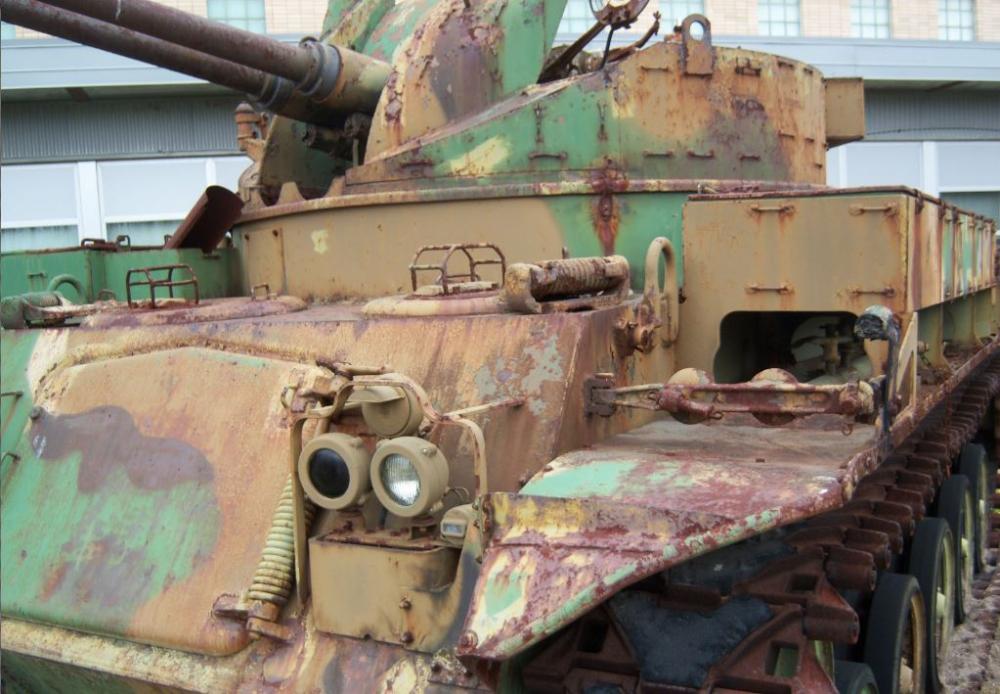

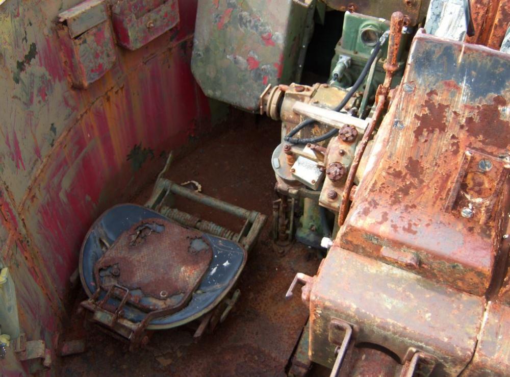

Looks good, whats inside like?
It's pretty rough---looks like there was some standing water inside for a long time---the turret (second photo) is rough also but easier to work on then down in the hull---the drivers area ---seen here -- is actually the best area in the hull---the radio operator's seat is rusted to the floor --not sure how/if we'll be able to fix it. but if it was easy, anybody could do it, right?
Al
Yuck, sadly many display tracks have bad interiors. Low pressure sand blaster and large shop vac used at same time is easy method to resolve rust issues. Lots of work regardless, good luck.

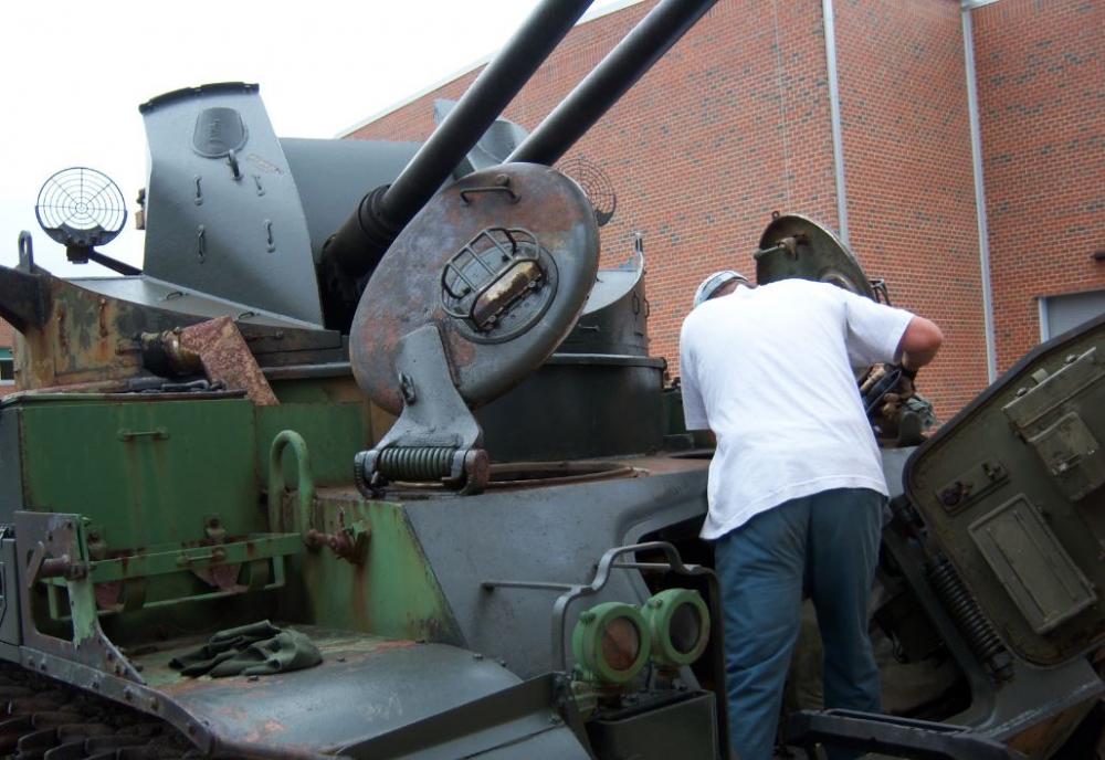

Some big breakthroughs lately---we finally got the radio operator's hatch open (it won't open all the way because the guns/turret are welded into place and block it) and we are starting to work on the front of the hull---we've taken pictures of all the unit markings so we can re-create them when we put it on display.
We also found and unplugged one of the drain plugs under the driver's seat so that any accumulated rainwater can drain out rather than sitting inside.
Al

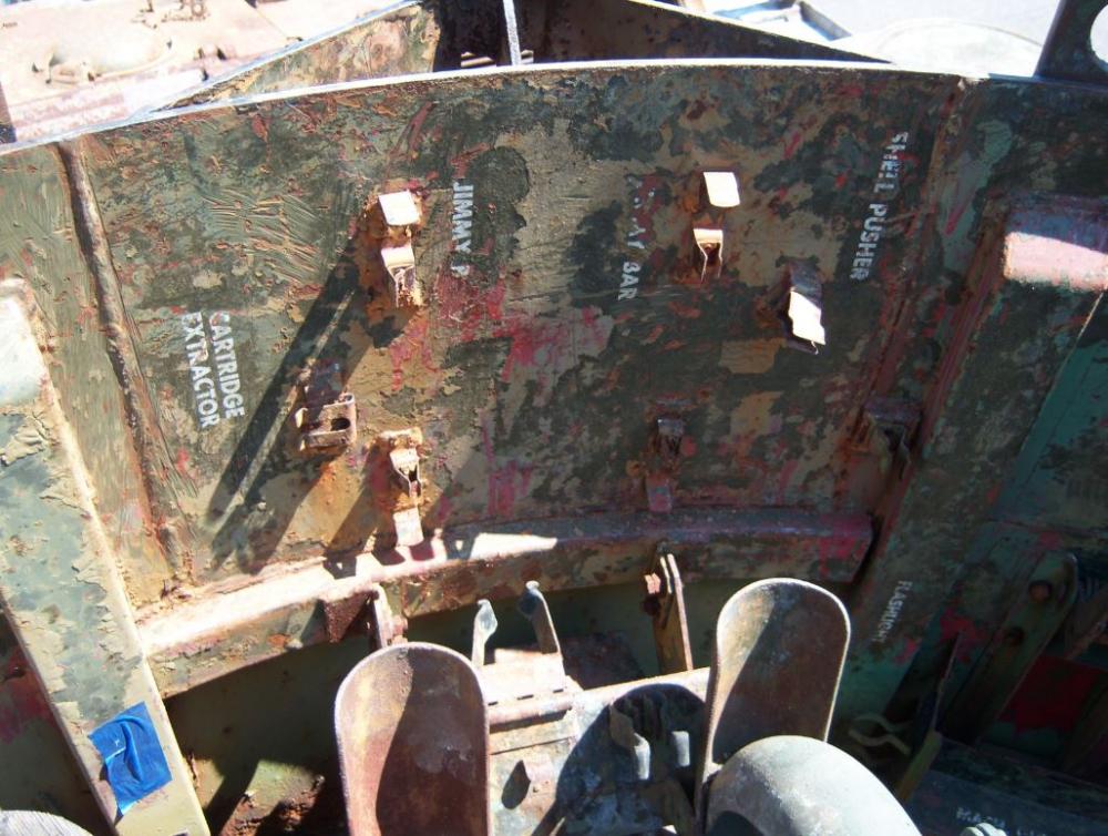

You are sure right about that--and we have several other vehicles lined up to be worked on next....but in the meantime, as we worked in the turret and scraped away some of the old paint and rust, we found markings for what items get stowed in the turret---
Yous guys have a project for a while.
Very good! Need to find one of the old round stencil machines to make new stencils. Know where spare tools might be? Check “Army Motors “ of “ The Supply Line”, place in Kinston N.C. may even have some?
We found some of the tools inside, deep in the hull, and badly rusted--plan on working on those on rainy days when we can work outside but so far every Thursday morning (our work time) has been clear---really hot but clear...and I'm curious about the lettering---it doesn't look like stencils....maybe pressed on letters and a sealant?
