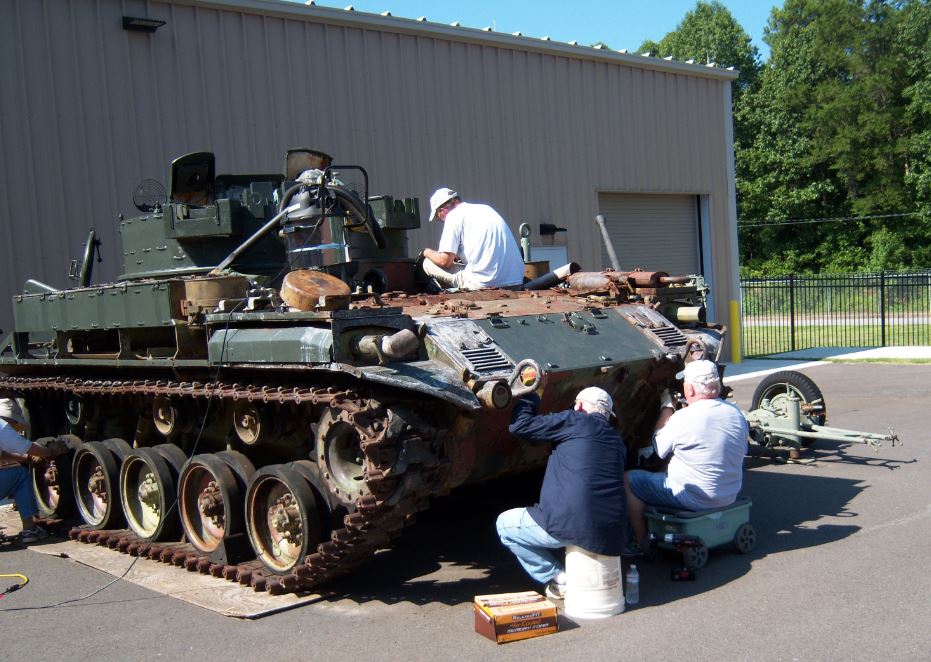

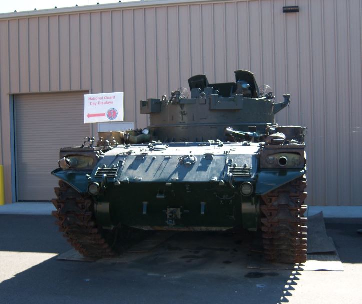

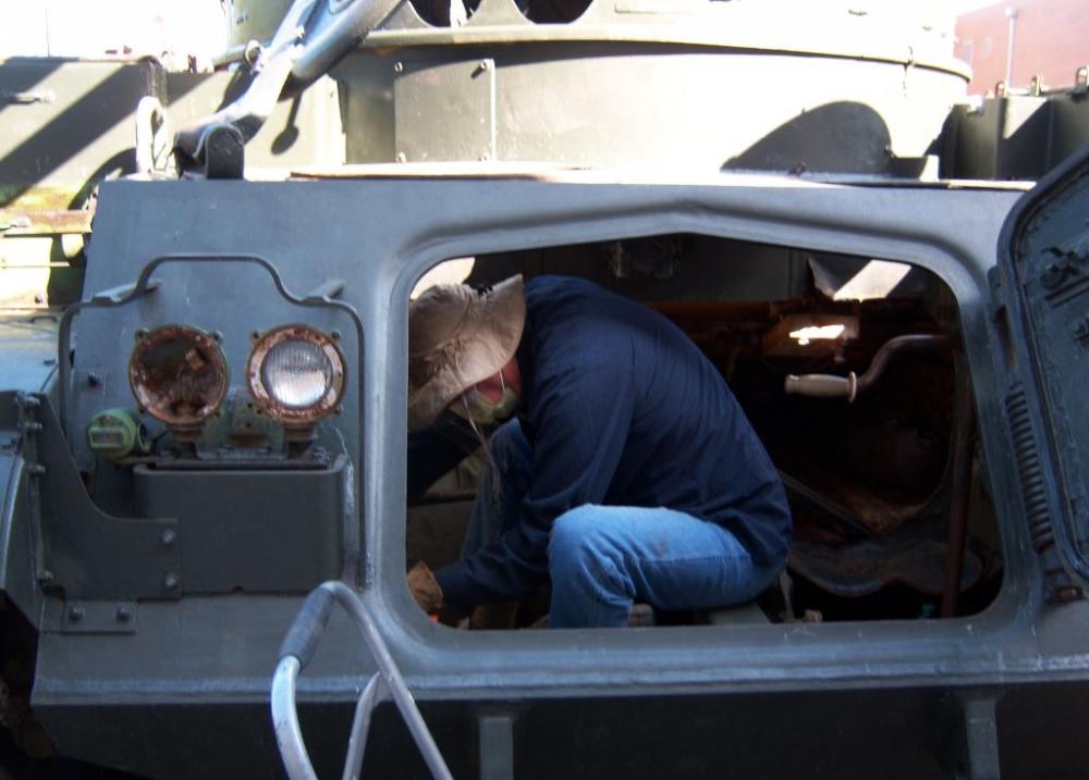

Here's a quick update---still a lot of work to be done but we are making visible progress---one of the guys has even made 2 new Loader seats for the turret--- the old ones were unrecoverable--as are the Gunners' seats.---in the top photo you can see the brown wood of the new seat---makes it a lot easier to work on the lower sections of the turret without having to crouch...
We are still trying to figure out a way to keep rainwater from collecting and sitting in the road wheels after we have finished them and moved the duster to its display pad---suggestions?

you can't keep the rainwater out, unless you move it inside, but what I would recommend is a serious 2 part epoxy primer which will lock out water from the metal of the wheels
This should prevent rust from eating the wheels themselves
Share this post
Link to post
As rain water in the road wheels....under a cover is the best option, 2nd best is to "tent" the tarp when you cover it...instead of securing the tarp to the vic, use guidelines and sandbags (or other weights) to pull the edge of the tarp beyond the road wheels...this should keep most rain out, apart from squals with heavy winds blowing sideways. You might also try parking her against a wall of a building to the west, as most storms on the continent blow West to East. Not perfect fixes, but better than nothing.
EDIT: sorry didn't see you were moving back to an outdoor display - thought you were outside until further restoration work. In that case, the answer above with the epoxy is your best bet!!

Just a comment about the road wheels collecting water. Not sure how much time you want to invest, but you can make " hubcaps", or in other words fill the wheel section with detachable foam inserts or plugs. Cheapest would be 3/8 plywood and cut the circle to fit inside ID, then a groove for a large O ring or foam. Second choice, line inside with heavy mill plastic, fill with expanding foam, let sit overnight. The foam will fill the cavity, , being lined in plastic would make a custom tight fit easily pressed in/ out....

Gents---great suggestions---we may try several of them and see which works best---We also have to do some remedial work on similar wheels on a Walker Bulldog---same chassis as the Duster---we had a good high pressure hose today to work on the hull and tracks---man, there was some gunk coming off --- not sure when it last ran through some red southern clay but we cleaned out a lot---we figured that Dorian will wash away any of the stuff in the work area that our clean up missed....

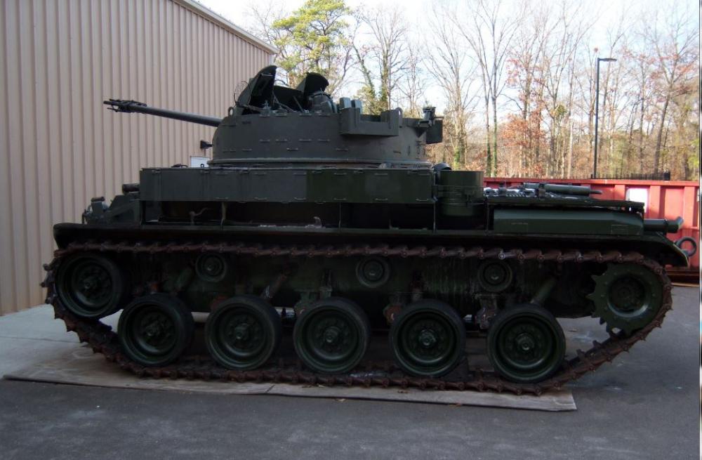

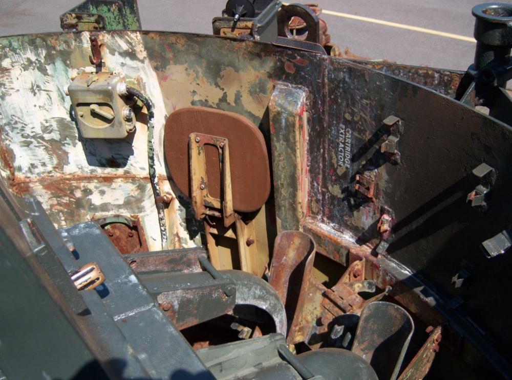

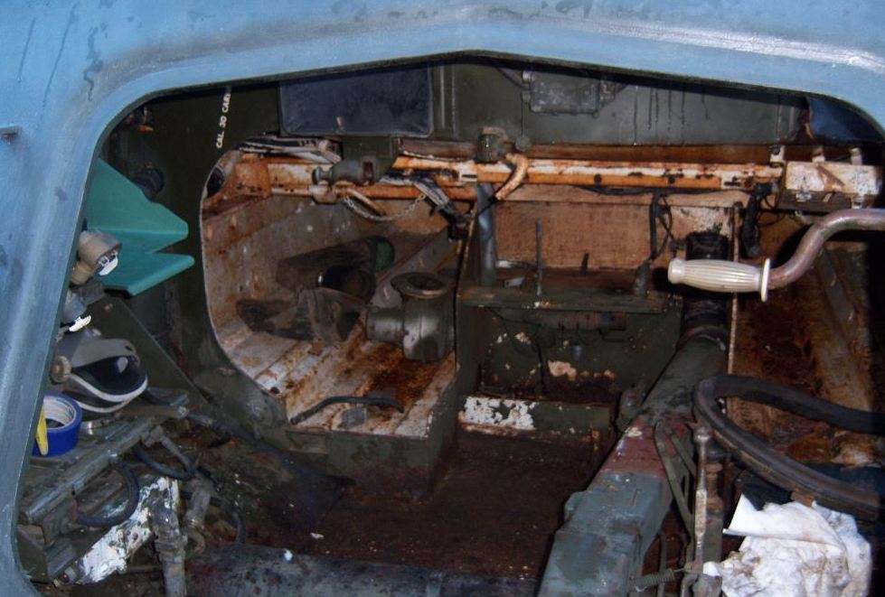

End of year status update on our Duster---
we haven't done much in December because the temps have been too cold to use the rust converter or the paint so we have done a lot of inside work (inventorying the VA NG Historical photo collection, inventorying the 1930-40s boxes of documents from armories around the state) but I felt I owed you a quick update---

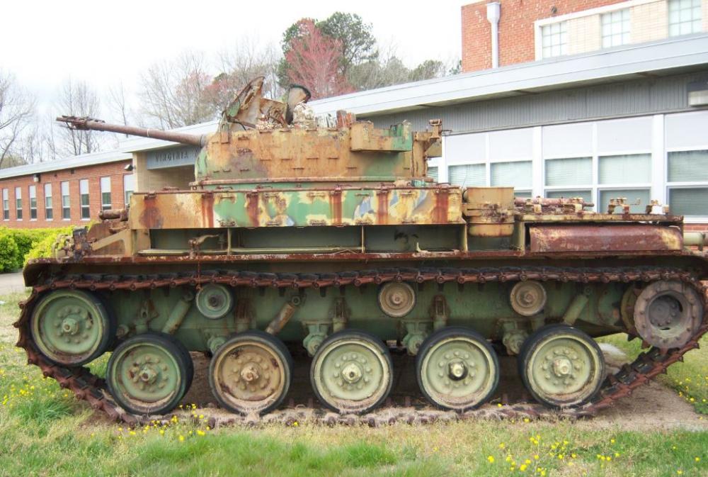

still a lot to be done so we are hoping for a mild January.. as reminder here is the original look and what it looks like as of yesterday. One thing we are looking for is a good copy of crew battle drill SOP--if we want to maximize the educational value of this vehicle, we need to put it into a context of how it operated.

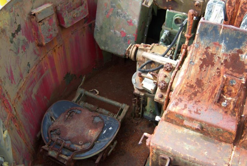

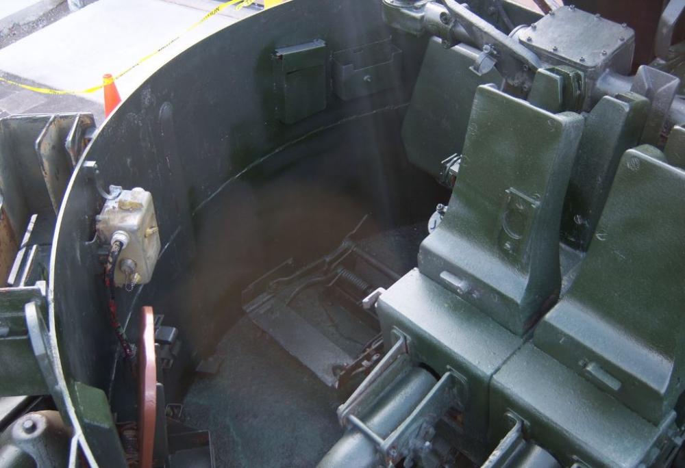

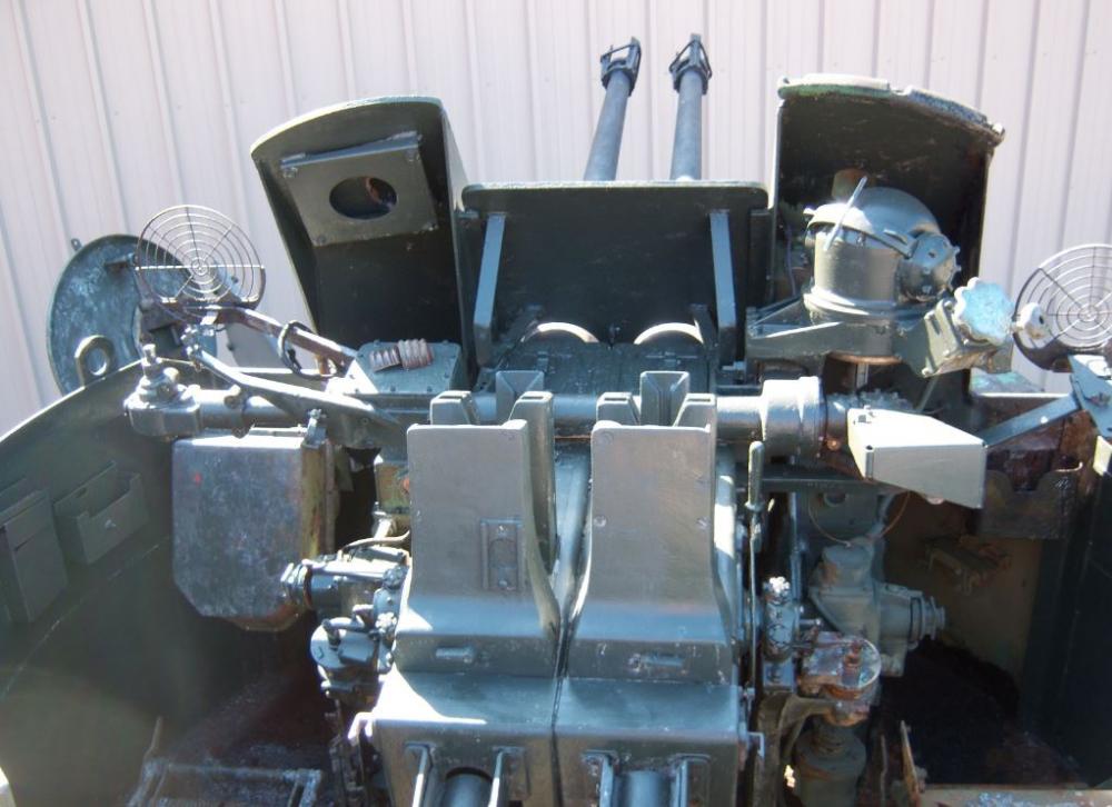

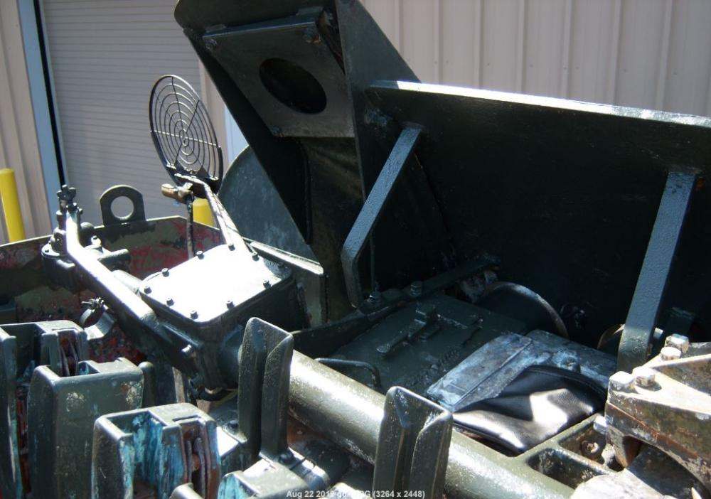

And a look inside the turret--first the original and then from yesterday:

Looing good, may consider throwing a tarp over it for the winter.Happy New Year.

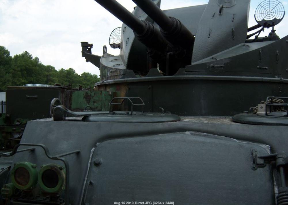

A quick update---we have been waiting our the weather to get back to painting the Duster but in the meantime, we have started work on our 1919 dated French 75mm....
that sort of psychedelic purple on the wheel rims is actually rust converter---when completely dry it will be a matt-black color.
Overall the cannon is in really good shape and only needs a little surface rust removal on the barrel and recoil system--and best of all we can work on it inside.....

Al, looking good, lots of hard work. Going to be late spring ??? before can get up that way.
We'll be ready when you are---here's some samples from today's efforts----we had to raise the tail to get at the rust underneath---a lot more than we thought--so we scraped it and put on the rust converter---we also started to patch the cracks and splits in the wheels---and the last step, we tested our paint to make sure it's the right color----new on left, old on right---
