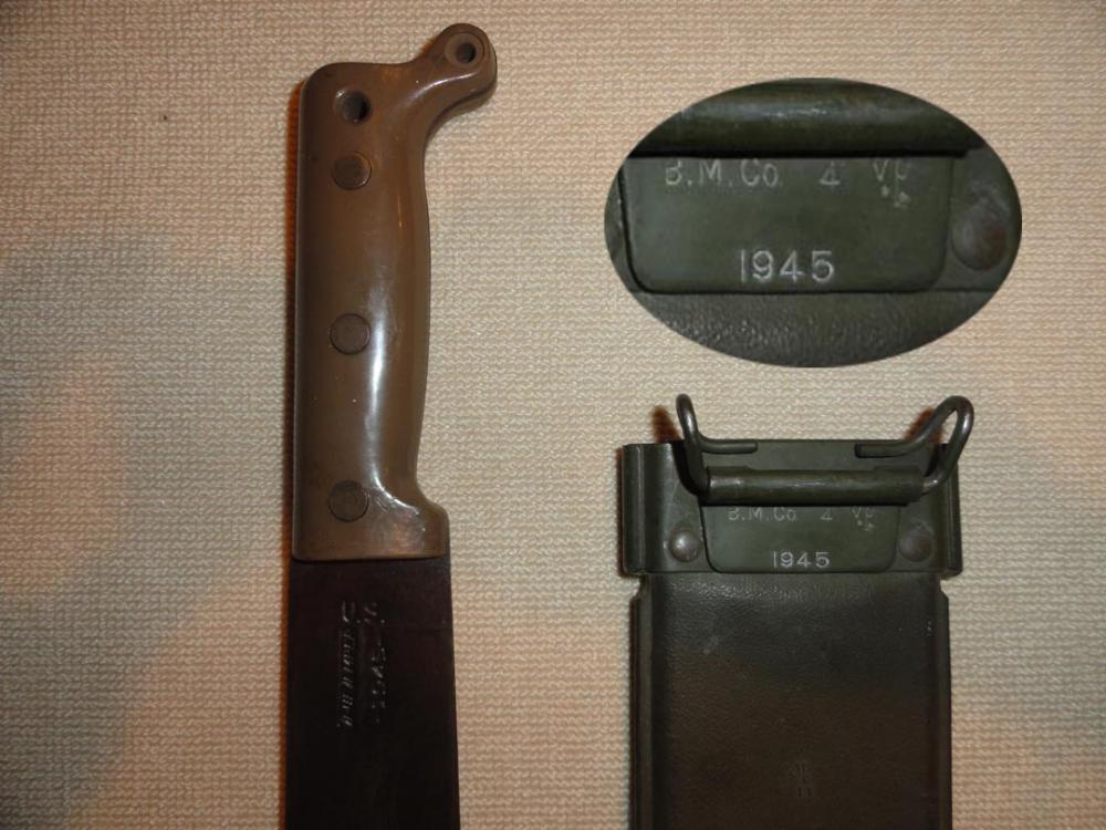

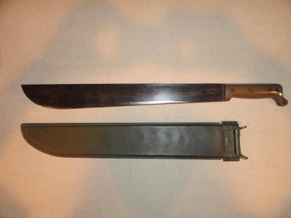

I picked up this these up at a garage sale $40 :unsure: - the machete is marked "TRUE TEMPER 1945 US" and scabbard " marked "B.M. Co. 4 VP 1945"
I believe it is real GI - the scabbard is hard plastic like material - I always thought they were canvas? Handle is dull more yellow than green color - blade is real nice - not chipped - fairly sharp edge. I'm not sure if it is a good value or not.
There were some plastic machete sheaths introduced late in WW2. Same style sheath was also made in the 60's for Vietnam use. Later that sheath was replaced by another more ridged plastic sheath, that I believe may still be in use today.
GreenStar67- You did great! Nice WW2 True Temper w/ a nice late war scabbard. $40 for the set was a nice deal. We still had those WW2 era dated scabbards in the late 70s, at least in 5th SFGA. Thanks for showing! SKIP
Thanks I'm glad to hear that, sometimes you can tell its a good find and other times not. It did look different though. The scabbard doesn't have any holes in the sides like the Vietnam Era scabbard picture.

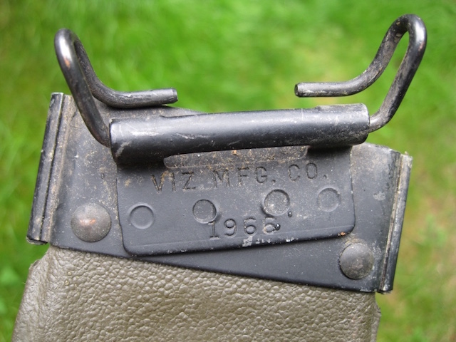

The one on top is the newer ridged sheath. Underneath the machete is the other plastic sheath similar to yours. Here's some close ups of the marking on the two sheaths.
sactroop, Interesting that the hangar is tilted on the newer ones - this image also shows marking a little better. In searching around a little, the "BM Co." and "VP" on scabbard I believe indicate Beckwith Manufacturing Company (Dover. New Hampshire - Victory Plastics division (Hudson. Massachusetts) - they made bayonet scabbards as well for the war effort and beyond - I am guessing the 4 is just a mold control number or such.

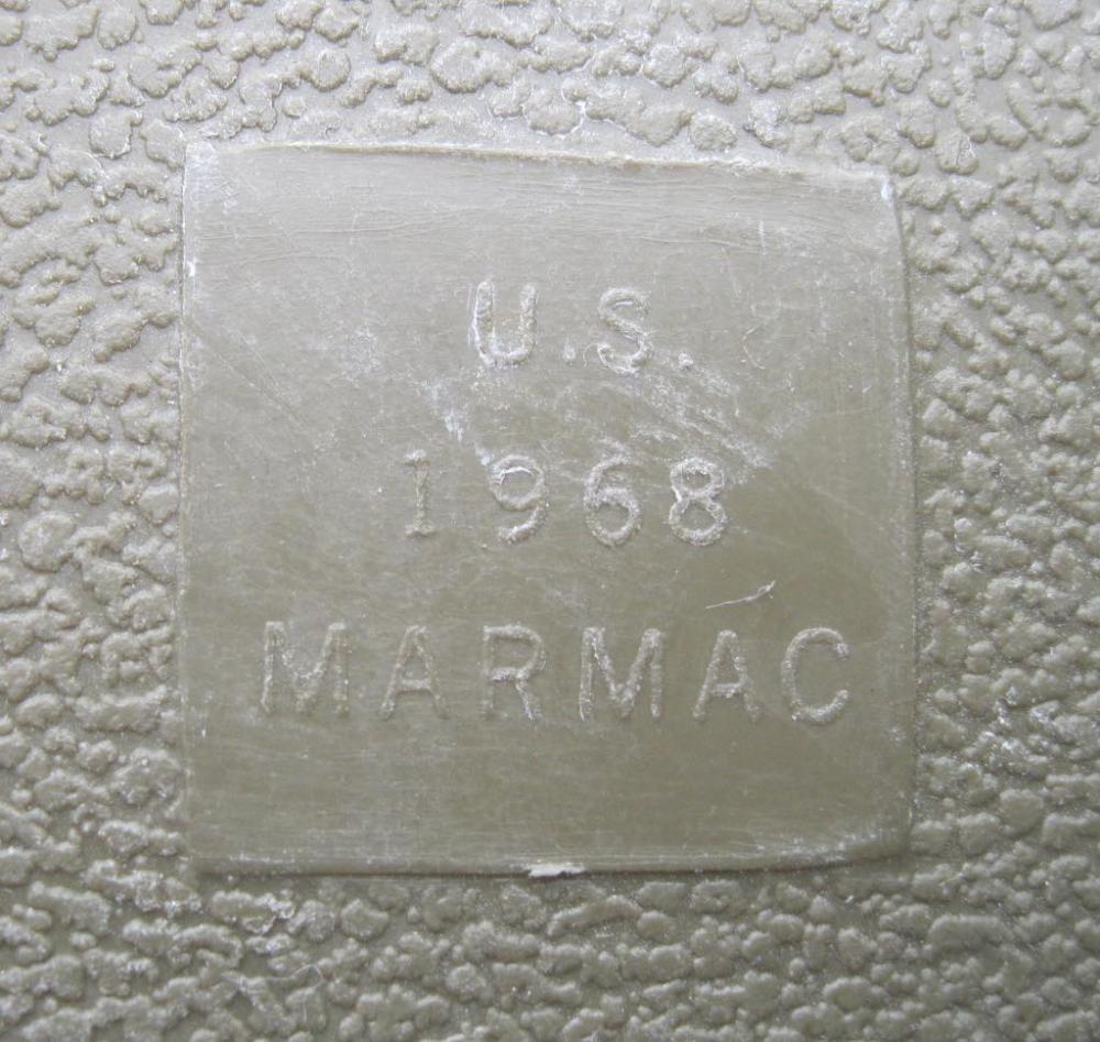

SolWarrior- Just caught the thread. To preserve the blade, a coat of oil will be fine, won't effect the finish. Scabbard wise, any WW2 dated one would be fine, whether canvas or plastic like the one pictured above. If you want Vietnam era scabbard, most ones I have seen have early 60s dates, again like the Beckwith above, or The Mermac dated from say 1968. Your choice. I would lean towards a WW2 date. SKIP

As for the scabbard, I found a 1968 OD MARMAC in great condition (before I read the replies here). I will keep looking for a WW2 sheath for it too.

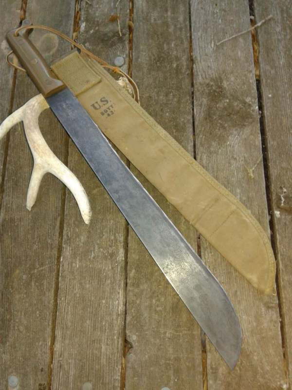

Since I'm here, I came across another 1945 True Temper, besides the one above, with a 1942 Boyt scabbard. It had rust throughout and some deep rust in a few areas. The textured black finish was completely gone so I decided to wrap the blade with paper towels and drench them in white vinegar and wrap it in a long, thin plastic bag and left it for a few hours. That loosened most all the rust and put a black patina on it at the same time but it was too black and matte. What was left of the rust I rubbed off with my fingers and nails. Once rinsed, I degreased it with alcohol and put on a patina with mayo and tomato juice in spots that didn't take, to try to resemble the original blackened finish but it was still too black and uneven so I removed some with some soft steel wool and these were the results.
Oh, I also covered the brass pins and smoothed out the handles -- but not too much, just enough to remove the scrapes and scaring -- with 2000 girt and some green rouge on it, and then a little Flitz polish.
