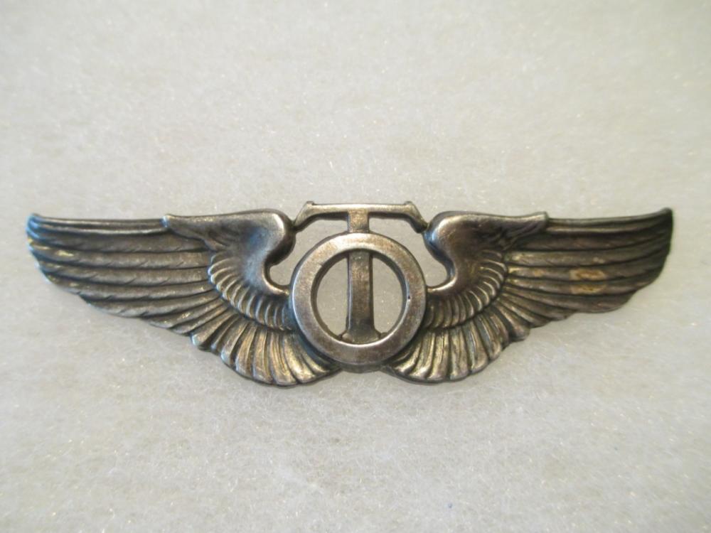

new (and my first) TO Technical Observer wing
The TO wing is one that I have been missing out of my collection for some time, but one in which I never really spent much time seeking out. There just seemed so many fakes that it just never really caught on fire.

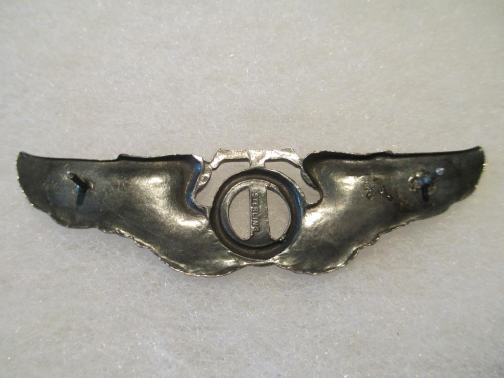

Patrick,
I saw these wings in your first picture and I knew you had nailed it! Look at the clutch back pins. The base of these pins are affixed with a silver braze, with NO roundel*, which signifies the early war (1940-1943) clutch back attachments. That is a beautiful technical observer wing, a scarce wing .....you knocked it out of the park my friend.
Thanks for showing this wing because your thesis is right on regarding how we get stuck in a particular bias toward wings which have been counterfeited. We must remember that they were counterfeited because they were, in their authentic veracity, very much worth counterfeiting because of their excellence and concomitant identity with the time they were made. Another great thoughtful thread Patrick!
*(roundel at base of clutch pin *typically alludes to late 1943-1945)
I would like to thank Patrick for his timely posting of this thread as it appeared just in time for me to consult on acquiring the same pattern T/O wing with confidence. Looking at it in detail it appears to come from the same die and has the short pins without the ‘tack head’ bases. This is also my first T/O wing. Thanks again.

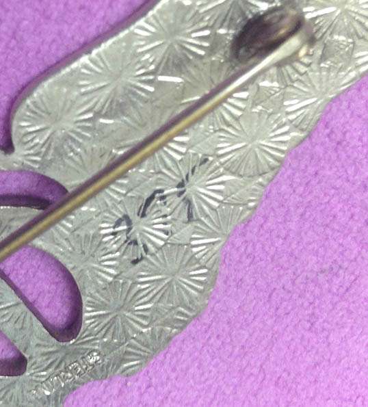

Well, there seems to be a "large", almost unprecedented increase in finding/posting of TO wings. I think prior to 2018, I can only recall about 2-3 TO wings being posted.

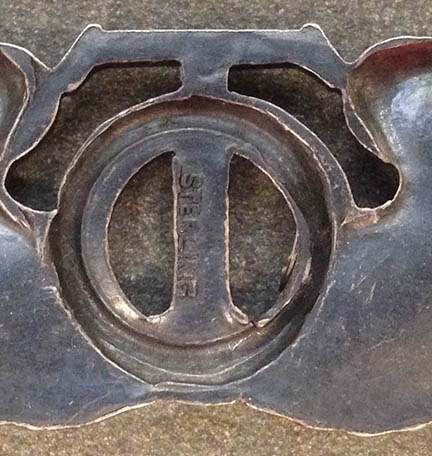

This week alone there have been a couple more posted, including this new one that I picked up.
It was an ebay find that had horrible pictures associated with it, but thanks to a tip from mghcal, I took a shot.

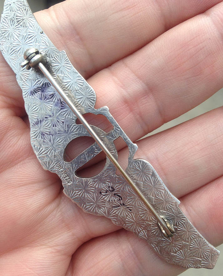

This is a snowflake backed wing marked "STERLING". It hard to get good pictures of the back, but the "snow flake-marks" on the back are very nice and crisp. This is very hard to accomplish when they cast a wing. The findings are identical to some of the other early AMCRAFT wings I have found.

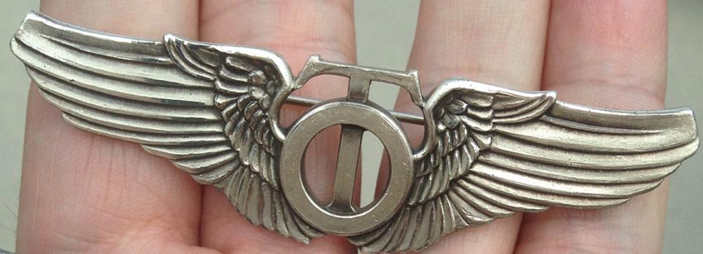

A touch more detail on the front.
and some of the back detail.
And a final picture of the back that is a tad clearer.

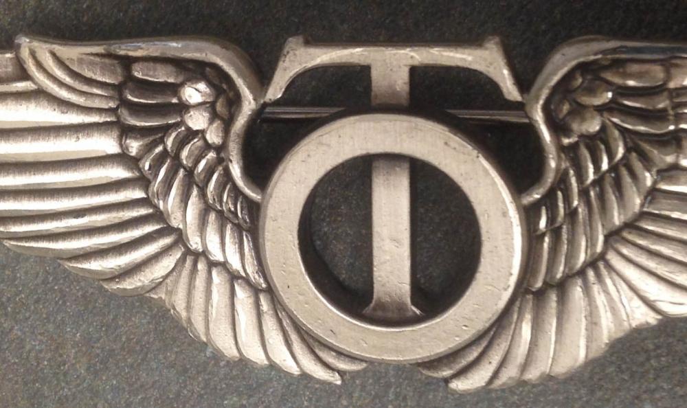

The two TO wings in my collection.
Patrick
