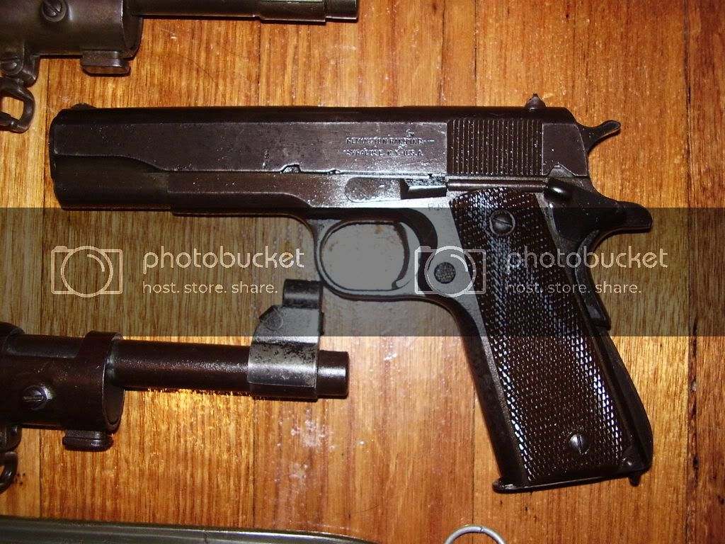

I have added to the collection since the pics were taken.
X
Very Impressive collection you got there MrX, I think all states differ in the legislation, Port Arthur massacre really did us all alot of harm here,
I just looked into our ACT legislation with collectors licences, the firearms have to be rendered safe here and thats fair enough, the thread has wandered of track, I can understand all aspects of the replys I am not having a poke at anyone the laws differ everywhere, peoples own preferences for what they do with the firearms is all good I respect all that, some firearms are shooters others look fine in a display or however the owner chooses to do things, theres no problem.
I guess I am trying to make the point that the Americans have it pretty good and I am jealous of that fact, I had to hand in my garand and my lovely M1 carbine my SKS and my Mini14 when the semi autos were banned with the doings of a certian individual who stuffed it up for us. Maybe I might get a greencard and go to America, always wanted a Mustang!
Whats that little .45 you got there? I want a S&W Victory for my display
