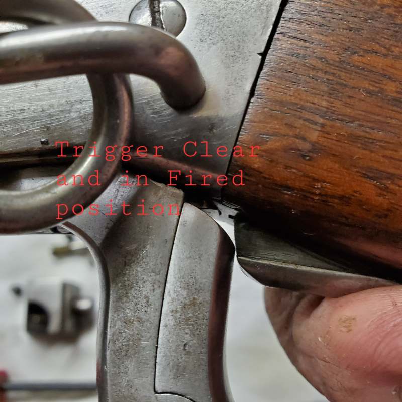

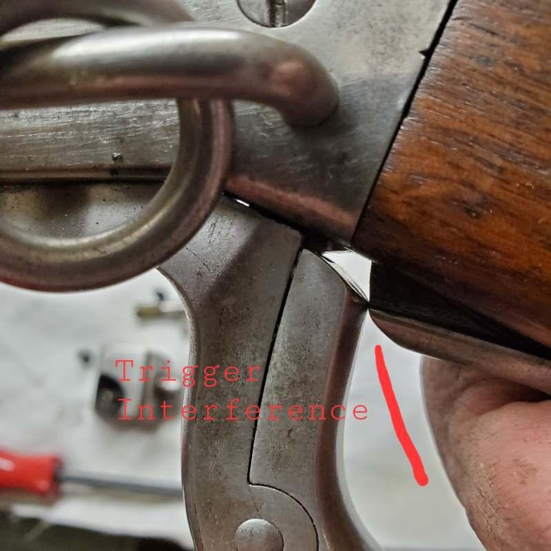

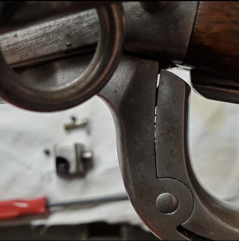

Gbro Posted November 23, 2022 Author #3 Posted November 23, 2022 Now the next issue is closing breech to full battery! There is a member that questioned the precision of a Burnside compared to the Spencer and would choose the Spencer. Of course some guns are worn out and everyone has their own taste but these Burnside Carbines are wonderfully built weapons from the 1860's!! If the latch attached to the Guard is .015 inch from closed the trigger is prohibited from moving to discharge this Carbine. Attached images show 1 latch not fully closed, 2 trigger interfaces with the latch and full battery with trigger pulled.

Gbro Posted November 23, 2022 Author #6 Posted November 23, 2022 2nd Image is Trigger not able to go to the fired position as the forward 1/2 is in contact with the latch.
Gbro Posted November 23, 2022 Author #7 Posted November 23, 2022 Now the next issue is closing breech to full battery! There is a member that questioned the precision of a Burnside compared to the Spencer and would choose the Spencer. Of course some guns are worn out and everyone has their own taste but these Burnside Carbines are wonderfully built weapons from the 1860's!! If the latch attached to the Guard is .015 inch from closed the trigger is prohibited from moving to discharge this Carbine. Attached images show 1 latch not fully closed, 2 trigger interfaces with the latch and full battery with trigger pulled.
Gbro Posted November 23, 2022 Author #8 Posted November 23, 2022 Now is this Not Precision!! Gbro, CGVS
