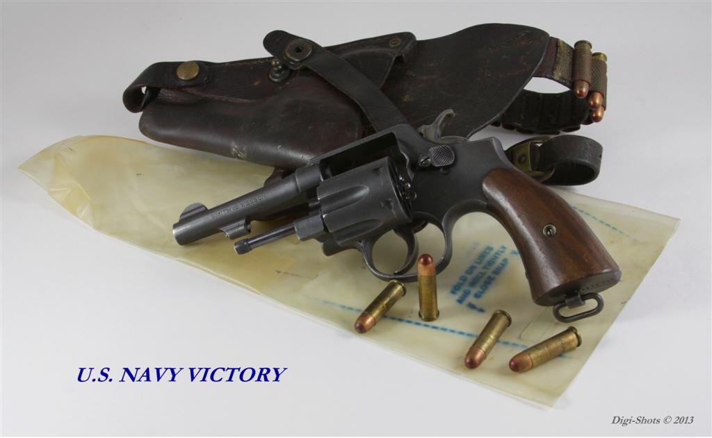

A little collage of accessories for the WWII .38 Special Smith & Wesson, a.k.a. Victory Model. Representation of eventual integration such as the shoulder holster, tracer and waterproof pistol cover. The M-1917 lanyard was a common accoutrement utilized with the .38.
VF-14, USS Wasp, August 1944.
Wow that is impressive, box is killer!

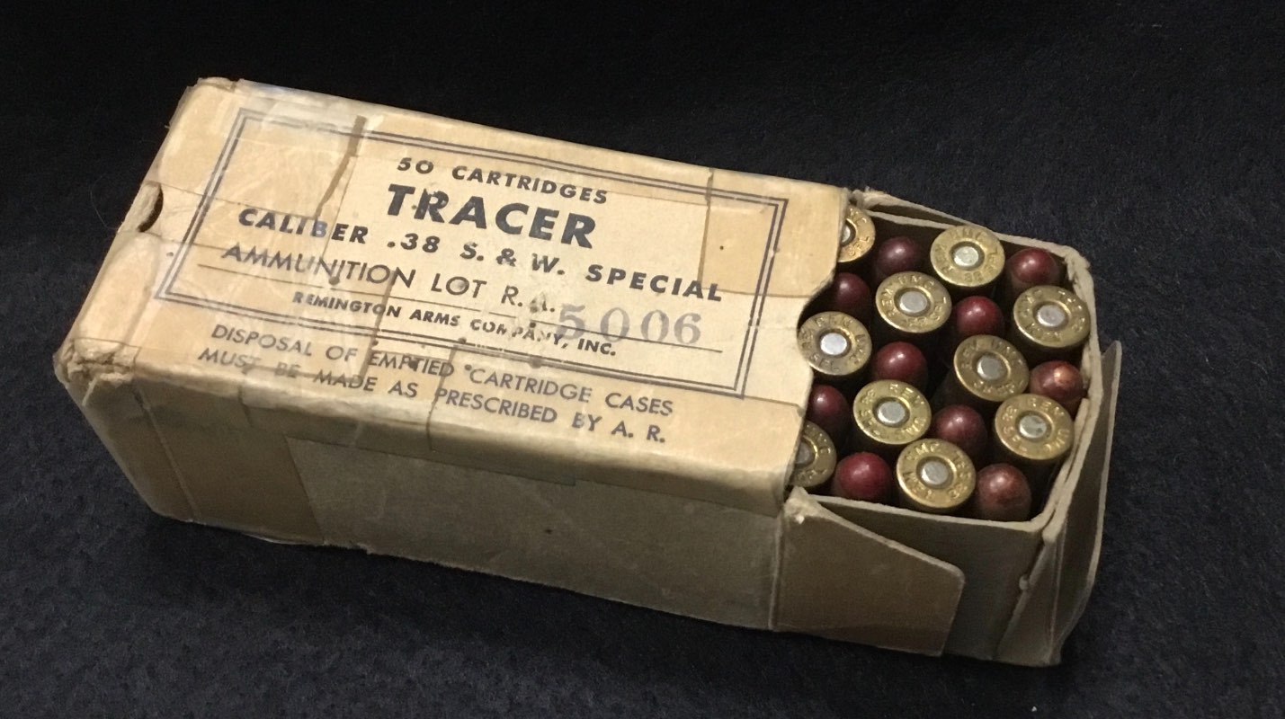

The box pattern in question from the original post, I have found Lot Numbers; 5006, 5008, 5011, 5013, 5015 and 5019.
The box pattern from the publication and your post, Lot Numbers observed: 5022, 5023, 5024, 5027 and 5028.
Right out of the gate we see a pattern, and according to those Lot Numbers somewhere around 5020 the box type changed. One question, are there duplicate Lot Numbers on both types of boxes? If not, what we have here are variations in cartons used in WWII production. Also it makes sense that the second carton posted is the later produced type and is a closer relative to those from the post era.

The tracer round box I have is off-white/light tan, RA lot 5006 - with no notation of grain.

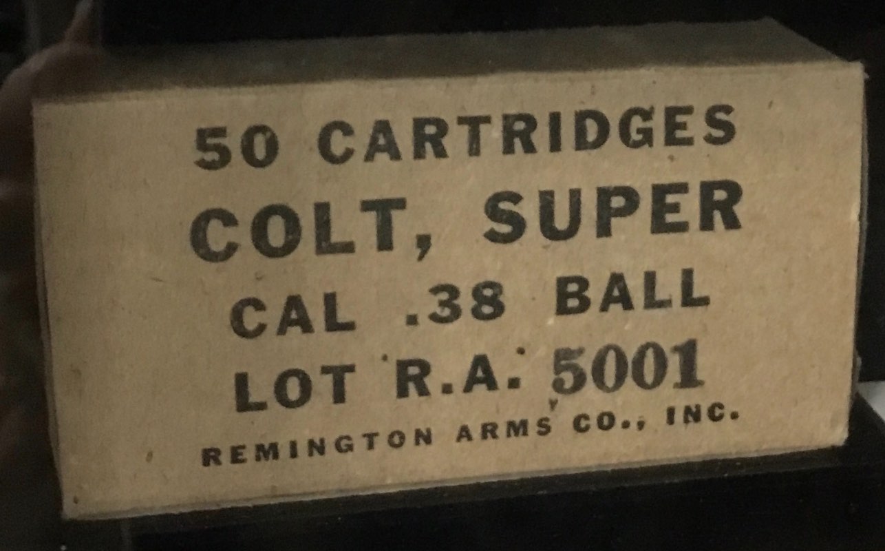

Here’s another box to compare...  headstamp is REM-UMC 38 ACP
What's the Colt, Super all about? Rather background to that specific box?
According to Jim Frigiola's excellent article, "The 38 Special in U.S. Service," this box was the only tracer load used during WWII.  I hope our moderator, Prof. Flick, weighs in as he knows a lot more about this stuff than I do.

I love these kind of discussions.  Thanks for the compliment but I am afraid I will have to disappoint you.  I don't know to a certainty which box was first.  I have a (revised) best guess opinion which I will state below, but I don't really know.  Indeed, I don't know of anyone else who knows to a certainty and has supporting evidence.
I should also disclose that I have been on record as stating my opinion that the ammo box with the "black outline" on the label, as shown in Dustin's first post above, is the later box.  I am going to recede from that opinion.  See the 2019 discussion on this same subject that came up on the CMP Forum.    https://forums.thecmp.org/showthread.php?t=256904  The question there was posed by GAP (a member here) and was commented upon by me and by Silverplate (another valued member here whose opinions I respect.)
My opinion now is that the "black outline" box was the first .38 Special Tracer box used in WW2.   However, I believe that the other box shown by Kevin was also used in WW2 and replaced the first box.  My reasons for so stating follow in no particular order.  I freely acknowledge that I have no contemporary documentation to support or contradict this opinion.  It is purely circumstantial evidence and what I think are reasonable deductions therefrom.
Remington was assigned to use Lot numbers for small arms ammunition in WW2 beginning at 5000.  The assigned numbers ran up to 5999 and that practice continued post-war.  As Dustin points out the "black outline" boxes that have been observed all have Lot numbers between 5000 and 5019.   All Lot numbers observed for the second box (I'll call it Kevin's box just for clarity's sake here) are above 5020.  I have checked the multiple boxes of both types in my collection and they are consistent with that observation.  I have run an online search and found that the boxes observed are consistent with this pattern.  I have searched the Journals of the International Ammunition Association back to the 1970s but have seen nothing that contradicts that pattern.  I now conclude that for whatever reason the black outline box was discontinued and was superseded by Kevin's box, probably in 1945.
The black outline box contains the legend "Disposal of Emptied Cartridge Cases Must Be Made As Prescribed by A.R." [Army Regulations.]  Kevin's box dispenses with that legend.  That reference to Army Regulations is a relic of the pre-war practice of collecting spent cartridge cases, cleaning them with a soda compound and recycling them for reloading purposes.  That label reference was found on .45 ACP M1911 ammo boxes as well as other calibers.  The practice of expended case recycling for reloading was dispensed with by the start of the War but the printed legend lived on, although its use declined during the War.  However, I have seen .30 caliber ammo boxes with similar legends printed on them with ammo that was produced as late as 1953.

Digi-Shots (Linda) posted an image of the .38 Super box produced by Remington in WW2.  That ammo were made for use in the 400 or so Colt M1911A1-style pistols that were procured for the OSS.  A mistake in the order led to a huge quantity of that ammo being produced, far in excess of the amount needed to the tiny quantity of pistols procured.  That ammunition is undated as well, but HWS reports that it was produced in 1945 at or about the same time pistols were procured.  That is significant only in the sense that the nearly identical style of box was used for both the .38 Super and the .38 Special Tracer as illustrated by Kevin's box. I see that as some evidence that those two boxes were in use by Remington at the same time, ie, 1945.
Sorry for this longwinded exposition but I thought it best to explain my revised reasoning.  I now conclude that both styles of box were WW2 production with the "black outline" box being first and superseded by Kevin's box.  Frankly, the evidence either way is tissue thin.  Nonetheless, I now see the greater weight of the evidence as supporting my conclusion.    I would welcome input from other members, especially if any other evidence not cited here can be produced.  I find this to be a fascinating topic and thank Dustin for initiating this discussion and Kevin for his valuable insights.
