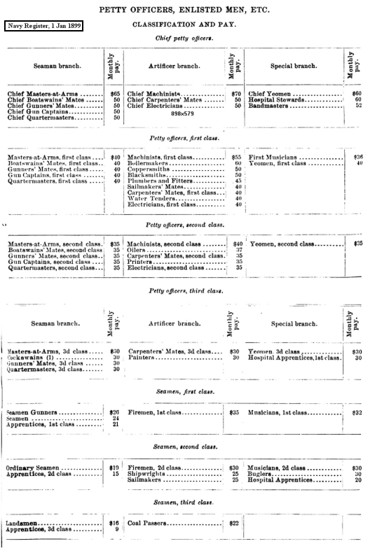

Here are two pay charts from the period in question. 1898:
And 1899. Most Navy Registers had pay tables at the back, which listed all enlisted rates until 1924 when they just went with pay grade.
