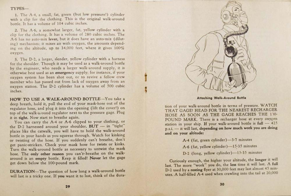

Does anyone have any information/pictures etc...
Air Forces Manual No. 35, Notes on the Use of Oxygen Equipment for Air Crews, with Special Reference to the B-17, B-24, B-25 and B-26. War Department, Headquarters Army Air Forces, August 1944
